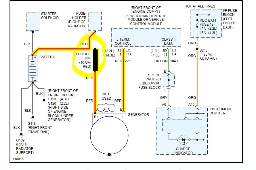

Does the positive battery cable attach to your alternator or starter?
Jun 24, 2019 at 12:13 PM
CERTIFIED EXPERT
52,796 POSTS
Good afternoon,
Yes, there is a battery wire from the battery to the back of the alternator.
I will attach a wiring diagram for you to view. Check the alternator for power on any other wires.
