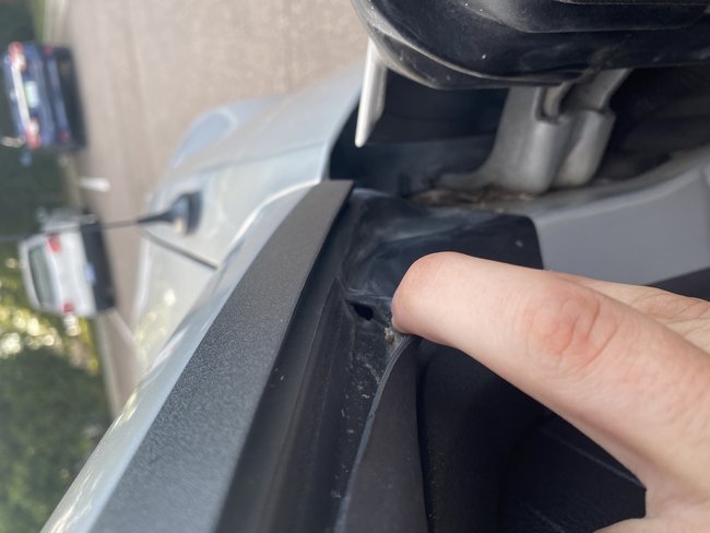

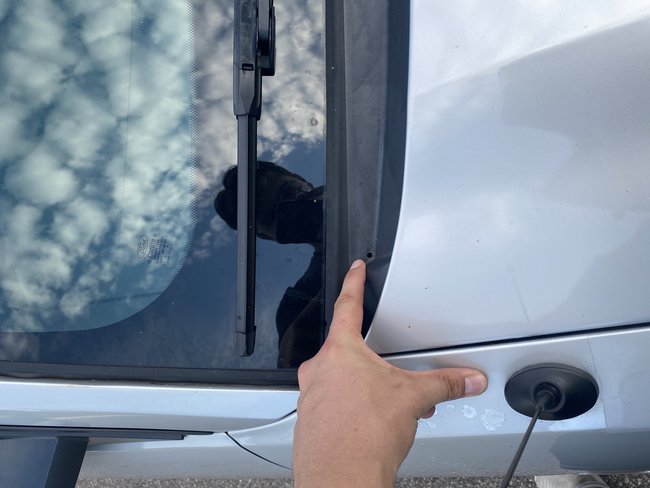

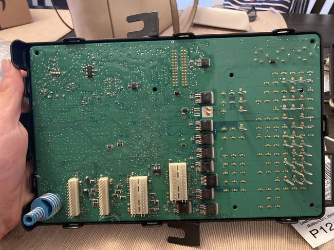

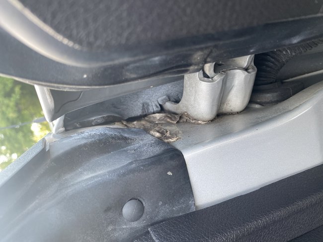

Does 07-09 SJB work on the car listed above?v So my car starting acting really crazy after owning it for about a week. Today the blinker on the left side turned on even though I didn’t turn it on and stayed on no matter what I did right after that I noticed lights on my dash and my windows wouldn’t roll up. So I immediately assumed the alternator had gone and turned the car around and drove home. When I turned off the car it wouldn’t lock with the remote and the blinker was still on and blinking even though the key was out. I grabbed the voltmeter checked the car it was at 12 I started the car it was running at 14.0 so I assumed the alternator was fine. I disconnected the battery and cleaned the terminals and the battery itself. Plugged it back in started the car it was fine.everything worked again. A couple hours later I decided to check on it and the key-less entry wouldn’t work and I had to unlock it with the actual key I use to start it, reminder mine is the one with a key and a separate fob. This time when I turned it on the brights were on and wouldn’t turn off but the actual lights in front of the car were off. So I did some research and found out about the smart junction box and I’m thinking this might be the issue just curious on what you guys think and I’m planning to buy a used one but it seems the way it’s listed the 05-06 are interchangeable but they don’t work with the 07-09. Not sure if this is true or not I could use some feedback as I can’t find the correct part number. Any feedback would be appreciated I’m going to look into it much further for sure.
