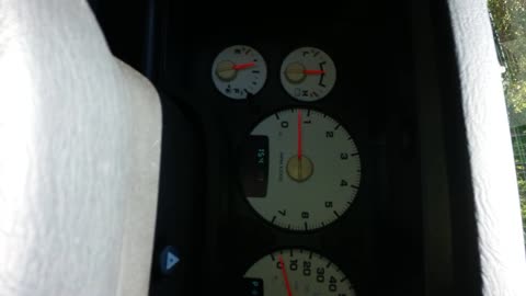

The AC shouldn't effect the engine running. to me it sounds like the throttle actuator is dirty here is a guide to help fix it
Can you please shoot a quick video with your phone so we can see what's going on, that would be great. You can upload it here with your response.
Aug 8, 2019 at 10:35 AM

Yeah sure. Thanks for the response

I drove it all day today and it didn't act up one time. So strange
Aug 8, 2019 at 7:56 PM
Thanks for the video. We should run the codes also does it have the catalytic converter still on it? Sounds like you have an exhaust system maybe?
Lets do this guide next.
