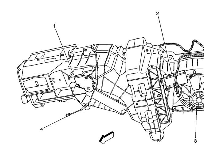

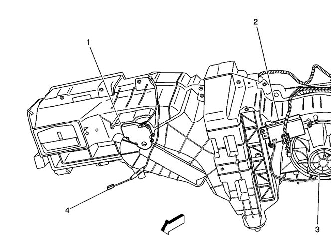

check for proper tstat install. then check the actuators in your heater i'll send a generic pic along

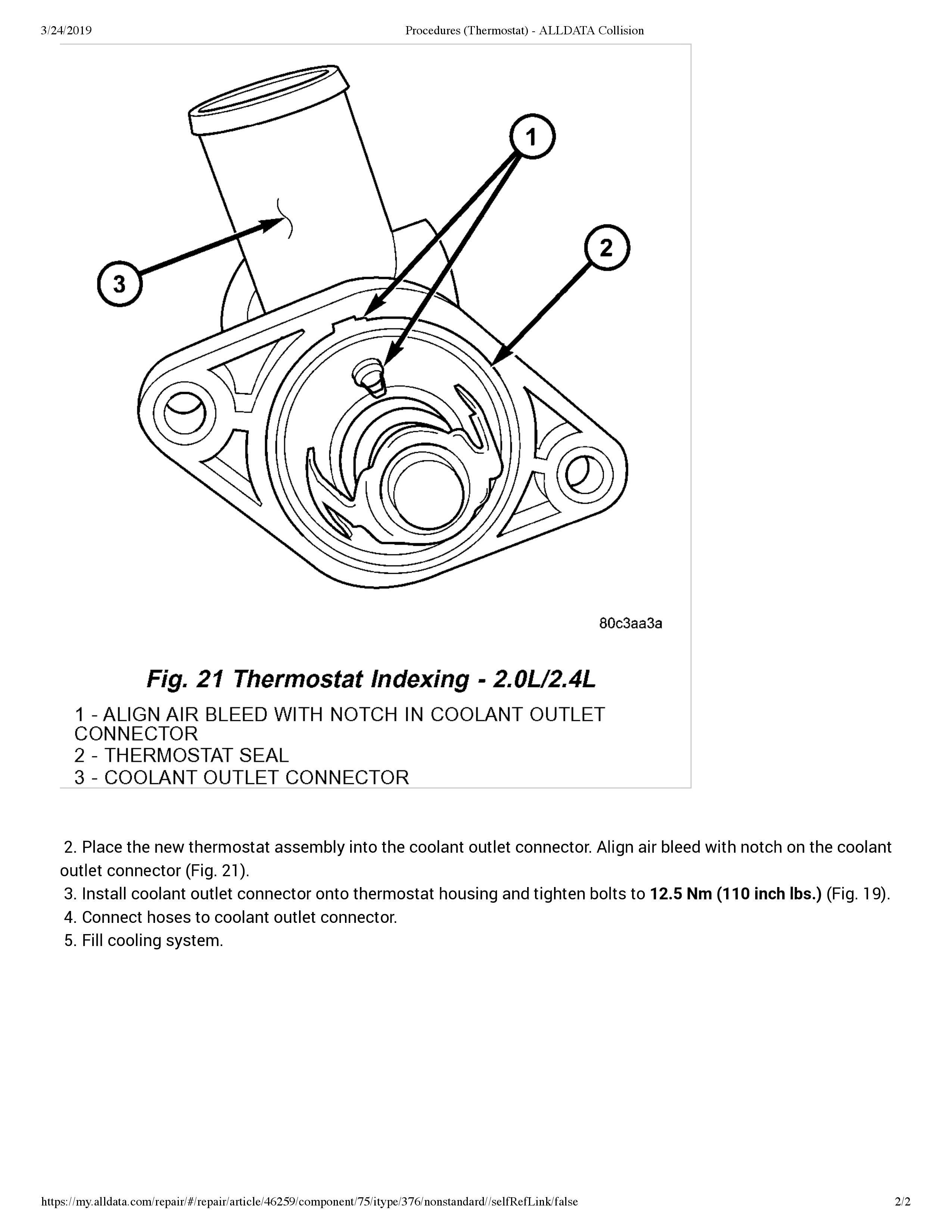

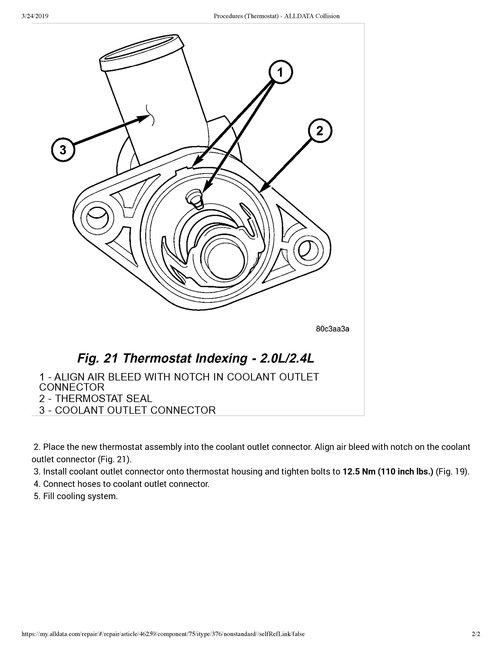

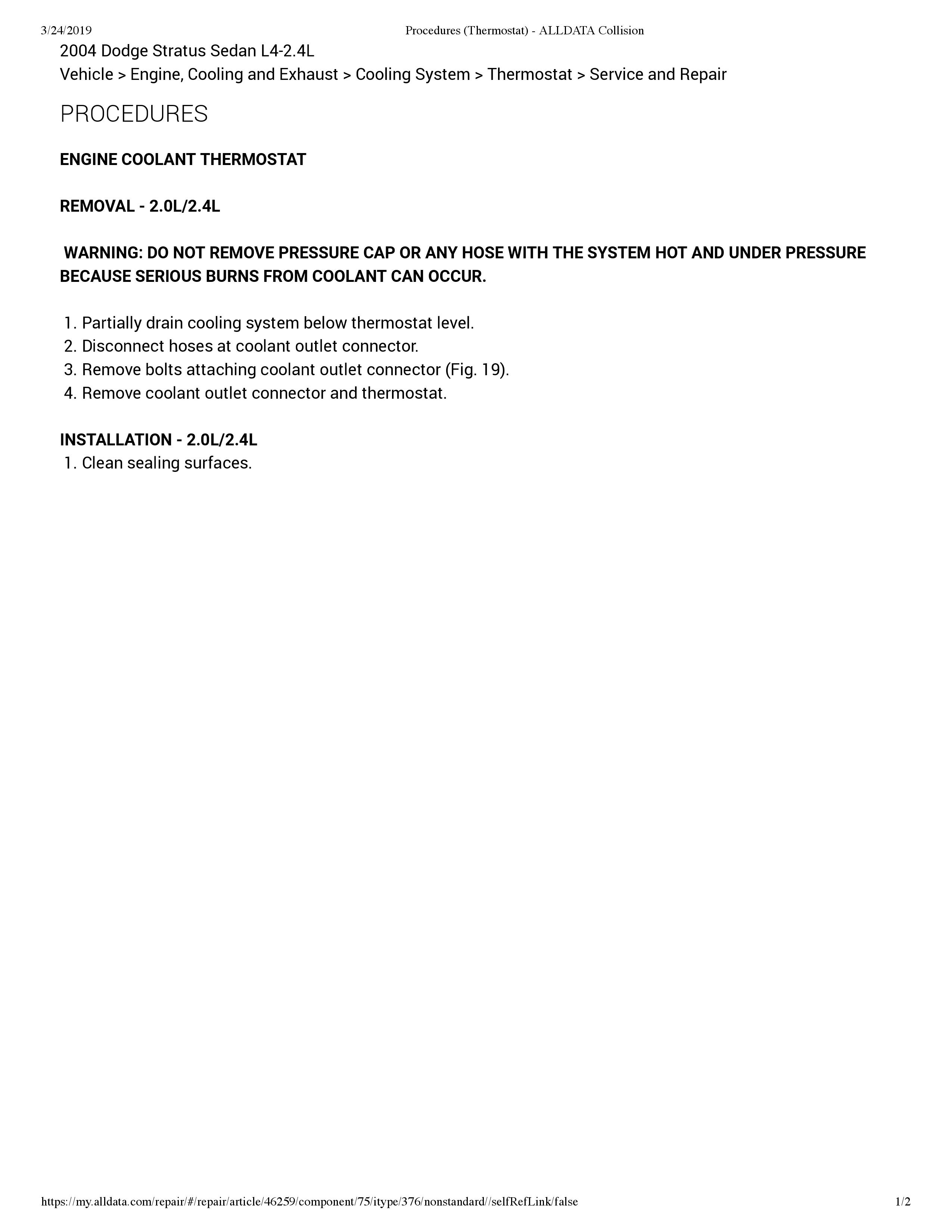

JOETECHPRO
  • 705 POSTS
Hey GAIL CRISP DALTON,
Please see the instructions below on thermostat replacement for your vehicle.
You should be able to see orientation from the picture in the instructions.
Any further questions do not hesitate to ask.
Regards, Joe

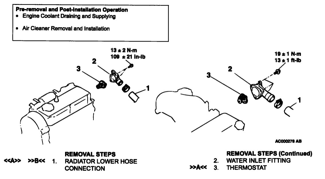

TNW626
where is the thermostat located for a 2001 dodge stratus se v6
Oct 27, 2020 at 10:04 AM (Merged)
The thermostat is located on the lower left near the front. It is on the inlet side of the waterpump. I have attached a picture for you. As far as bleeding the system after the job is done, it has an air bleed on the flange of the thermostat to allow trapped air to exit when refilling.
TNW626
lower left standing in front facing the engine?
Yes, from the front. You will see a large radiator hose going to it and a smaller hose (for the heater core).
I'm glad you emailed back. I reviewed our posts. I wanted to mention to you to make sure the bleeder on the t-stat flange needs to be in the 12 o'clock position.
