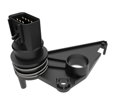

Typically, with a bad neutral safety switch when you turn the key it will not do anything, no noise.
Here is a helpful guide:
https://www.2carpros.com/articles/how-a-neutral-safety-switch-works

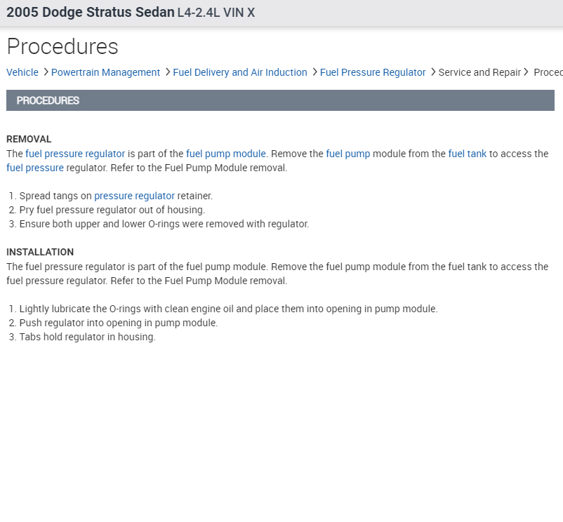

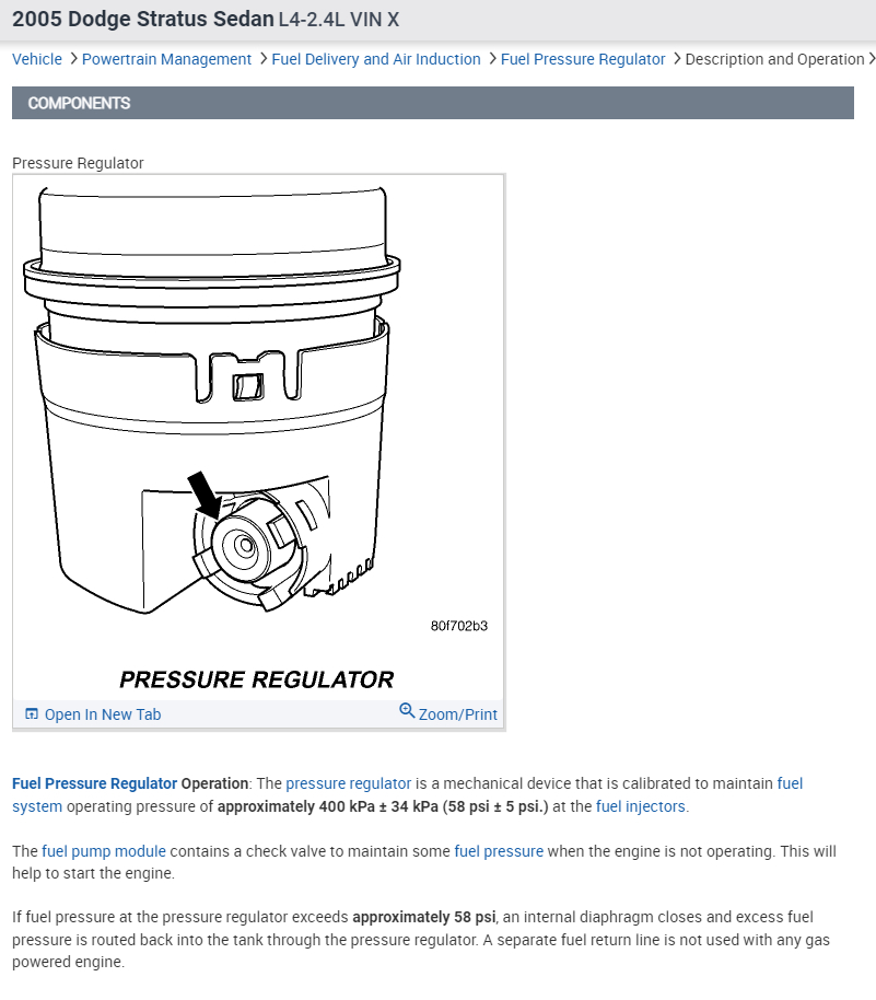

When the key gets turned to the on position does the fuel pump come on? A vehicle can have inadequate fuel pressure due to a bad fuel pressure regulator.
Checking the fuel pressure can narrow down the possible issue. This vehicle should have 58 PSI (+/- 5 PSI) of fuel pressure.
