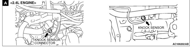

I need to know the location of the knock sensor and the what size wrench I need to replace it. On a 2004 2.4l four cylinder Dodge stratus?
Oct 15, 2010 at 6:09 PM

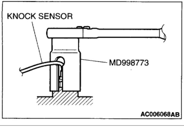

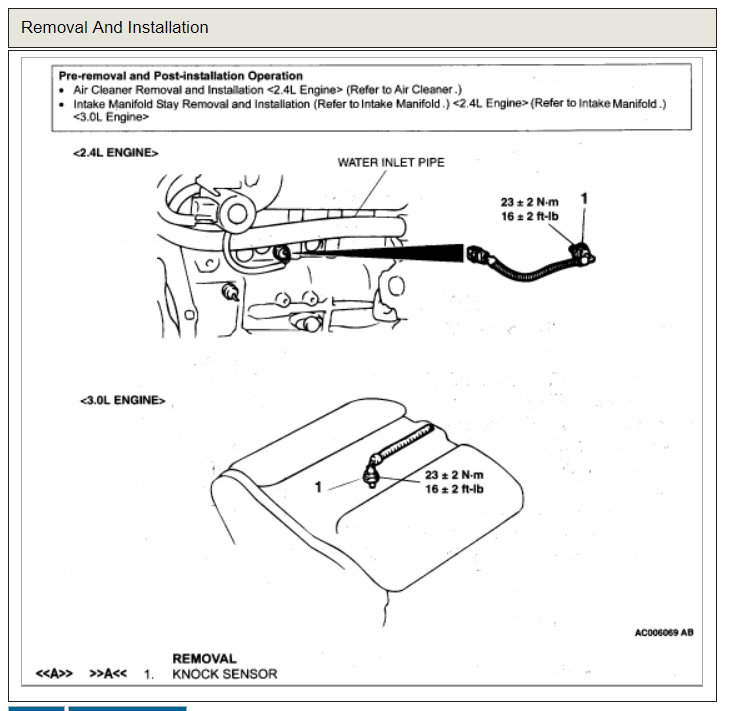

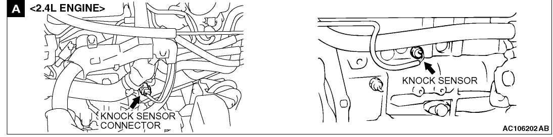

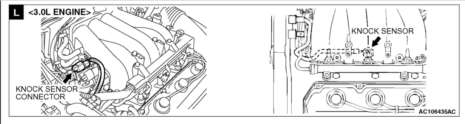

the knock sensor is located on the side of the engine block under a water pipe. I have both knock sensor locations for each engine this car comes with becasue someone might need it. Check out the diagrams below.
Nov 29, 2017 at 4:35 PM

I replaced mine on my 96 stratus 4cy 2.4, it was leaking, you have to put front of car on ramps and I believe it is 1,1/16 socket, lie on your back with feet towards front, on that harness there is a plastic safety that has to come out, it is a pain to get out, I also put tape on the treads on new one, good luck, Declan.
