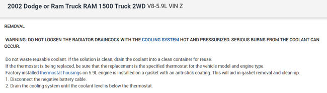

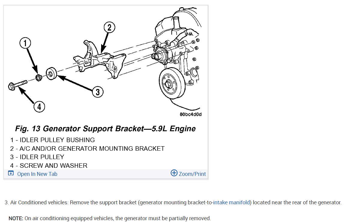

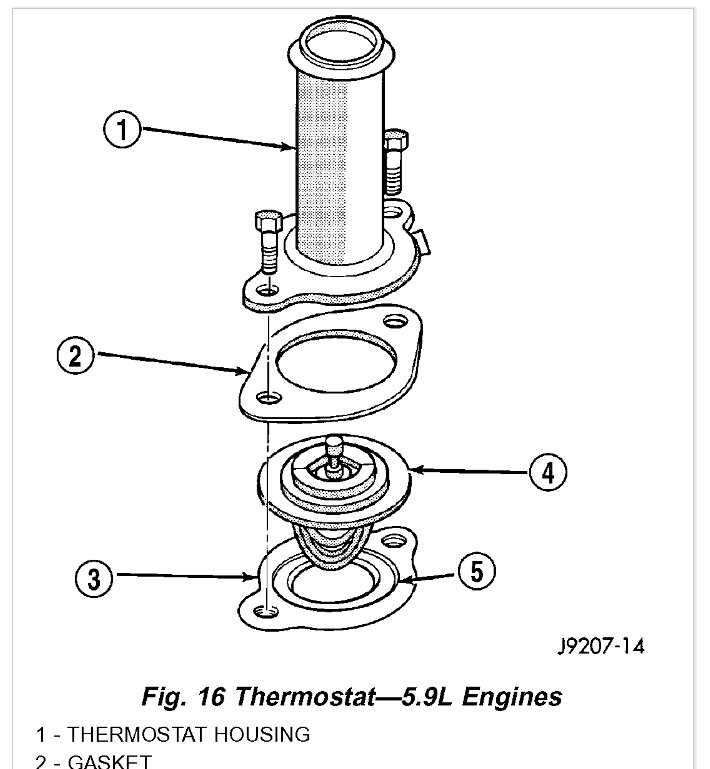

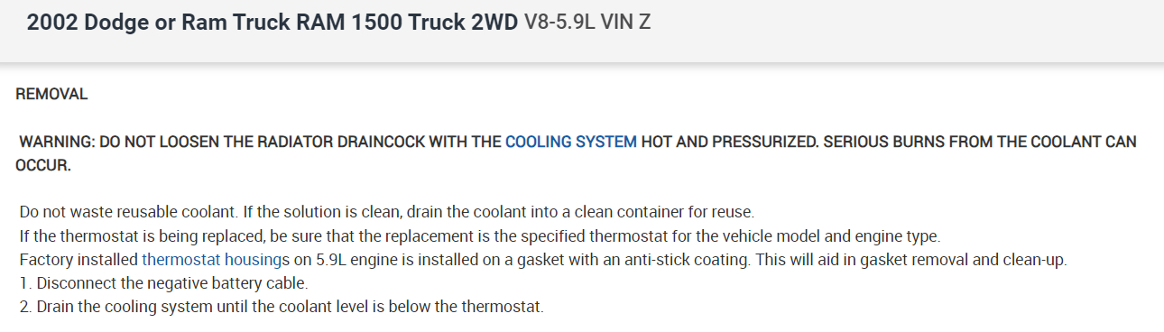

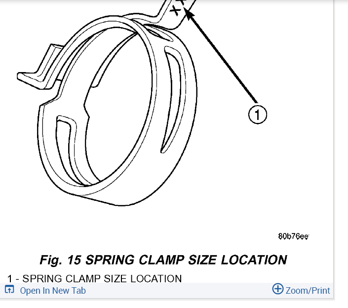

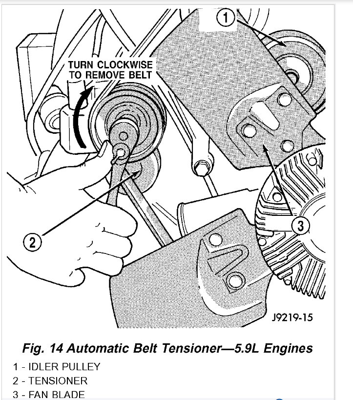

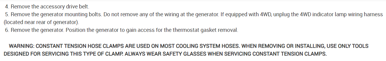

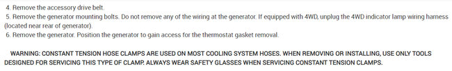

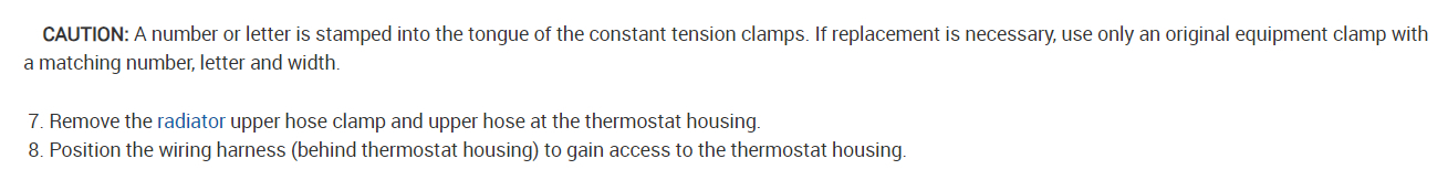

Yep I agree here is a guide to help us fix it and I have included how to change thermostat out as well in the images below.
https://www.2carpros.com/articles/car-heater-not-working
