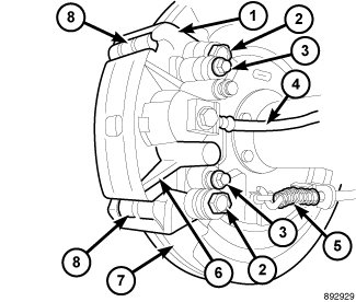

REAR
pic 1
Raise and support the vehicle (Refer to 04 - Vehicle Quick Reference/Hoisting - Standard Procedure) .
Remove the rear wheel and tire assemblies.

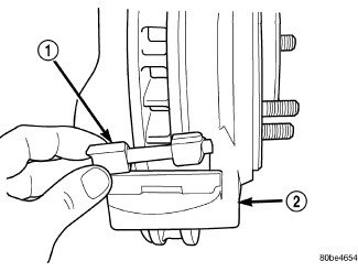

Compress the caliper.
Remove caliper slide bolts (3).

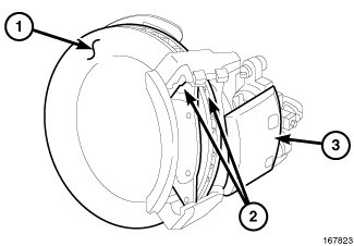

Pic 2
NOTE:
Do not allow brake hose to support caliper assembly.
Remove the caliper (3), by tilting the top out and off the caliper adapter.

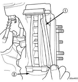

Pic 3
Remove inboard brake shoe (1) from the caliper adapter (2).

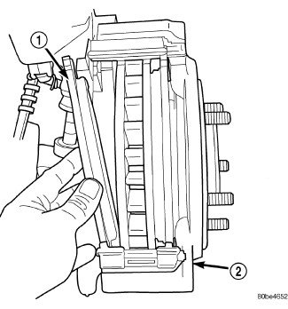

pic 4
Remove outboard brake shoe (1) from caliper adapter (2).

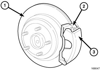

pic 5
NOTE:
Anti-rattle springs are not interchangeable.
Remove the top anti-rattle spring (2) from the caliper adapter (1).

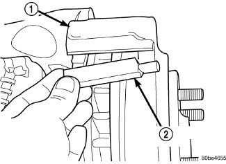

pic 6
Remove the bottom anti-rattle spring (1) from the caliper adapter (2).
