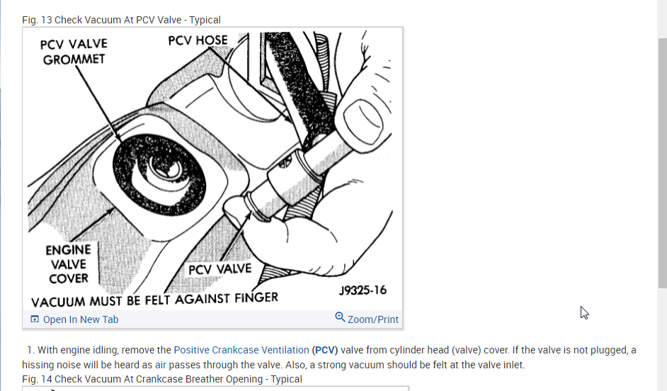

Starts rough idle put in drive give it gas it just sputters and wont move. Take the oil cap off and it is pulling sucking a lot of air in. just did a full tune up.
May 19, 2021 at 12:55 AM
Couple questions to start.
First, was this an issue before you did a full tune up? Next, does it move if you put in reverse or low gear range?
Last, when you pull the oil cap off and it is sucking air then that points to a restriction or issue in the PCV so let's start with this. Also, we are going to have to check for a vacuum leak.
I suspect you have two issues but we need to start with this info and go from there. Thanks
