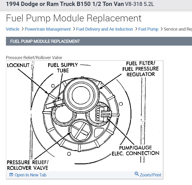

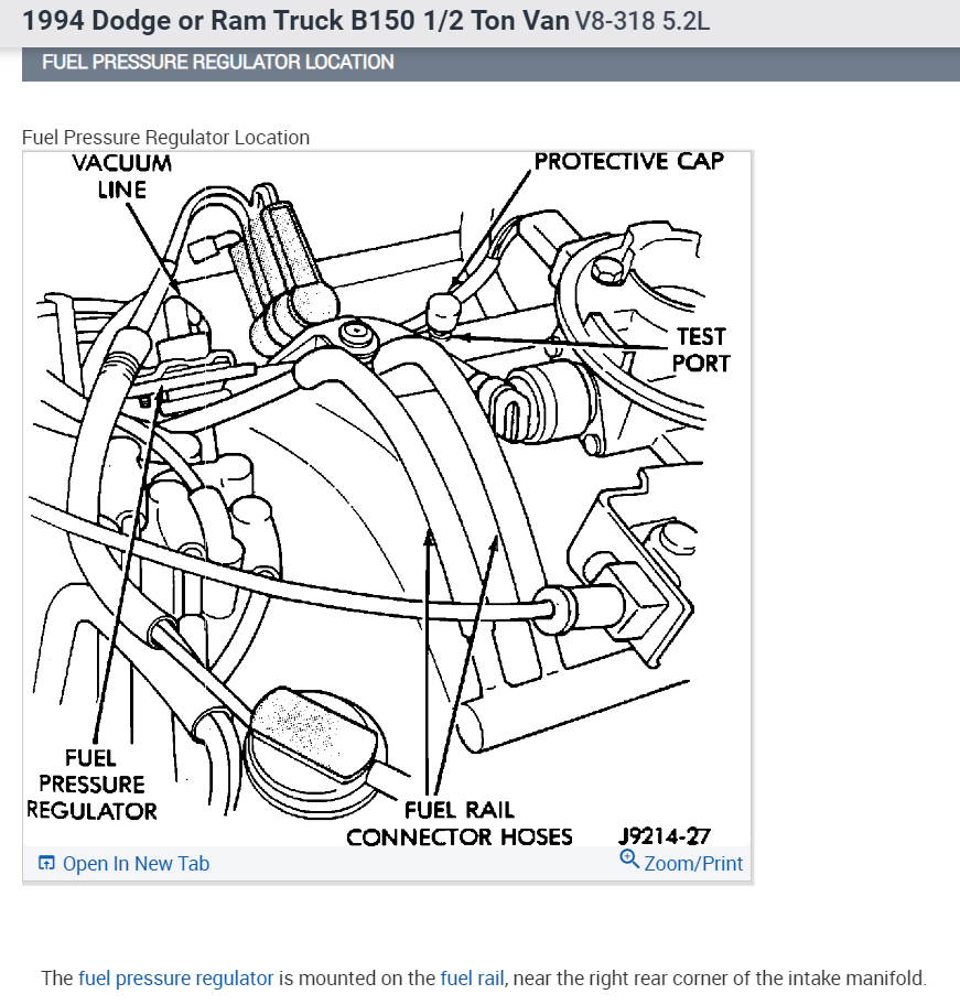

This sounds like the regulator could be bad or the fuel pump was of poor quality, which is more common. Here is the location of the pump which is inside the tank and regulator so you can check it out. Check out the diagrams (below). Let us know what happens and please upload pictures or videos of the problem.
