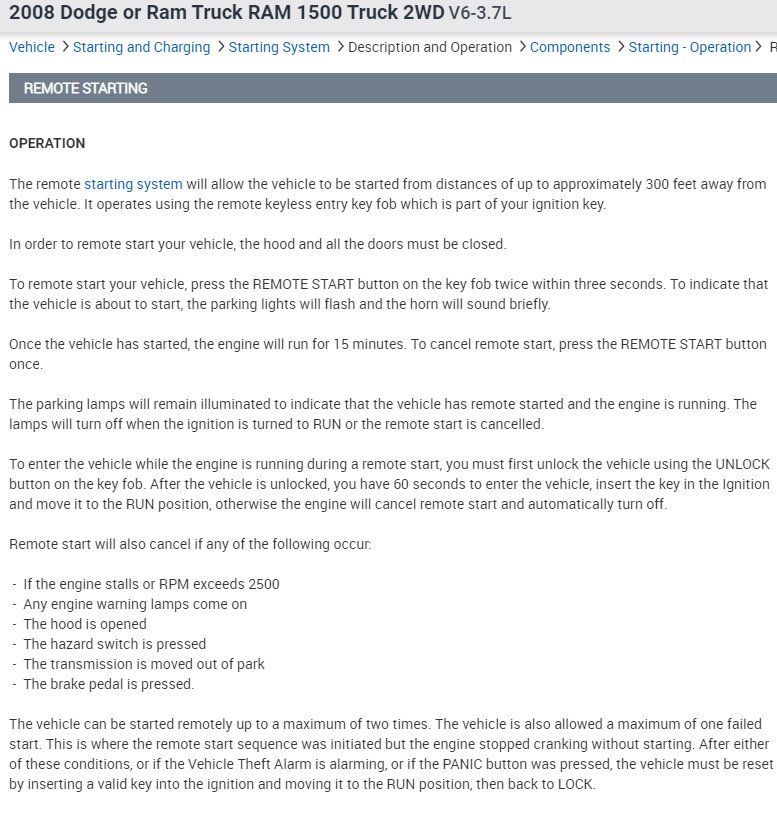

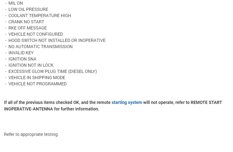

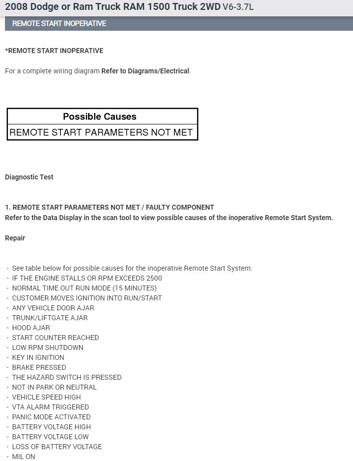

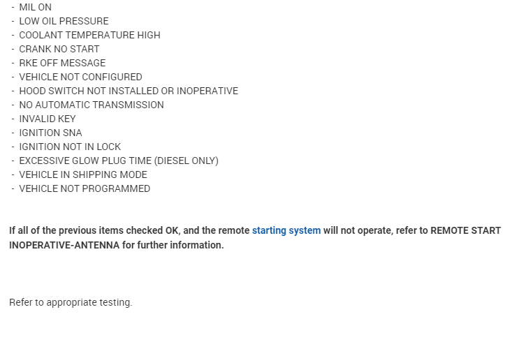

I have attached some helpful information and what are the typical culprits for inoperative remote start below.
