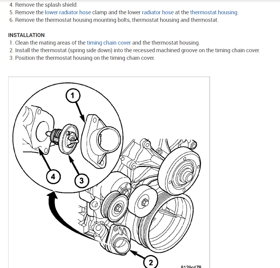

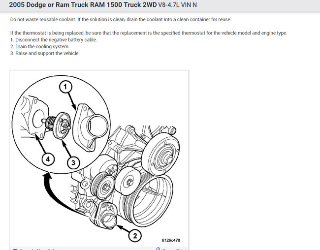

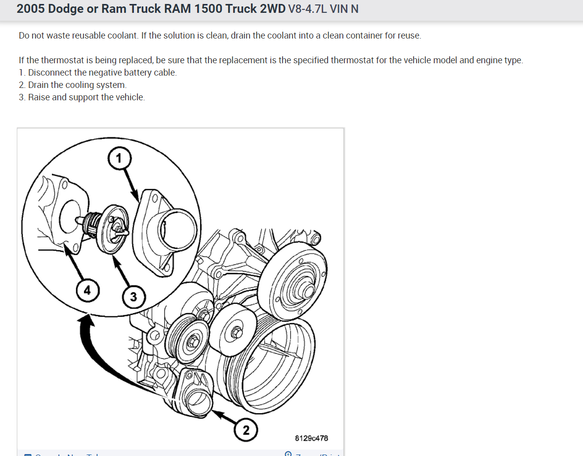

You should be able to find it by following the bottom radiator hose back towards the water pump. The thermostat is located inside the housing at the end of the hose. Here is a guide to help you step by step with instructions in the diagrams below to show you how on your car.
