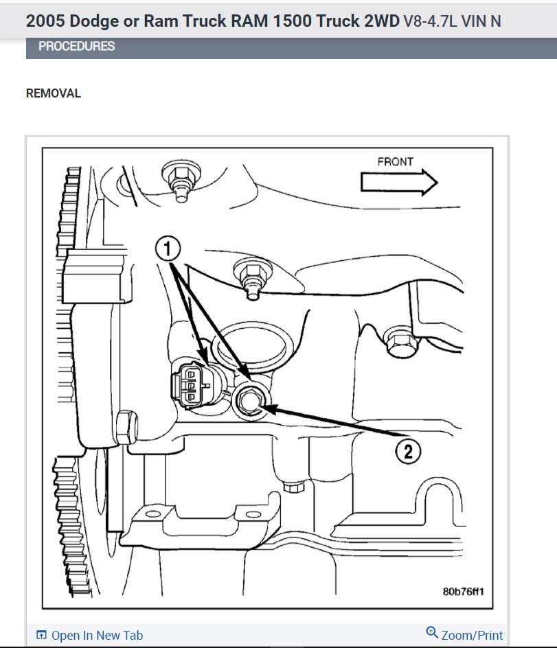

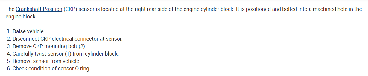

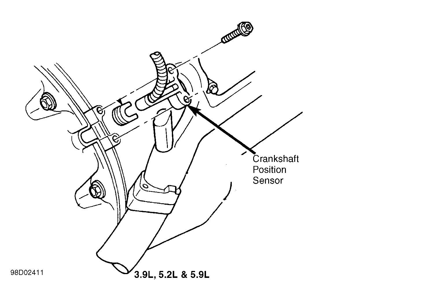

If the security light is not flashing it is probably the crankshaft angle sensor. Here are instructions for you and the sensor location in the diagrams below. Check out the diagrams (below). Please let us know what happens.

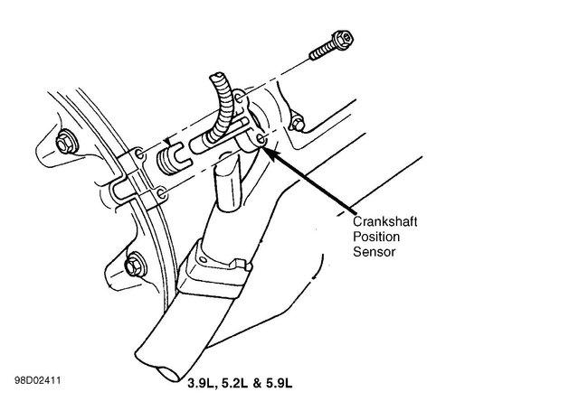

This drawing shows the location of the crankshaft position sensor. It is as would be seen from the front passenger seat. The camshaft position sensor is inside the distributor.
