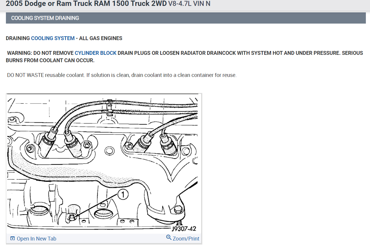

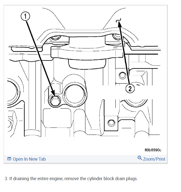

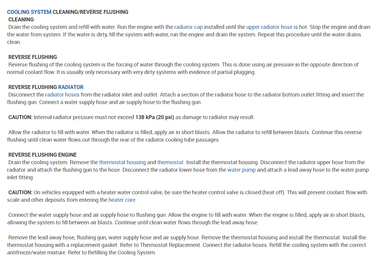

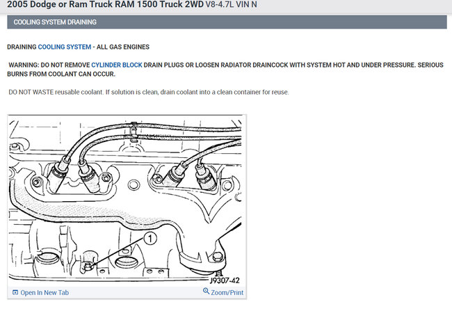

Here is a guide to help you step by step with instructions in the diagrams below to show you how on your car.
https://www.2carpros.com/articles/coolant-flush-and-refill-all-cars
