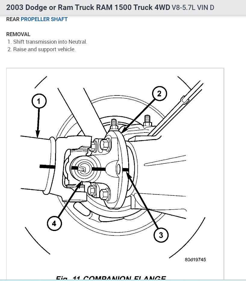

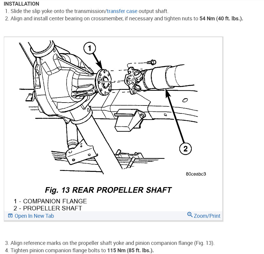

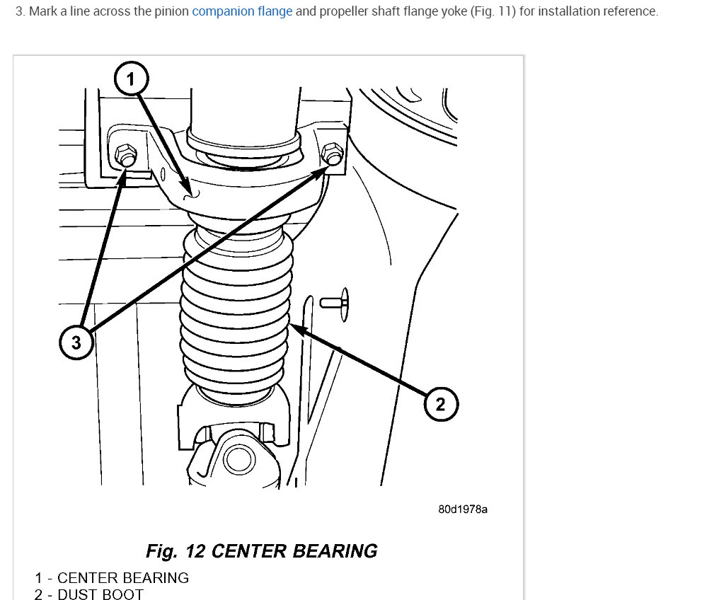

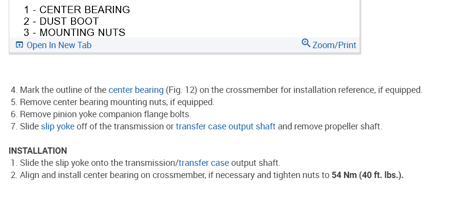

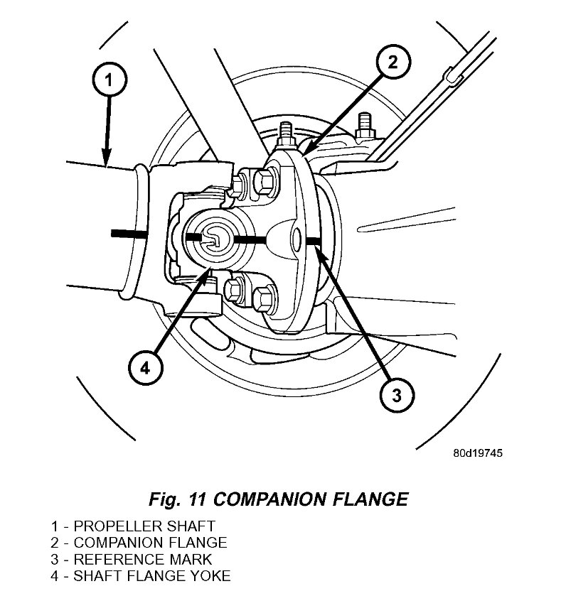

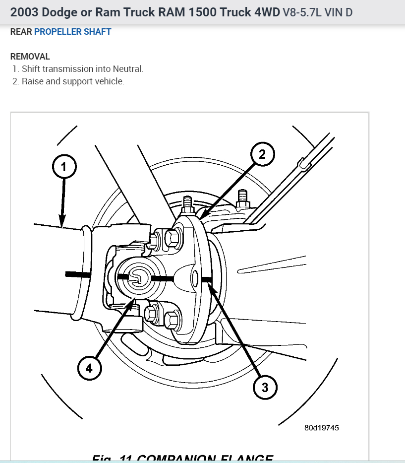

I would stop driving it because it sounds like the U joints are out and the driveshaft could come loose and cause damage. Use a flashlight to inspect the U joint and look for rust colored dust.
Here is how to remove the driveshaft in case you need to remove it to replace the U joints.

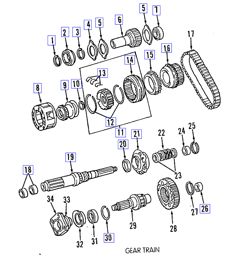

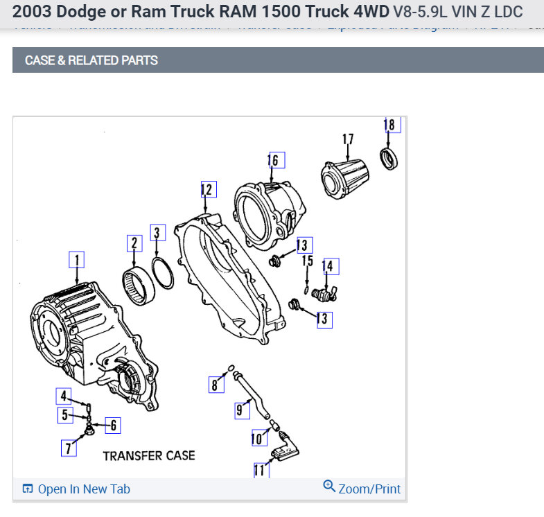

After further research I discovered the Front Driveshaft is wobbling where it enters the transfer case. It is the source of the "tick, tick" noise. All u joints are seemingly in good shape. Never removed this front shaft. looks as if the exhaust cross over pipe might restrict a smooth change out. Tell me about the nose shaft entering into the transfer case. Is there a seal? Manually twisting shaft results in a rattle at entrance to Transfer case.
Jul 16, 2023 at 11:51 AM
It sounds like the transfer case is having a problem or the U joint is locked up which it could still look good. I would remove the shaft and manually move the U joint to check the operation. If it is okay, then for sure the transmission case will need to come apart for inspection. Check out the images (below). Let us know what happens and please upload pictures or videos of the problem so we can see what's going on.
