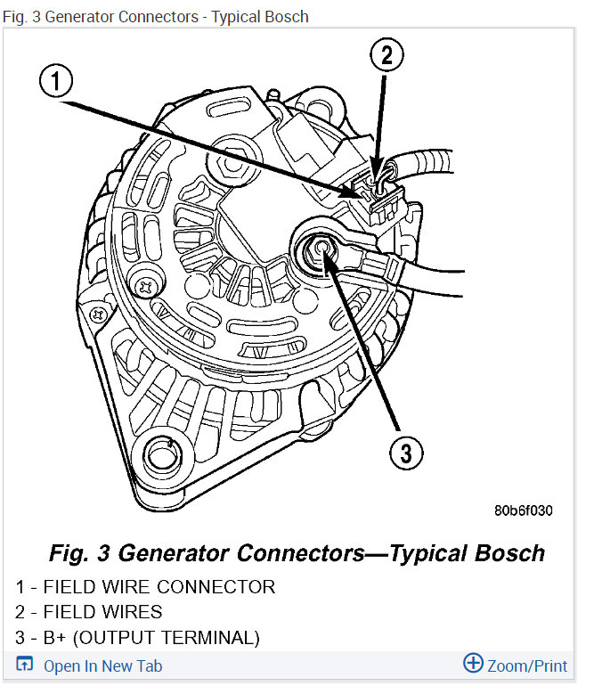

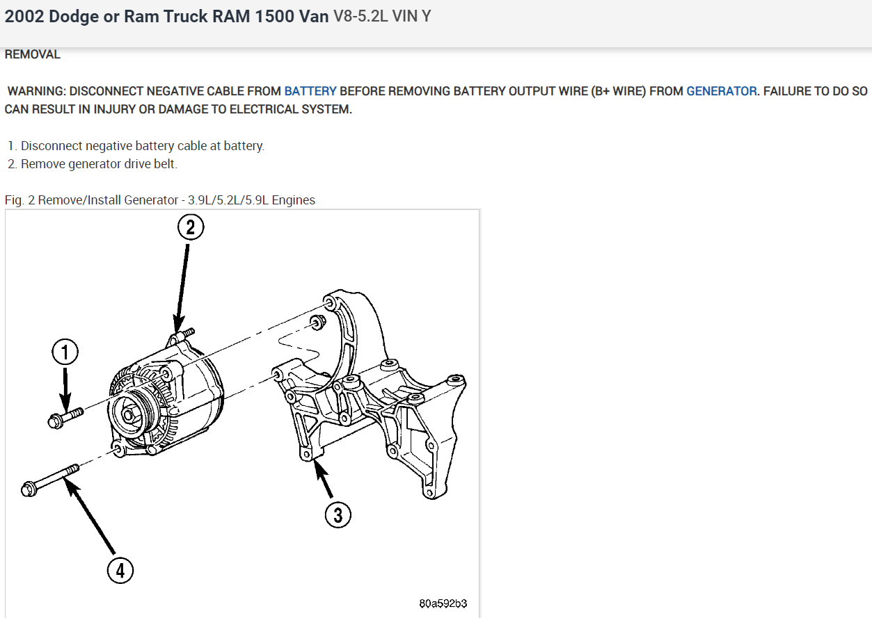

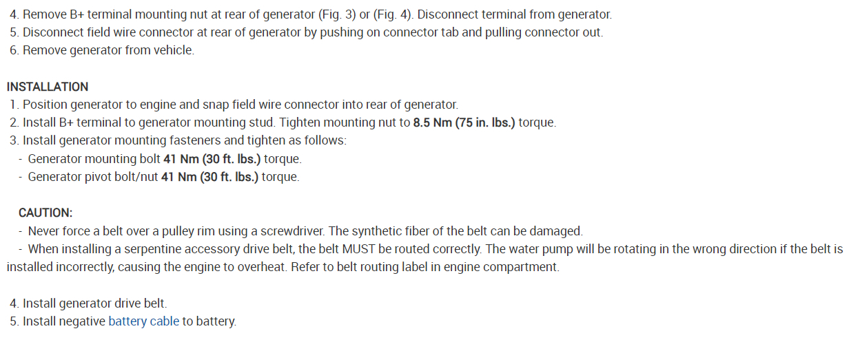

Have the alternator and the regulator tested. Sounds like a power surge to me also here is a guide so you can test them for yourself. When the engine is idling high about 2k RPM the voltage should not be over 14.5 volts
Here is how to change the alternator out. Check out the images (below). Let us know how it goes
