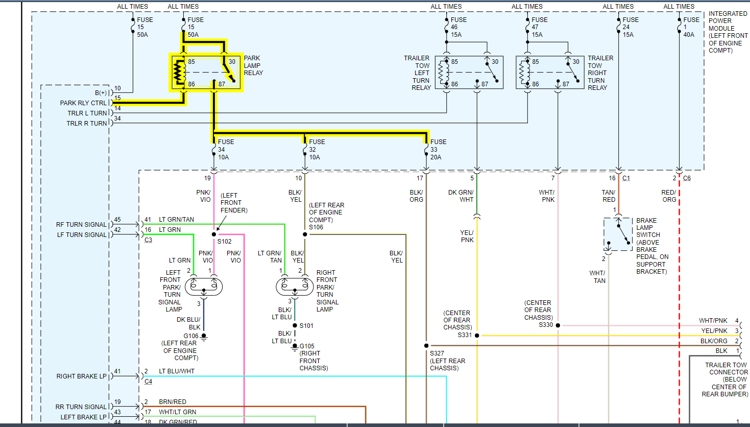

The tali lamps get voltage from the park lamps relay, located in the integrated power module. It's probably a long shot to suspect the relay, while possible. Ground for the coil side of relay is controlled by integrated power module. The integrated power module needs a request to ground the relay. The request would come from headlamp switch to instrument cluster, from there to the integrated power module. The problem could be anywhere along that circuit. A code might help locate.

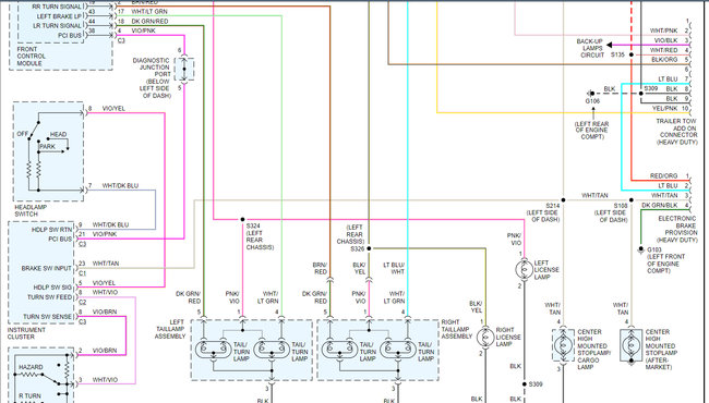

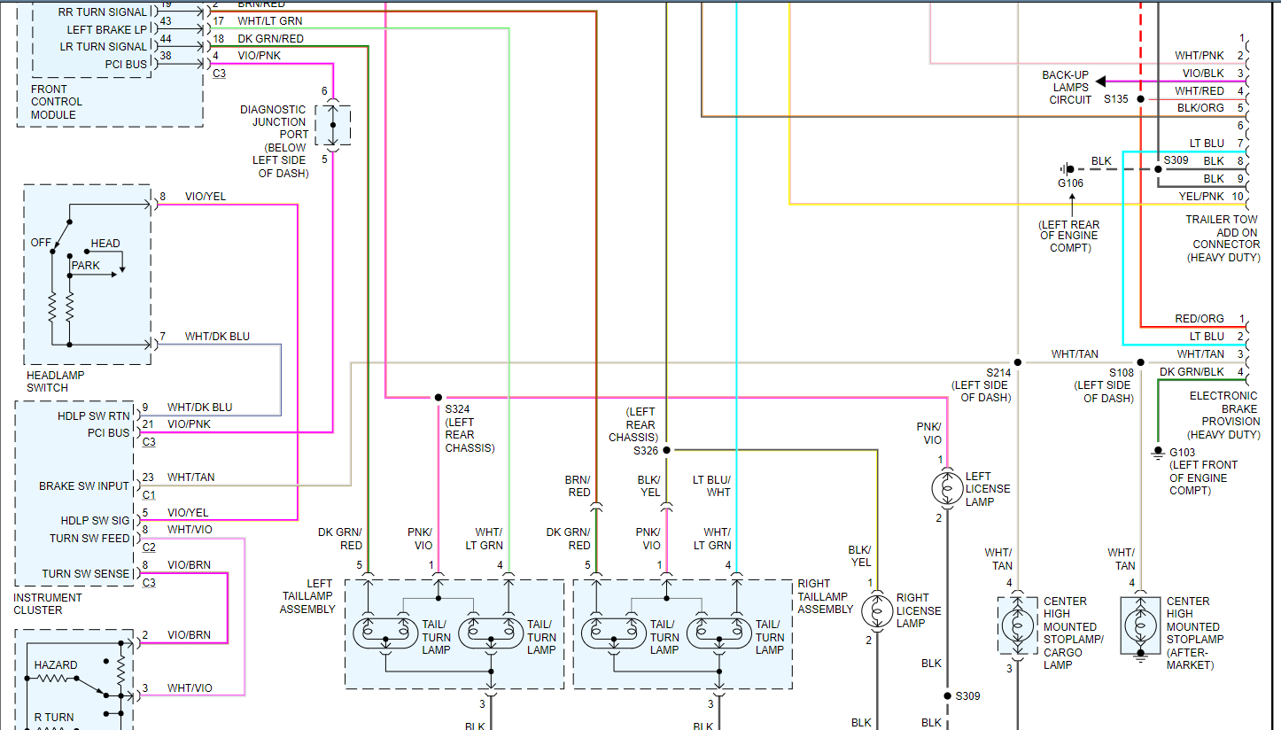

Good afternoon,
The pin 86 of the relay in the diagram I posted is the ground. The TIPM or the fuse block is what controls this ground based on the input from the switch.

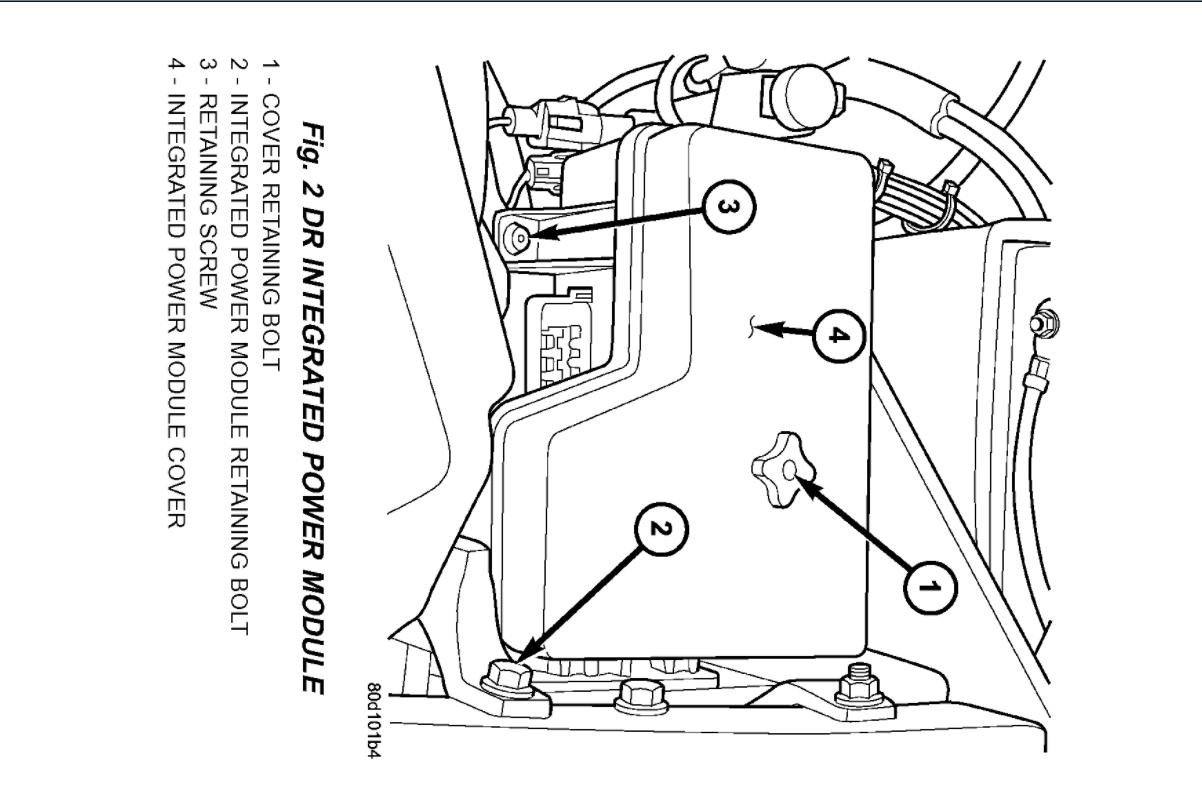

INTEGRATED POWER MODULE
REMOVAL
1. Disconnect the negative and positive battery cables.
2. Unsnap cover and remove the B+ terminal nut from the integrated power module B+ terminal. Remove the B+ cable from the integrated power module.
3. Disconnect the gray connector from the integrated power module.
Fig. 2 DR Integrated Power Module
4. Remove the integrated power module retaining bolt and screw (Fig. 2).

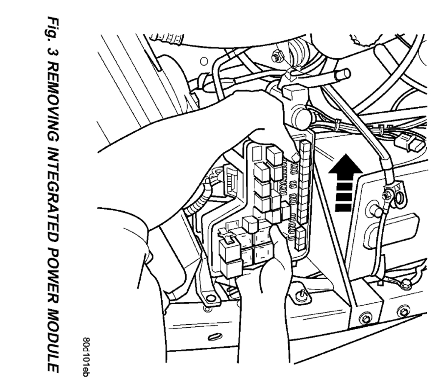

Fig. 3 Removing Integrated Power Module
5. Grasp the integrated power module with two hands and slide the assembly in the direction shown (Fig. 3) to free the module from its mounting bracket. Position the assembly upside down to access the electrical connectors located on the bottom of the unit.
6. Disconnect the electrical connectors by depressing the locking tab and rotating the connector arm outboard, until the connector is free from the module assembly. Be certain to pull the connectors straight off.

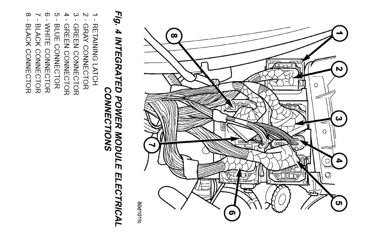

Fig. 4 Integrated Power Module Electrical Connections
NOTE: Integrated power module electrical connectors are color coded to ease location reference (Fig.4).
3. Connect the electrical connectors by pushing straight on and rotating the connector arm inboard, until the connector is firmly locked in place on the module assembly

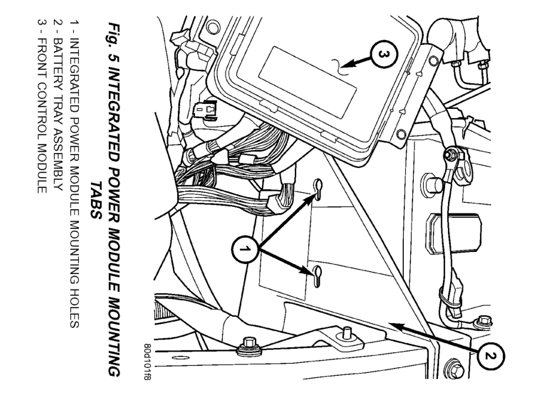

Fig. 5 Integrated Power Module Mounting Tabs
4. Grasp the integrated power module with two hands and install the assembly on the battery tray (Fig. 5).

when my headlights are on right rear taillamp flashes fast and backup lights come on when I hit the brakes. when headlights are off everything works fine

Just my opinion, it sounds like a faulty ground at the rear. A faulty ground can cause some weird things to happen.

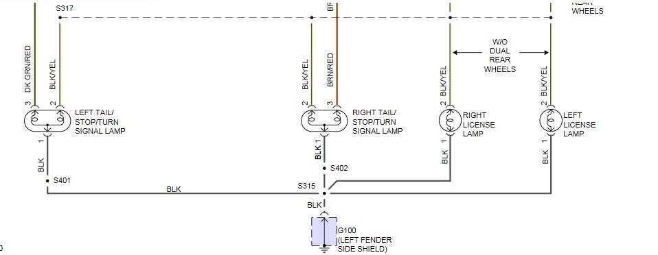

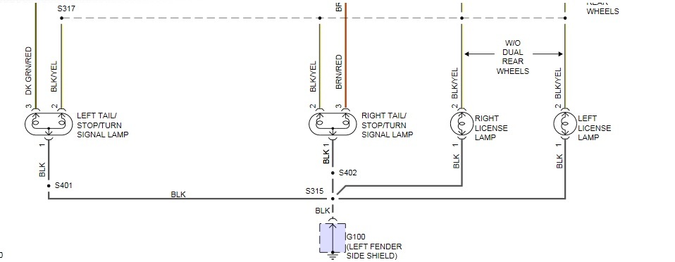

JDL
  • 16,098 POSTS
Just to add diagram. G100, black wire is ground. Check and clean the ground connection. Go from there.
