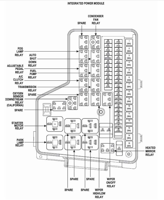

I have a 2002 dodge ram 1500 6cyl with 111000 miles. the horn and lower brake lights and wipers all stopped working at one time. the headlights stay on all the time with the key turned on. dash indicators for turn,hazzard all work but nothing outside.. Very confused.

Classic body control module...have it tested at Dodge...unless you know someone that can properly scan for it...
Dec 8, 2007 at 7:12 PM
Yep, the IPM (integrated power module) has gone bad, here is how to replace it which is easy to do because it self learns. Here is what it looks like. Check out the images (below). Let us know if you need anything else.
