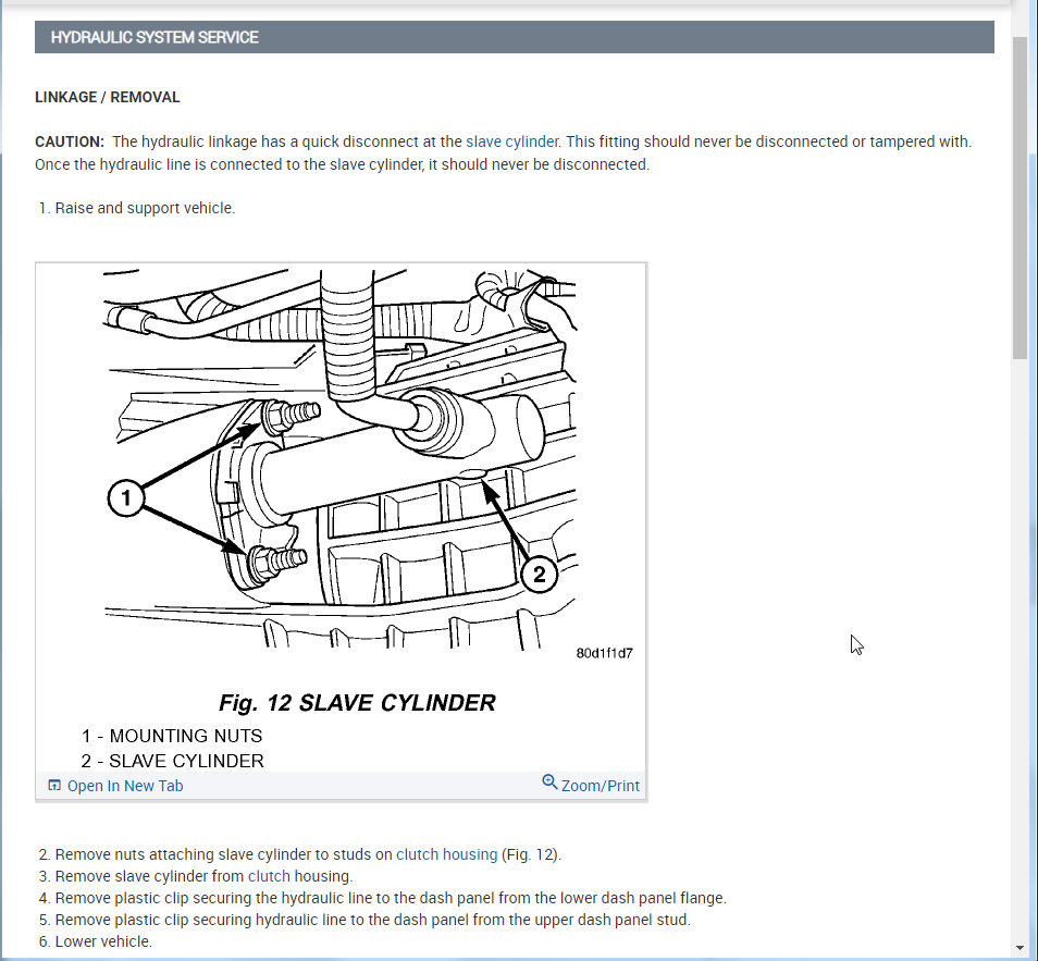

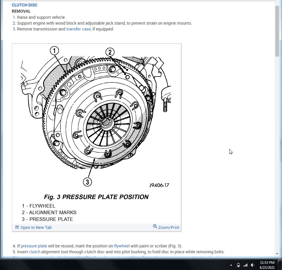

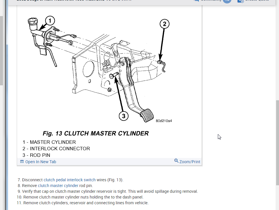

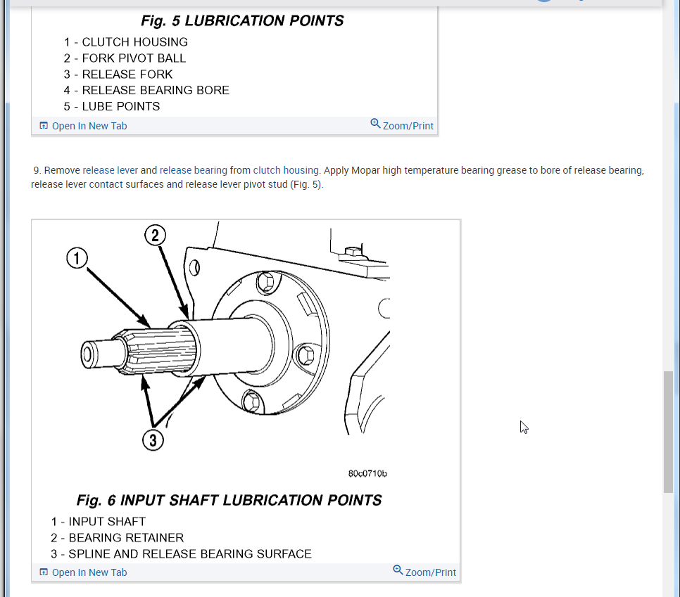

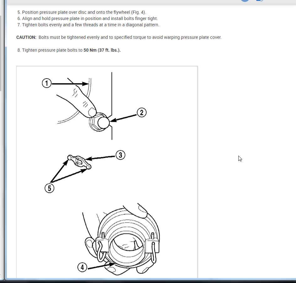

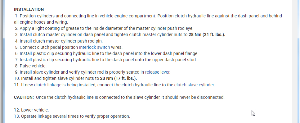

I am attaching a number of guides that will help with this.
https://www.2carpros.com/articles/clutch-doesnt-work-sometimes-or-not-at-all
https://www.2carpros.com/articles/throw-out-bearing-replacement
https://www.2carpros.com/articles/how-to-replace-a-clutch

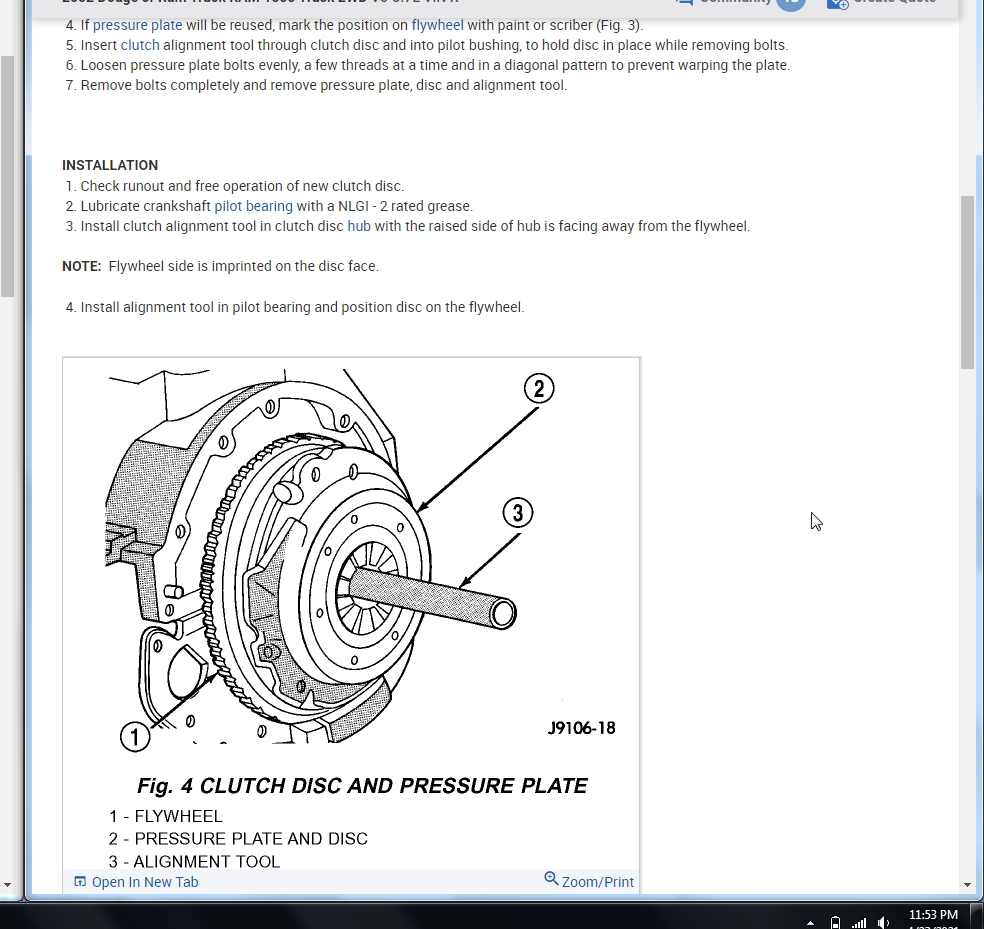

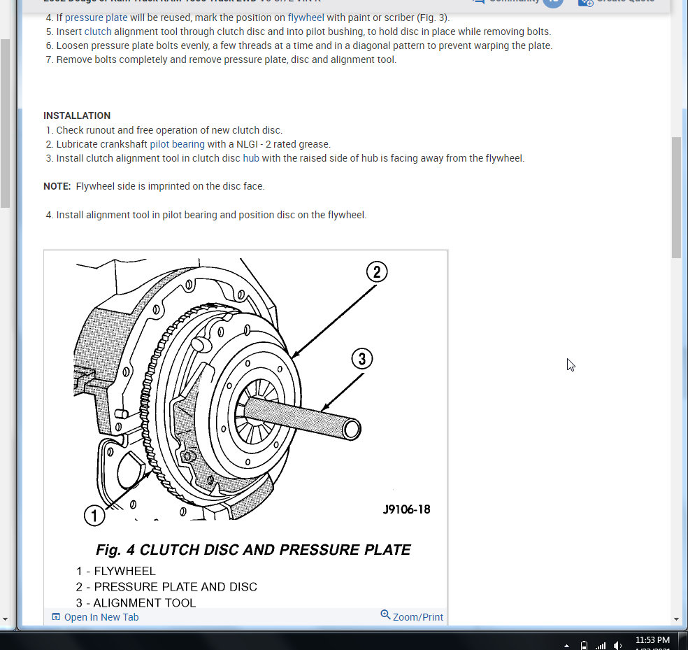

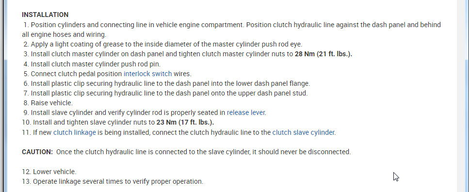

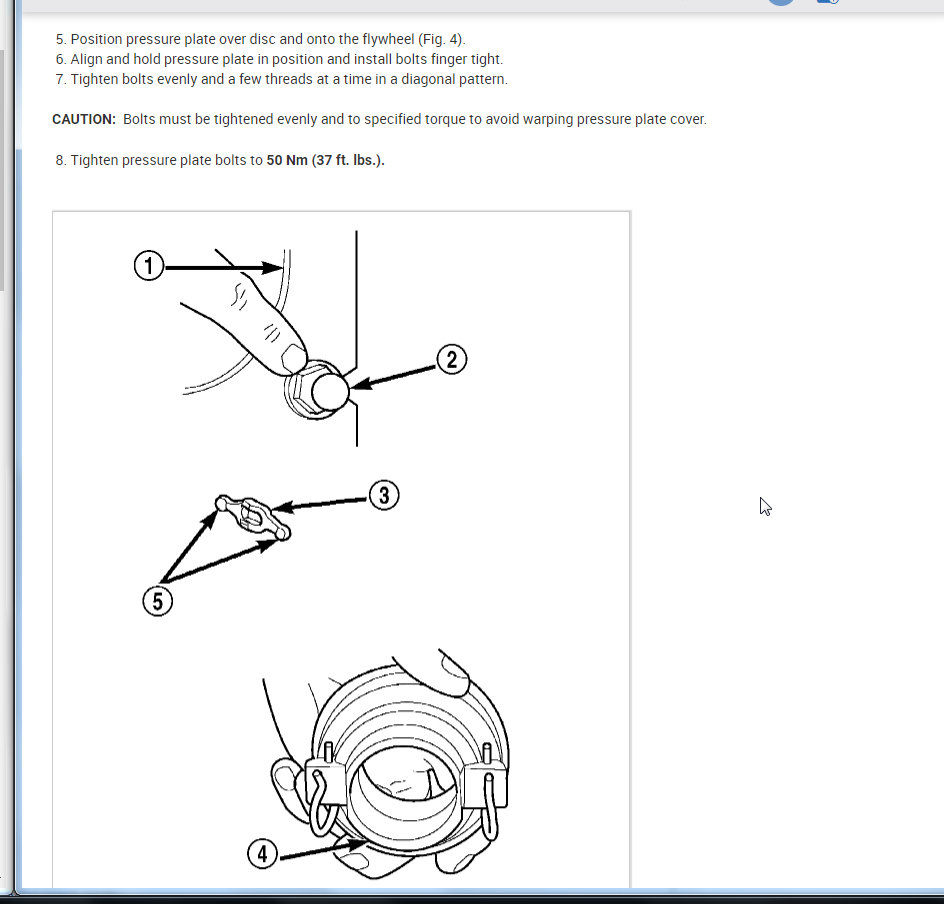

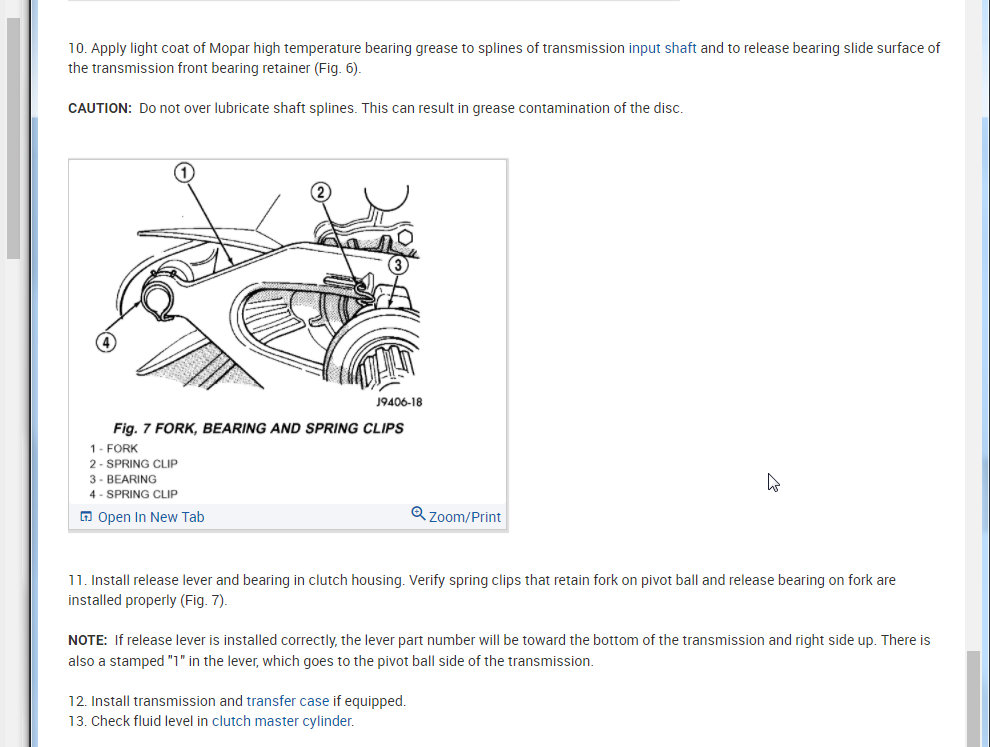

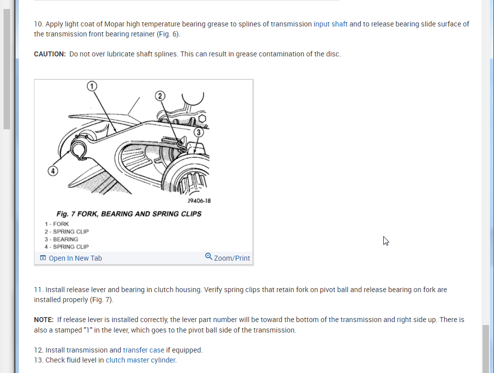

Below you will find the process from the manual on how to replace the clutch and additional components.
Please let us know if you have other questions. Thanks
