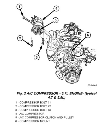

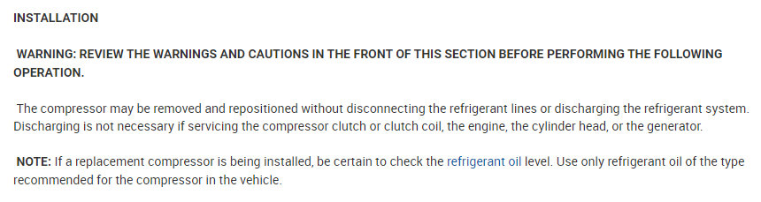

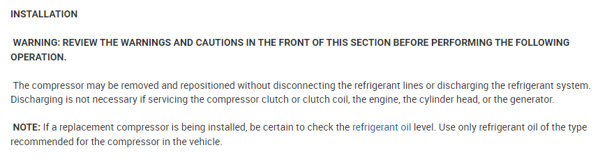

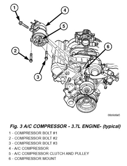

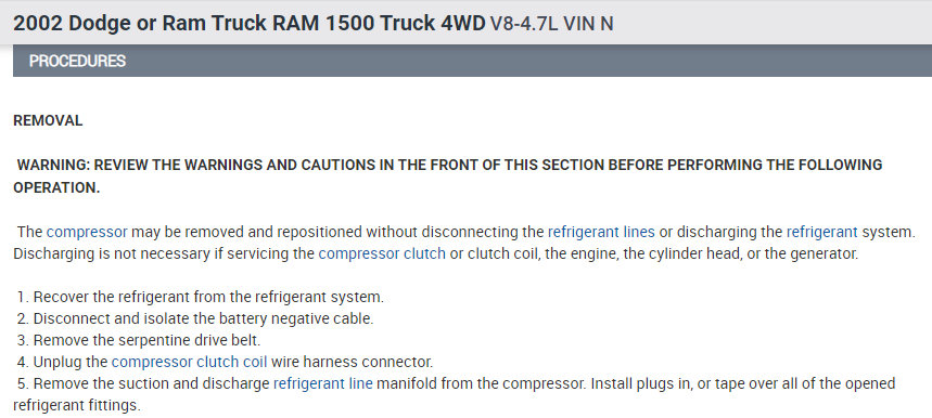

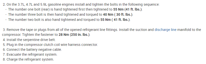

In case you're having an issue with the A/C compressor here is a tutorial for you to view on how to remove and replace:
https://www.2carpros.com/articles/replace-air-conditioner-compressor

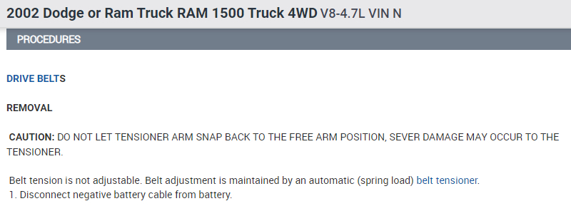

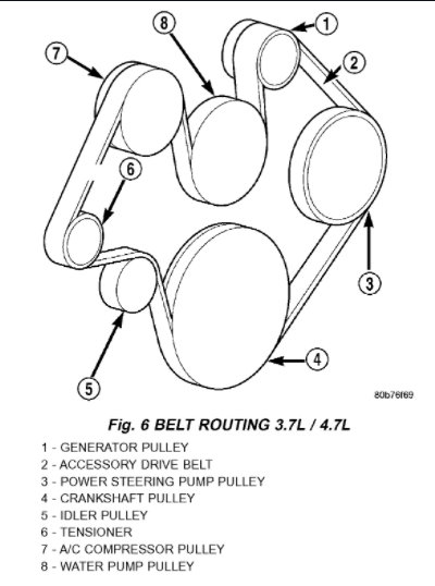

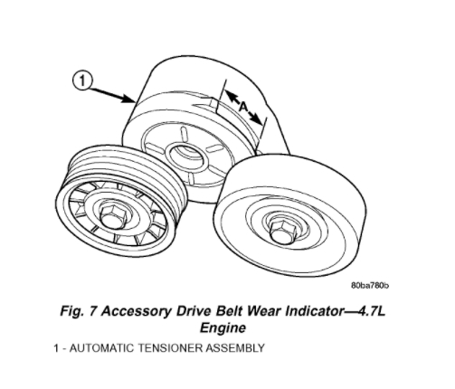

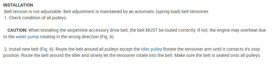

You will need to remove the serpentine-drive belt to be able to gain access and remove the ac compressor. Here is another tutorial showing how to remove and replace the serpentine belt:
https://www.2carpros.com/articles/replace-serpentine-belt

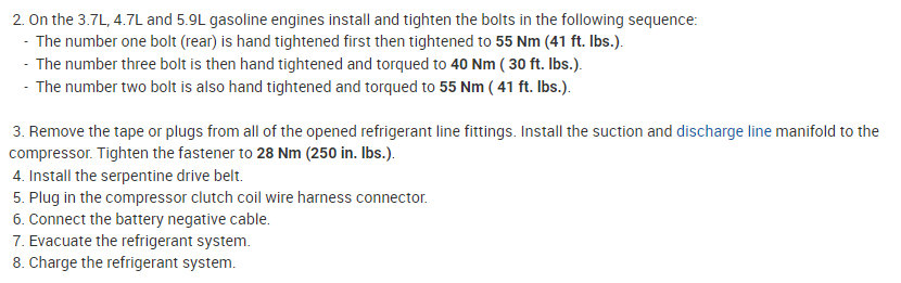

After you perform this repair you will need to vacuum and recharge the system. Here is a tutorial showing this as well:
I've attached picture steps below showing how to remove and replace both the serpentine belt and ac compressor on your Dodge Ram. Hope this helps and thanks again for using 2CarPros.
