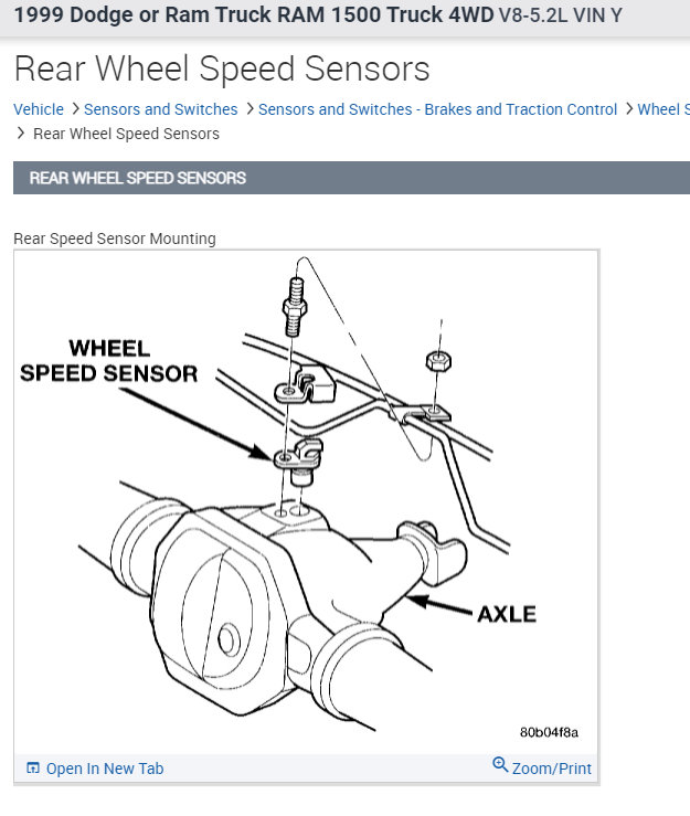

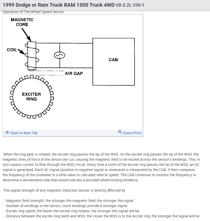

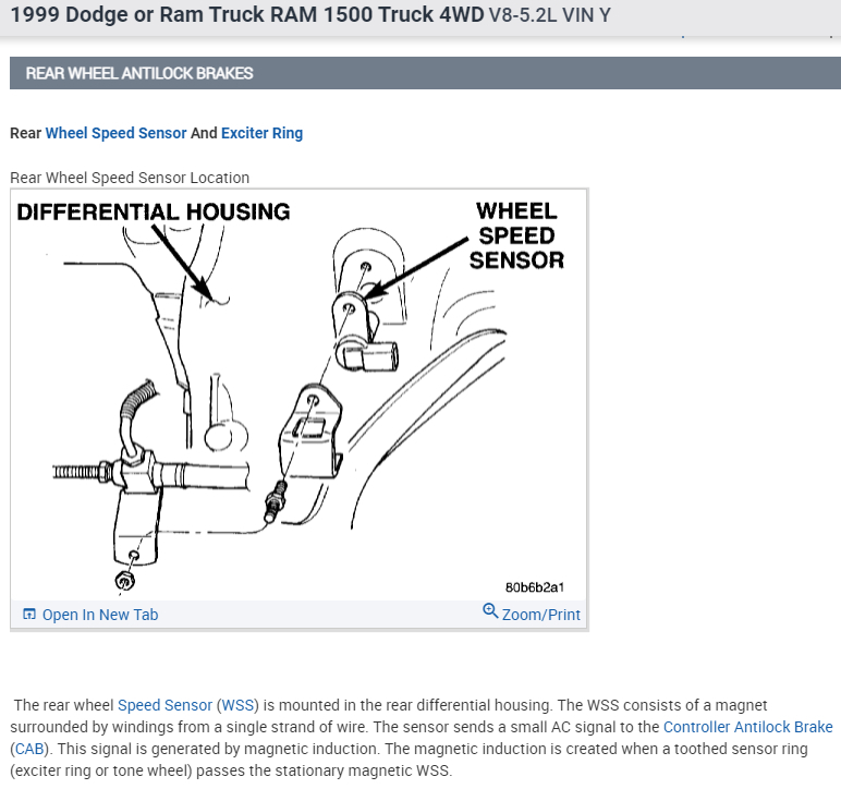

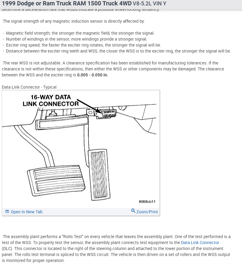

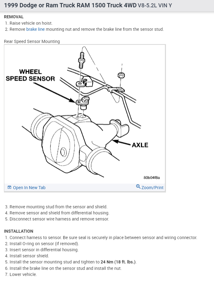

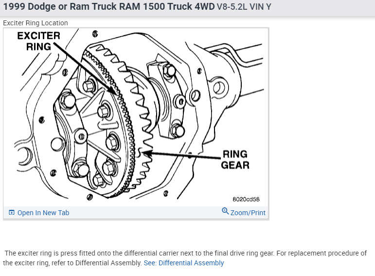

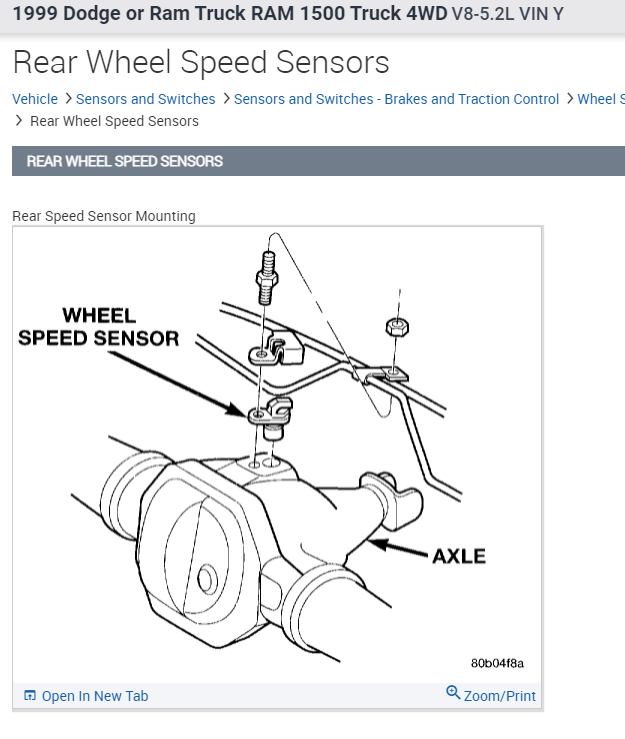

On this vehicle the speed sensor is located on the rear axle hub. Faulty speed sensor can impact the way the vehicle shifts.
I have attached diagrams for anyone looking for the procedure.
