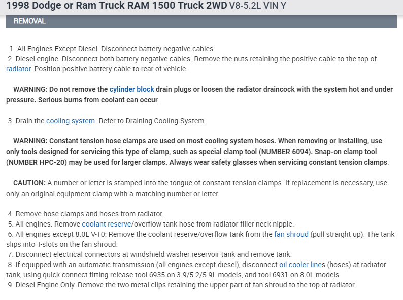

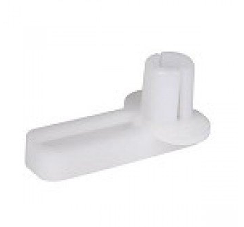

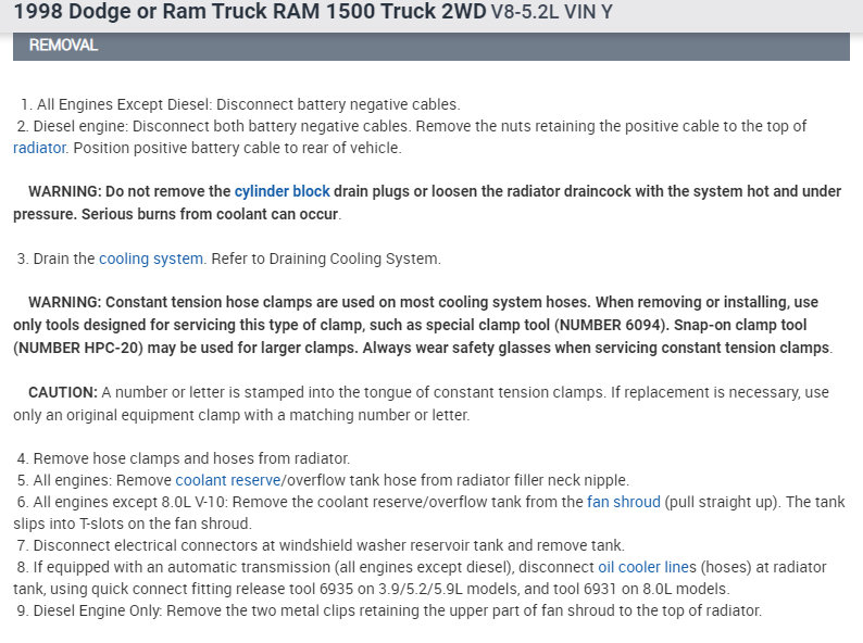

You will need a quick release tool # 6935 (look at the picture below), in order to effectively take off the cooler line from the radiator.
The quick release allows plastic clips inside the connector to release and that lets out the hose from the connector.
https://www.2carpros.com/articles/how-to-replace-a-car-radiator

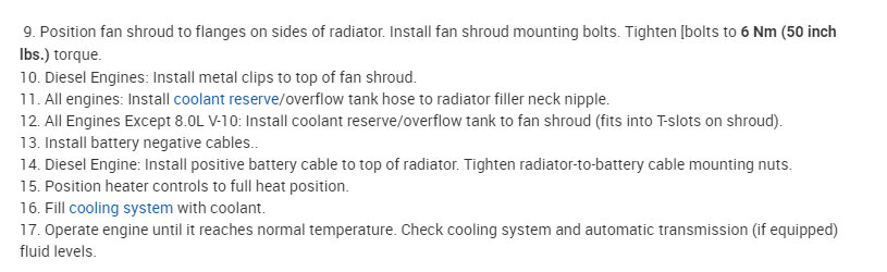

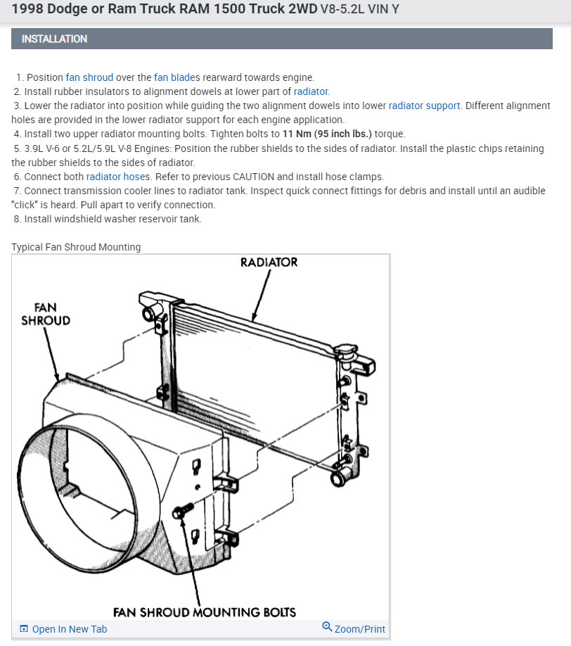

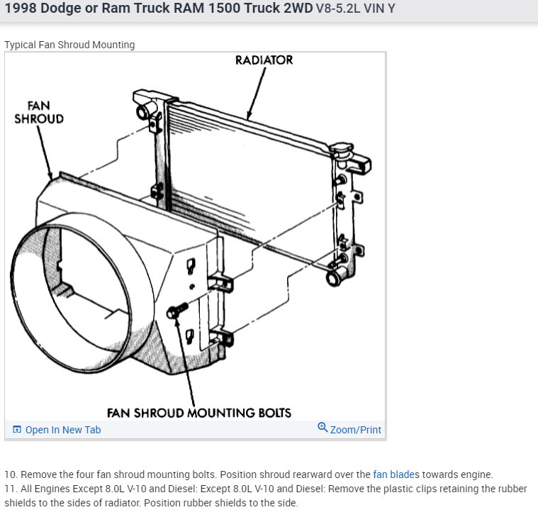

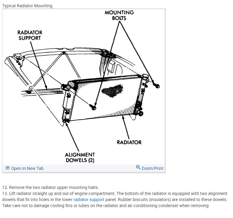

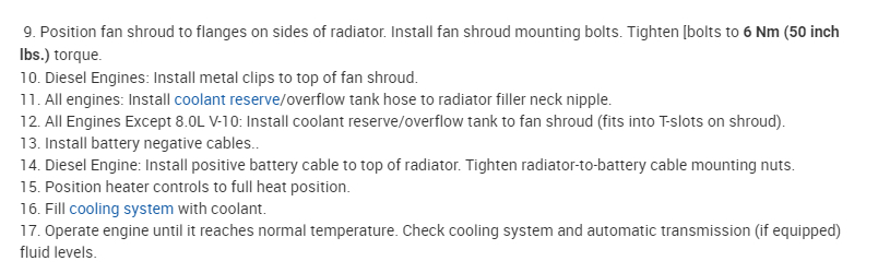

I have attached diagrams for the radiator replacement procedure below.
