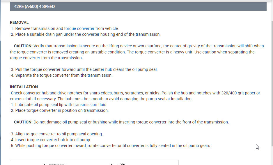

i have a chilton but its vague and doesn't have a diagram.
Jul 22, 2009 at 2:27 PM
Here are a couple videos that will help with this:.
https://youtu.be/3vJAojsrfuU
https://youtu.be/ZC7xHVMKLRw

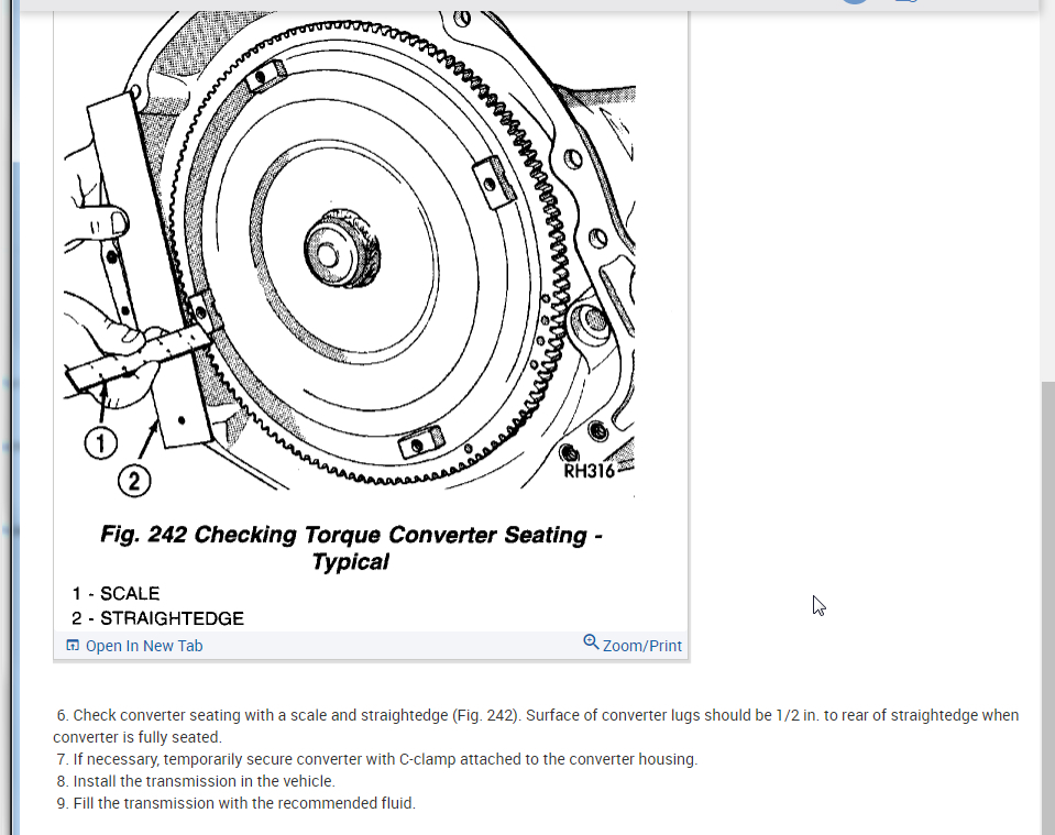

These units are all pretty similar so it is normally better to use a more recent year's manual as they provide more info.
Please see below and we can go from there if you have other questions. Thanks
