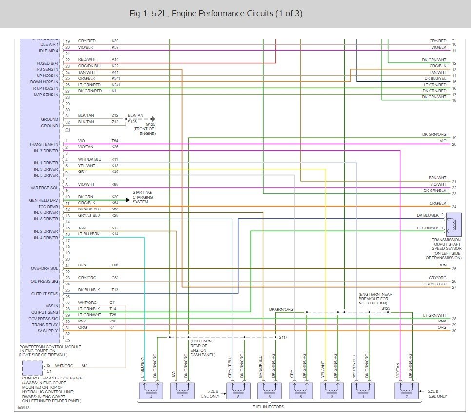

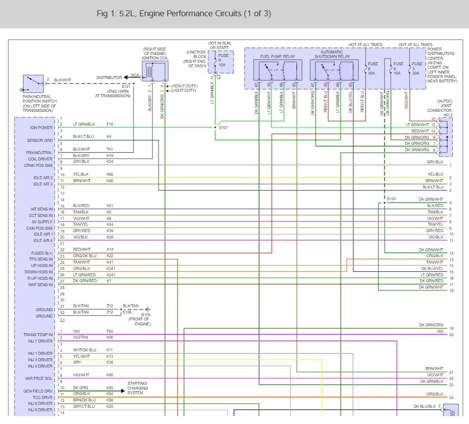

Is looks like you are having a problem with the wiring for the ASD relay and its location. Here is wiring diagrams (below) and a guide to help you do some testing.
Please run some tests and get back to us so we can continue helping you.

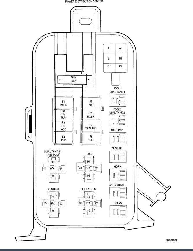

Suspect a problem with the crankshaft position sensor. Pulses from it tells the engine computer the engine is rotating. At that time, the computer turns on the Automatic Shutdown (ASD) relay which sends voltage to the coil(s), injector(s), fuel pump or pump relay, alternator field, and oxygen sensor heaters.
Also feel if the ASD relay clicks for two seconds when you turn the ignition switch on. If it doesn't, the terminals or coil inside could be corroded.

Yes the key needs to be on to check for voltage. Here is what I need to know. Is there power to the black wire with the gray stripe at the coil? Is there power coming from the dk green wire orange stripe coming from the coil? Does the gray wire with the black stripe have power at the cranksensor? Now I need to know if there is power to the black wire with the dk green stripe at the shut down relay? Get back to me with what you find. If any of these don't have power then we need to check the powertrain control module (computer). It may not be sending the signal.
Jul 6, 2020 at 1:39 PM (Merged)
If the wiring to the PCM is good, I recommend removing the PCM and having it checked.

Okay, this is a tough one since you replaced so much already. However, have you checked to make sure none of the main fuses under the hood are bad? Also, have you checked the ASD in the power distribution box under the hood?
