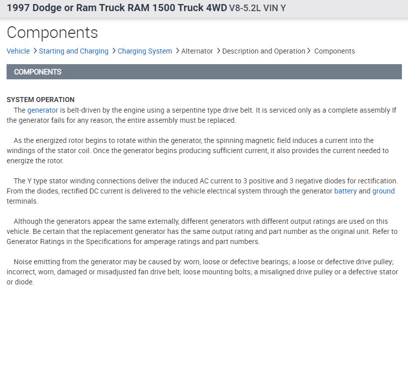

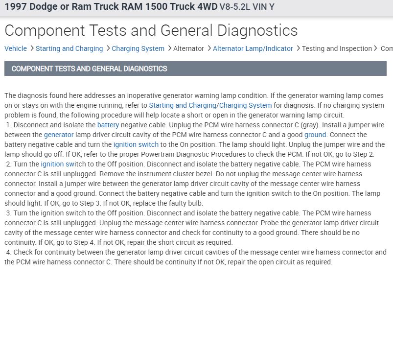

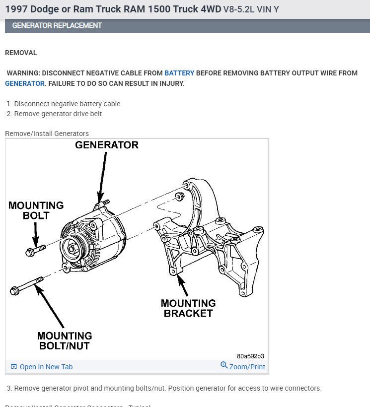

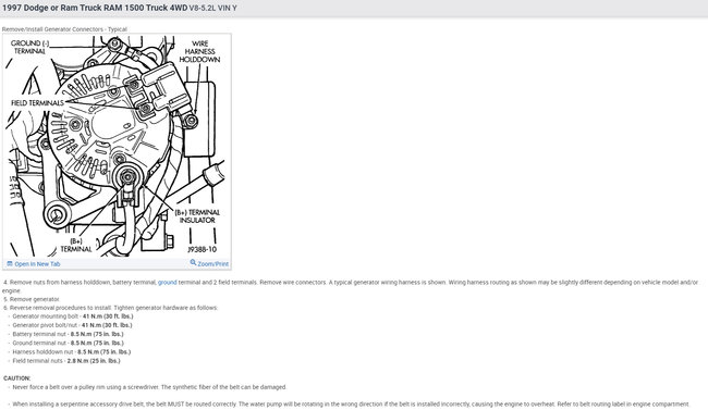

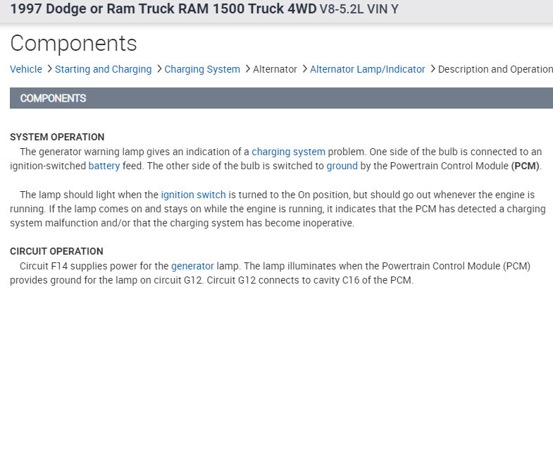

The battery light turns on when the battery is not getting adequate charge from the alternator.
It could be due to a bad alternator as well as faulty wiring.
First check to see the alternator output to the battery.
Here is a helpful video that shows how to test the alternator:
https://youtu.be/Z-p4dMJUpUw

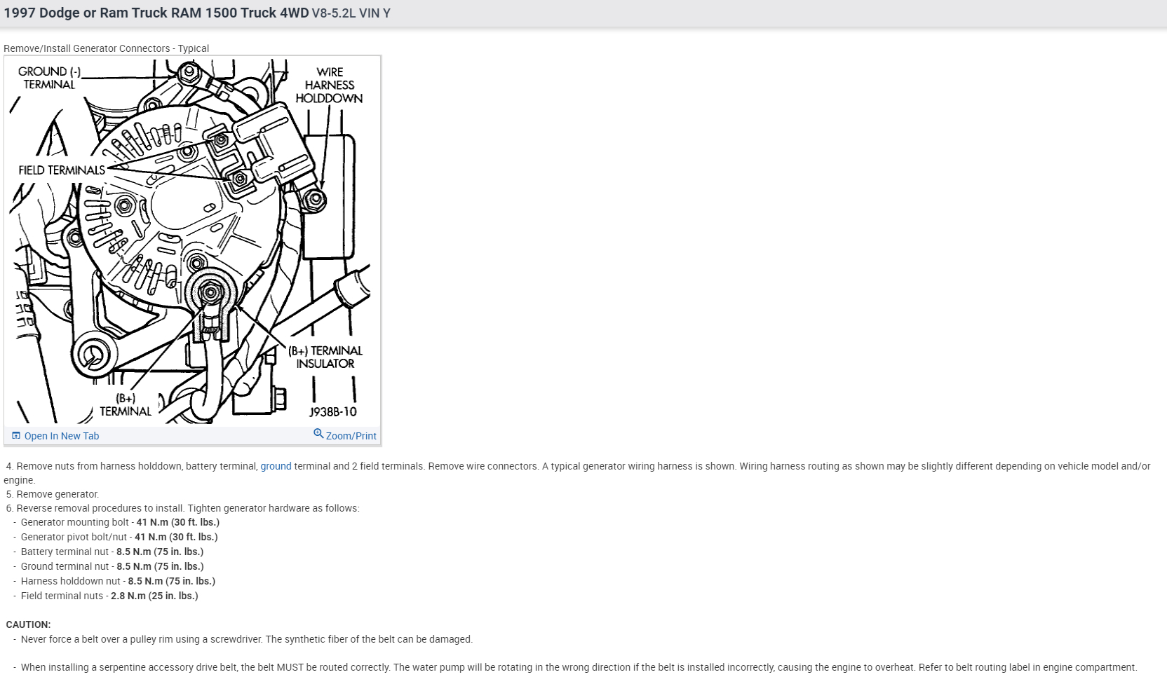

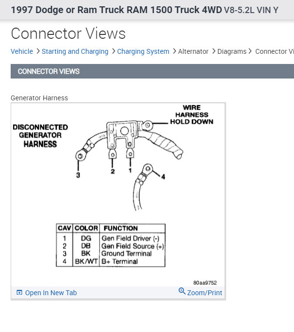

Check for any corrosion on the alternator cable. Clean if necessary.
It is possible to have a defective alternator that is not performing as it is designed to underload.
