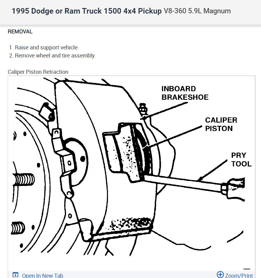

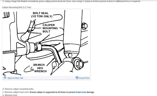

how do i remove brake rotors?
Dec 9, 2007 at 10:59 AM
MERLIN2021
CERTIFIED EXPERT
17,250 POSTS

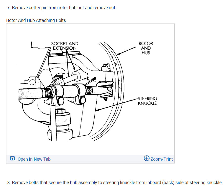

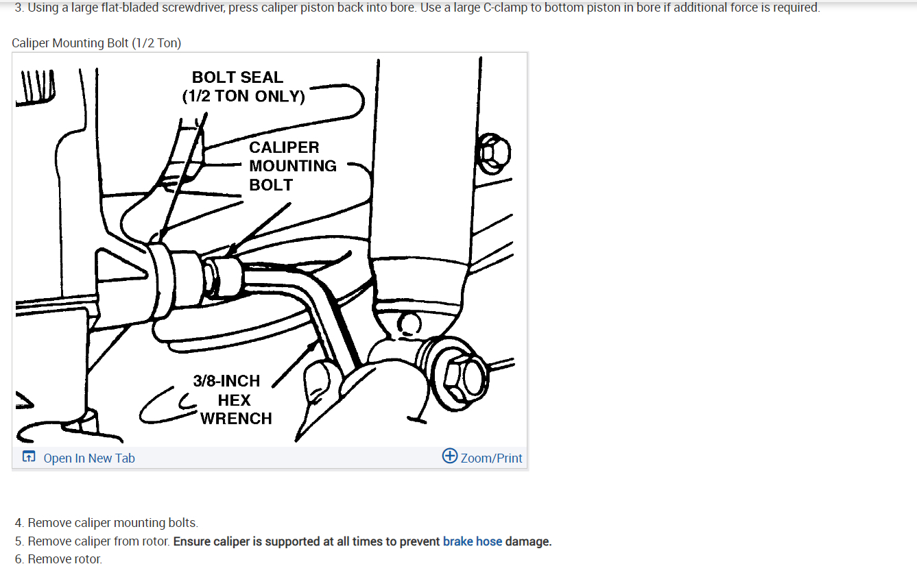

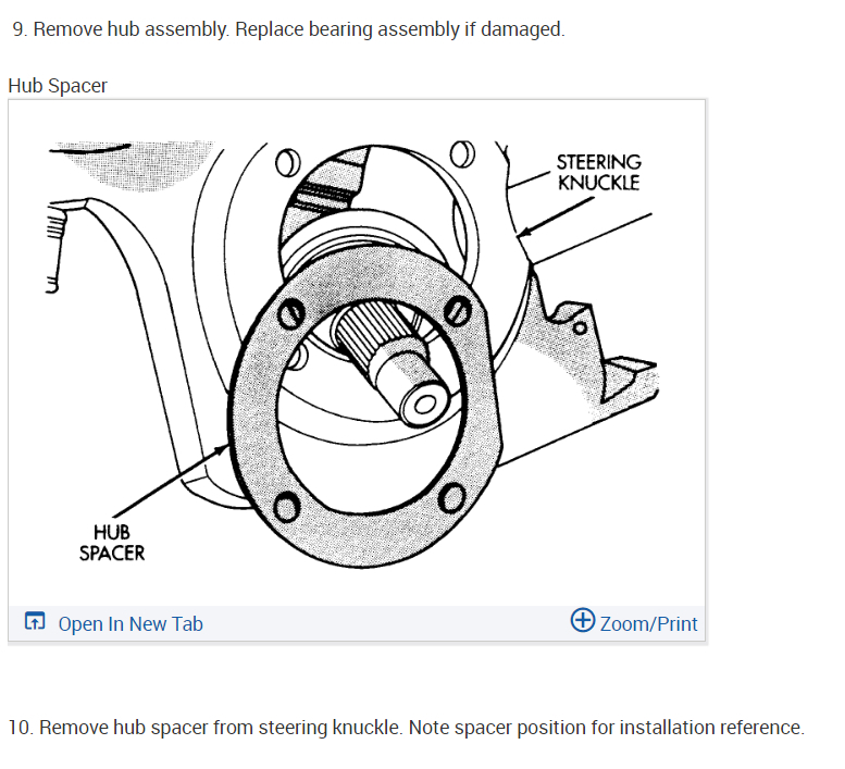

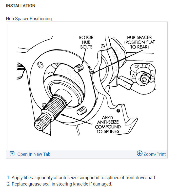

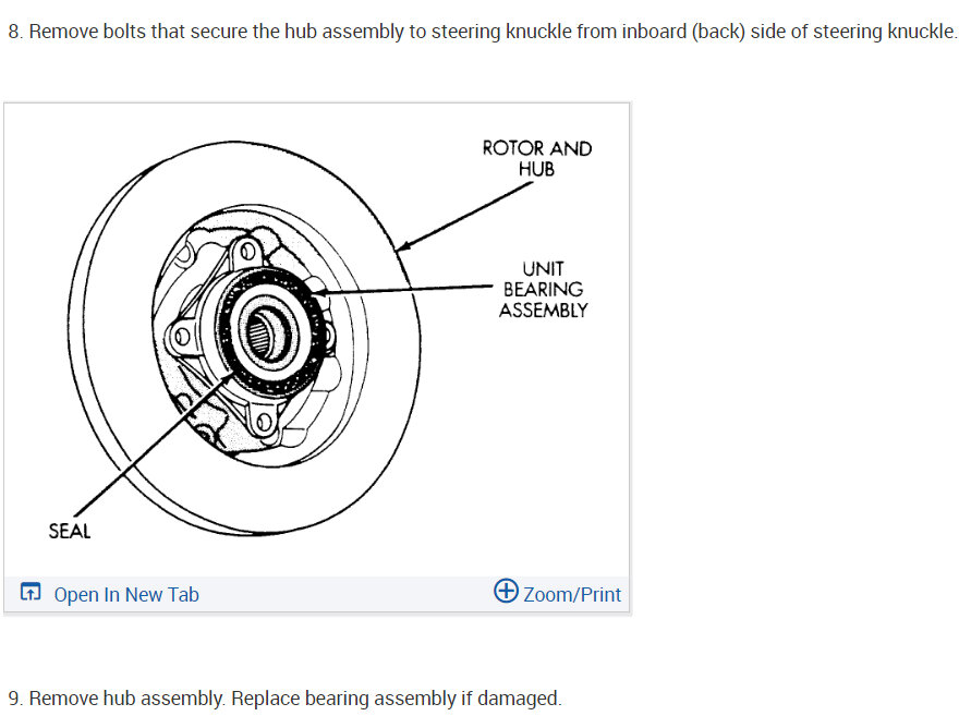

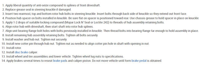

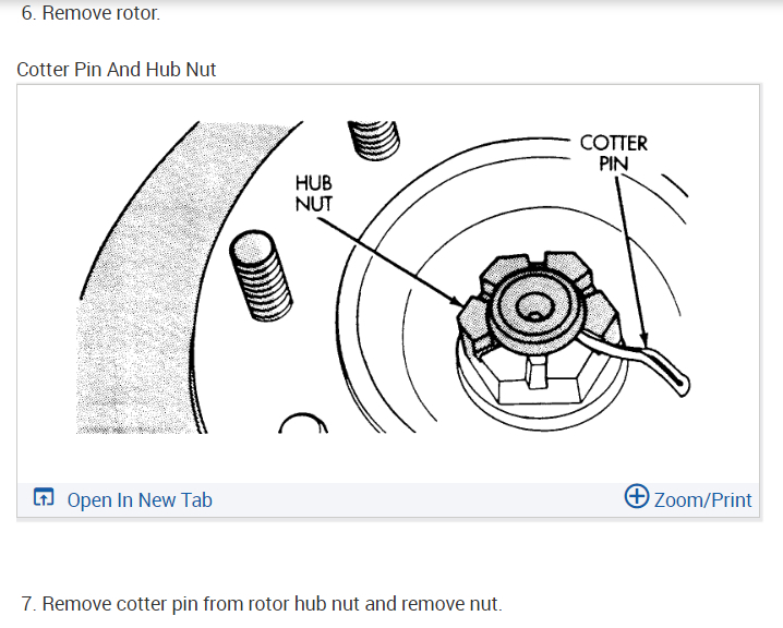

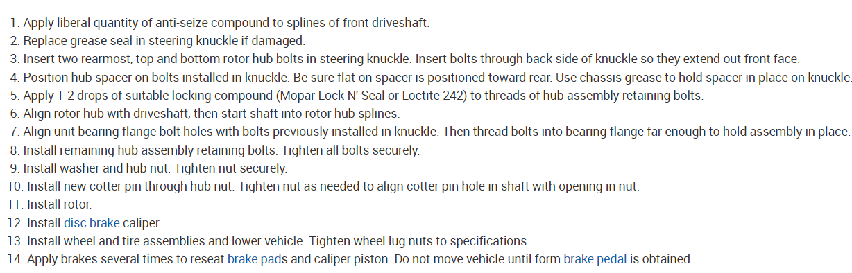

Here's the procedure, it looks like the rotor will come off with the bearing hub and then you can disassemble it. Check out the images (below). Let us know if you need anything else.
