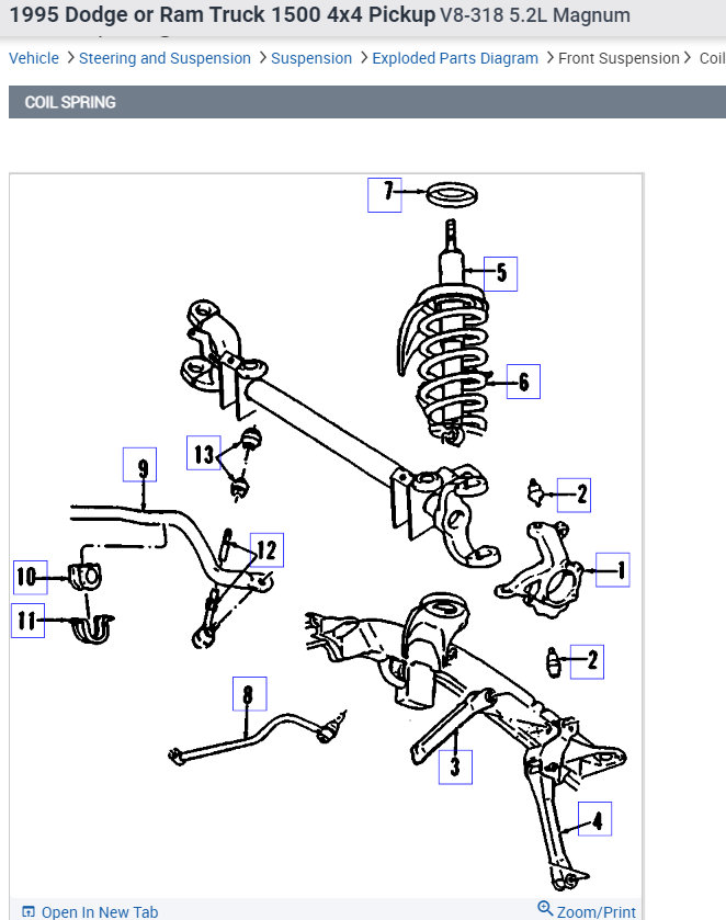

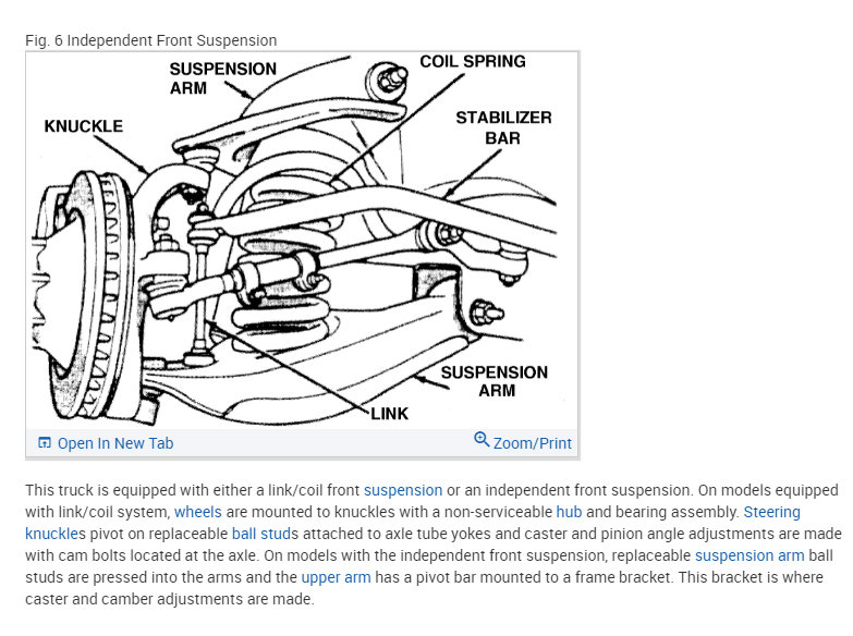

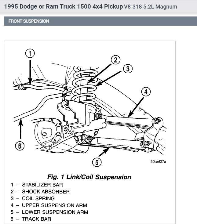

Typically, vibrations are due to worn or damaged components.
It will be a good idea to do a thorough inspection of the suspension components. Look to excessive play in the lower ball joints. Check the bushings for the control arms. Look for any damaged components.
