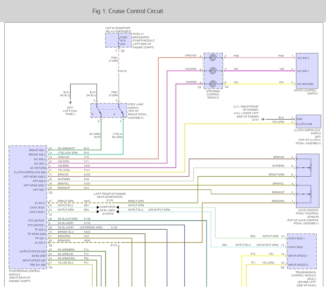

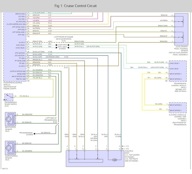

The fuse is M15 in the integrated controller which is under the hood, here is a wiring diagram to help show the fuse and other wiring so you can troubleshoot the problem and a guide to help test the fuse. There is no relay I have seen the steering wheel clock spring cause this issue.
Please run some tests and get back to us so we can continue helping you.
