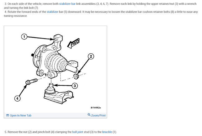

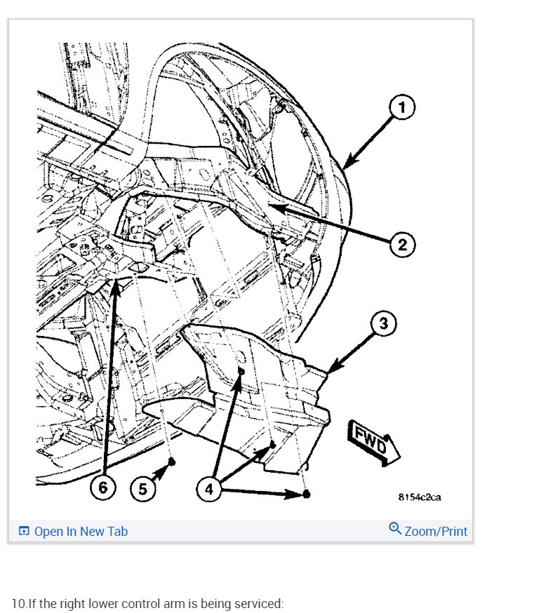

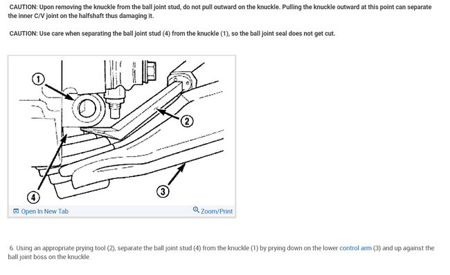

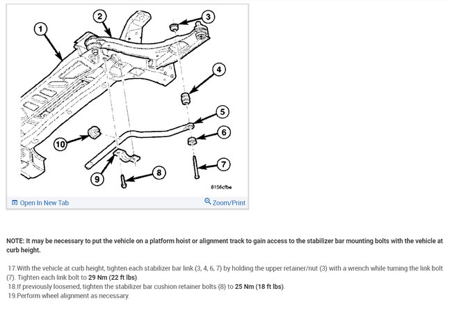

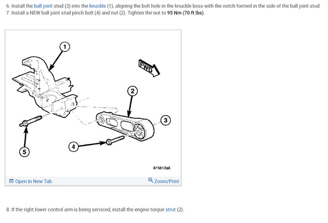

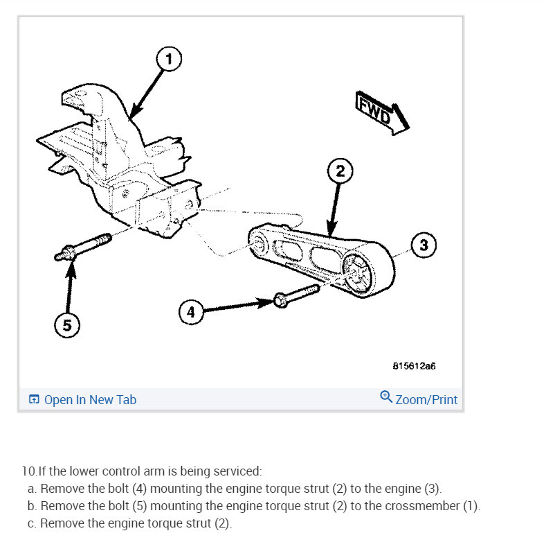

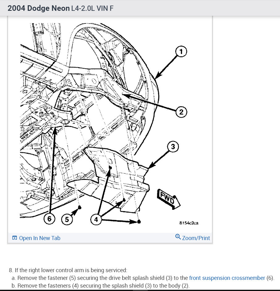

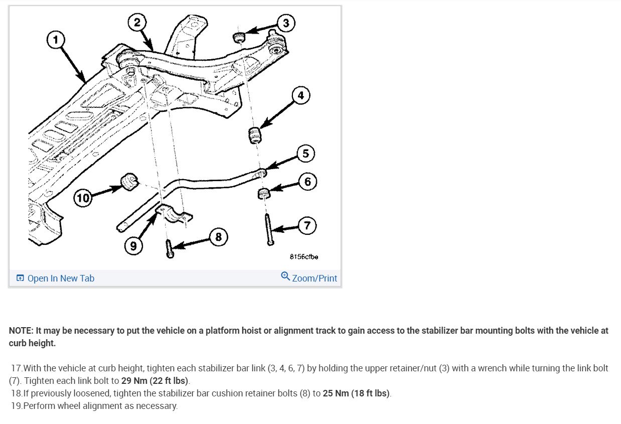

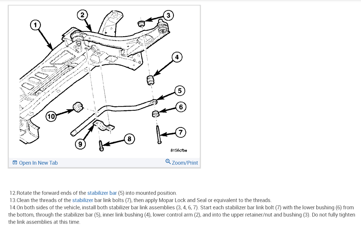

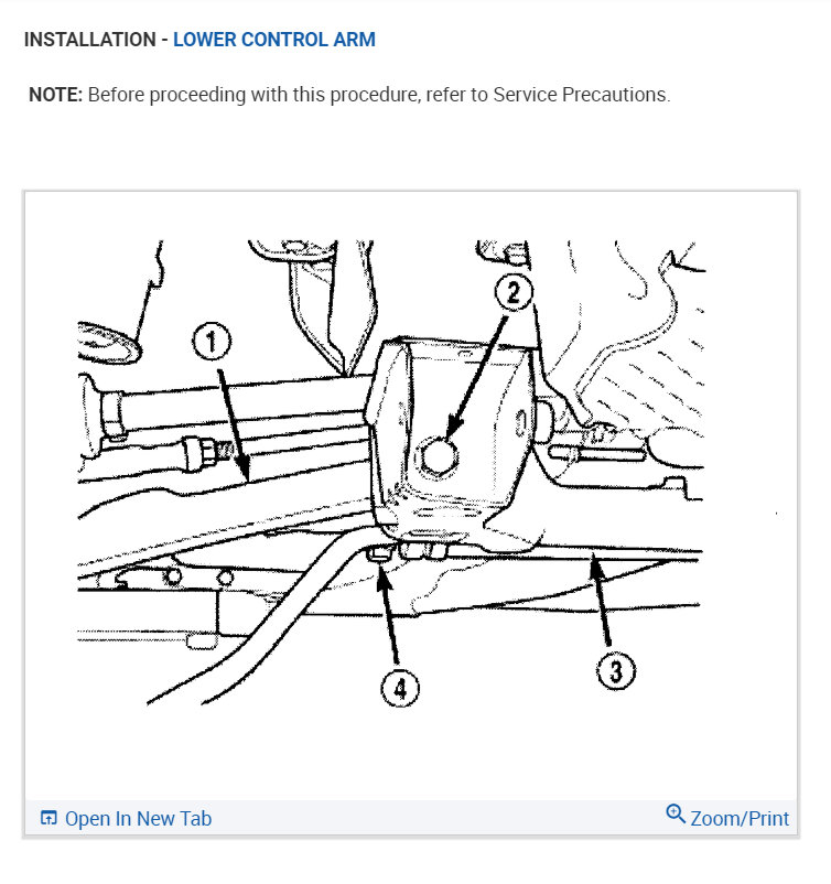

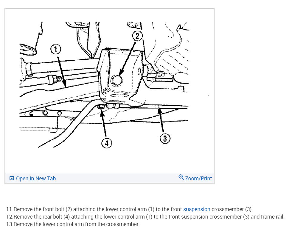

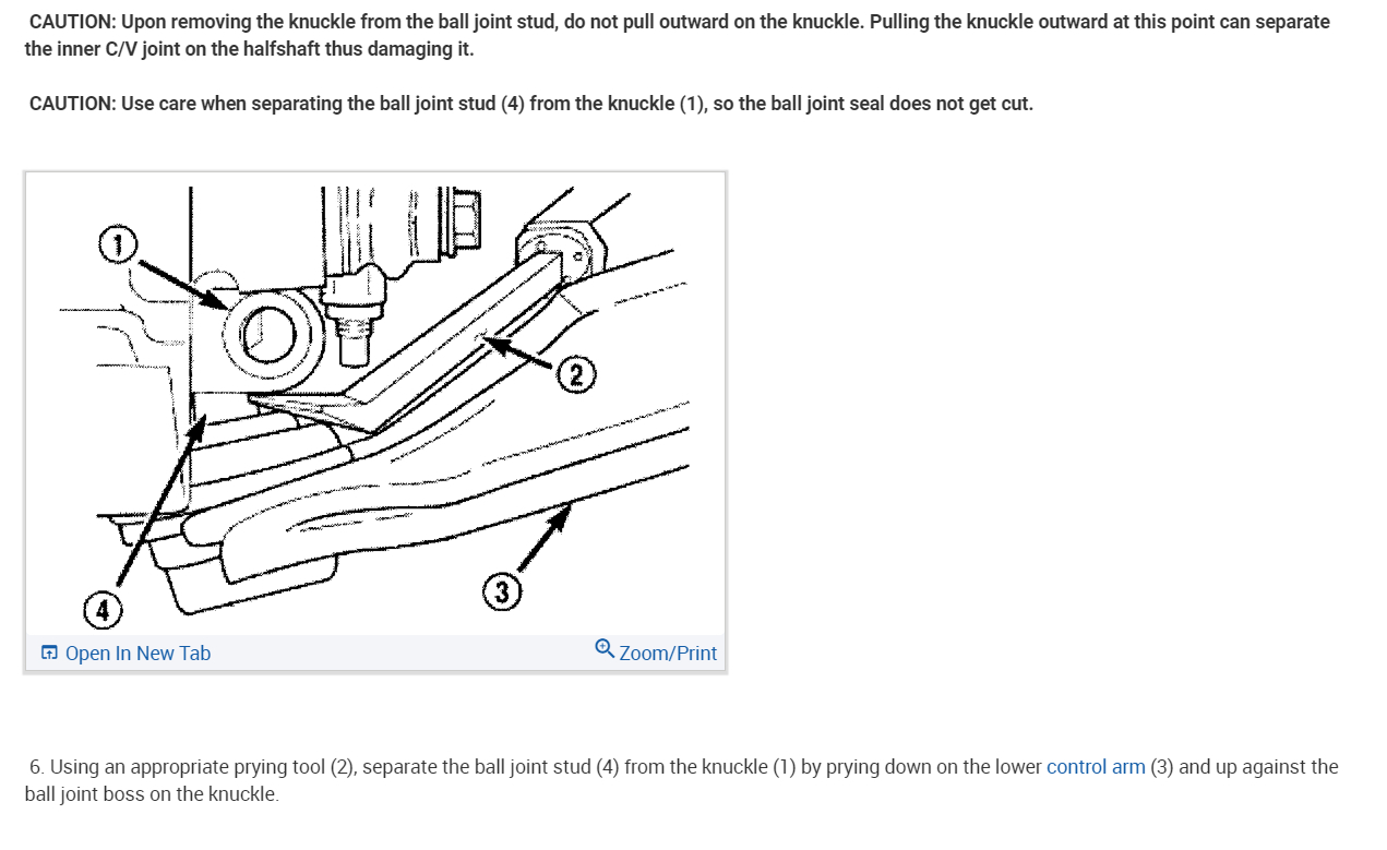

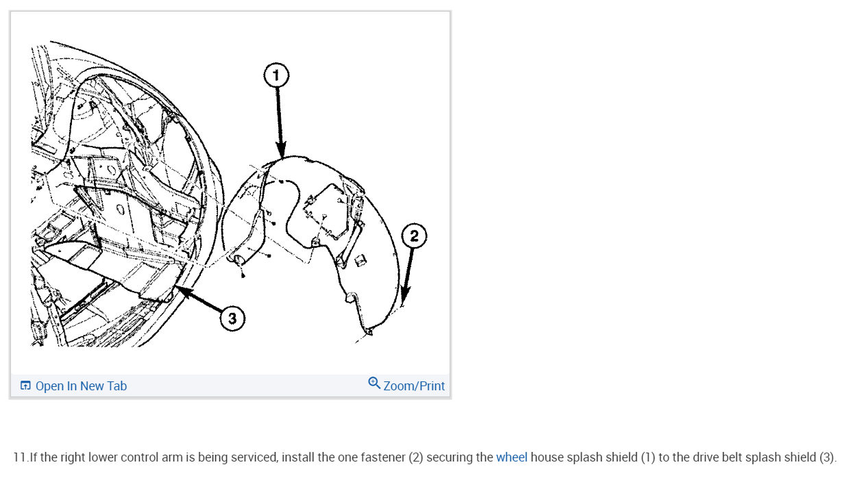

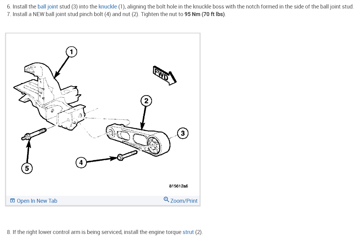

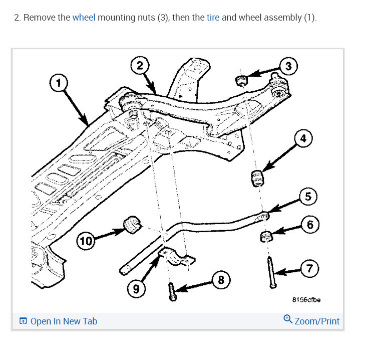

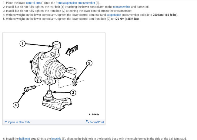

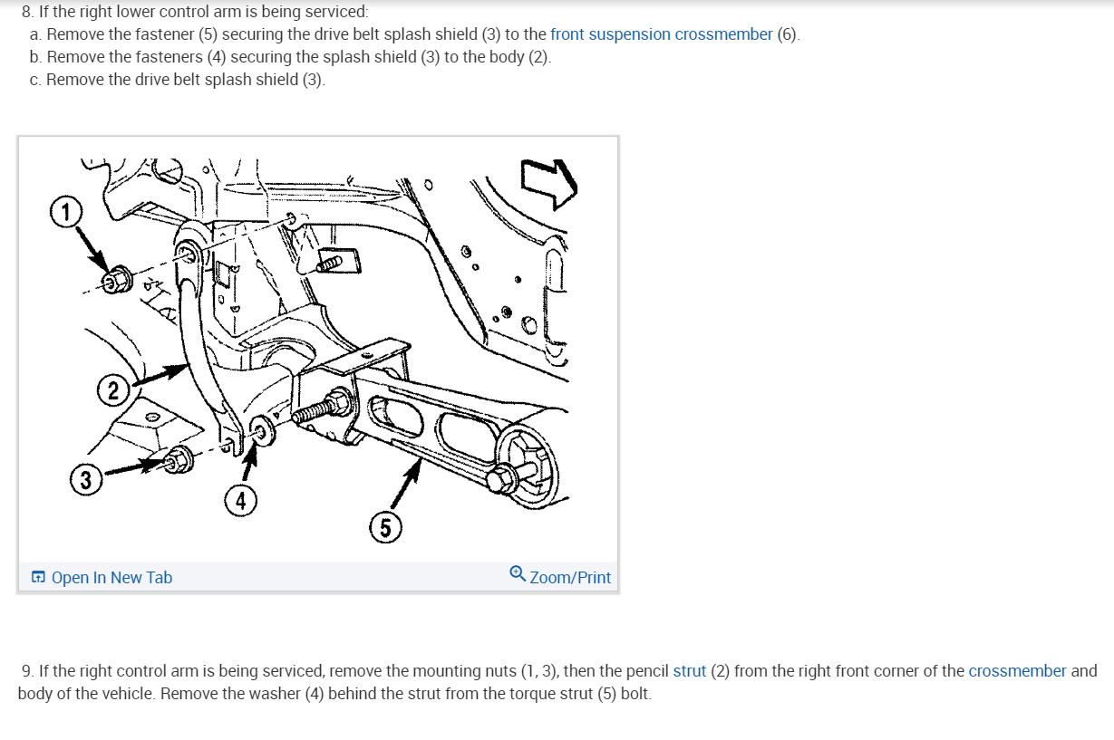

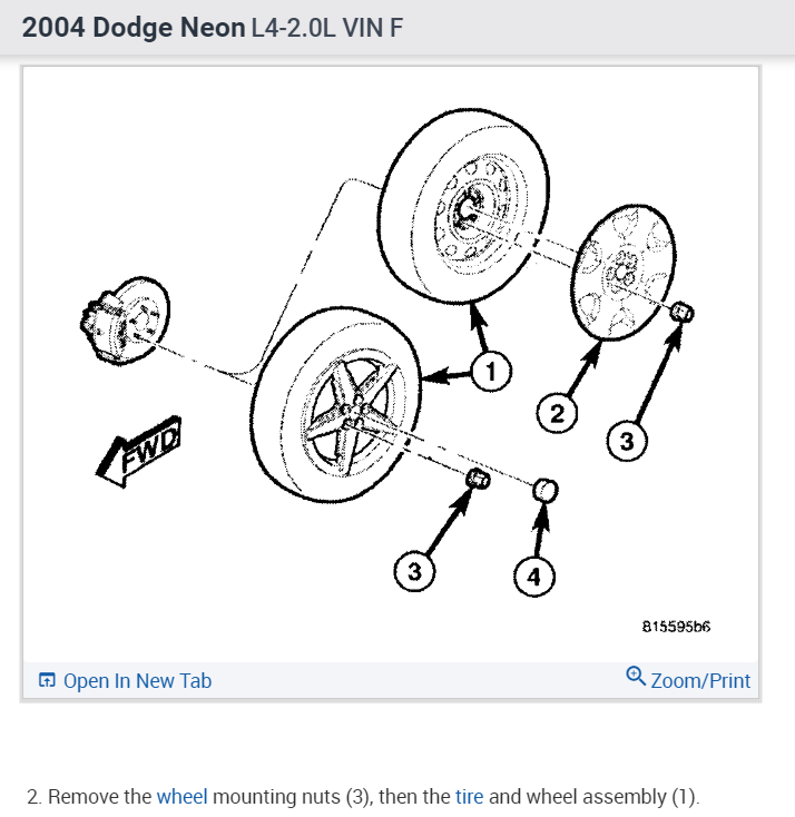

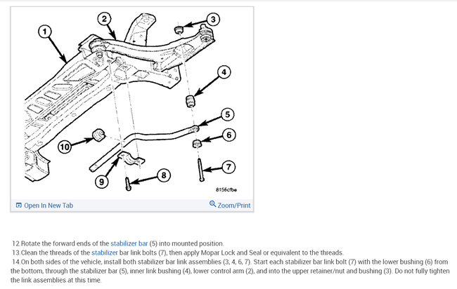

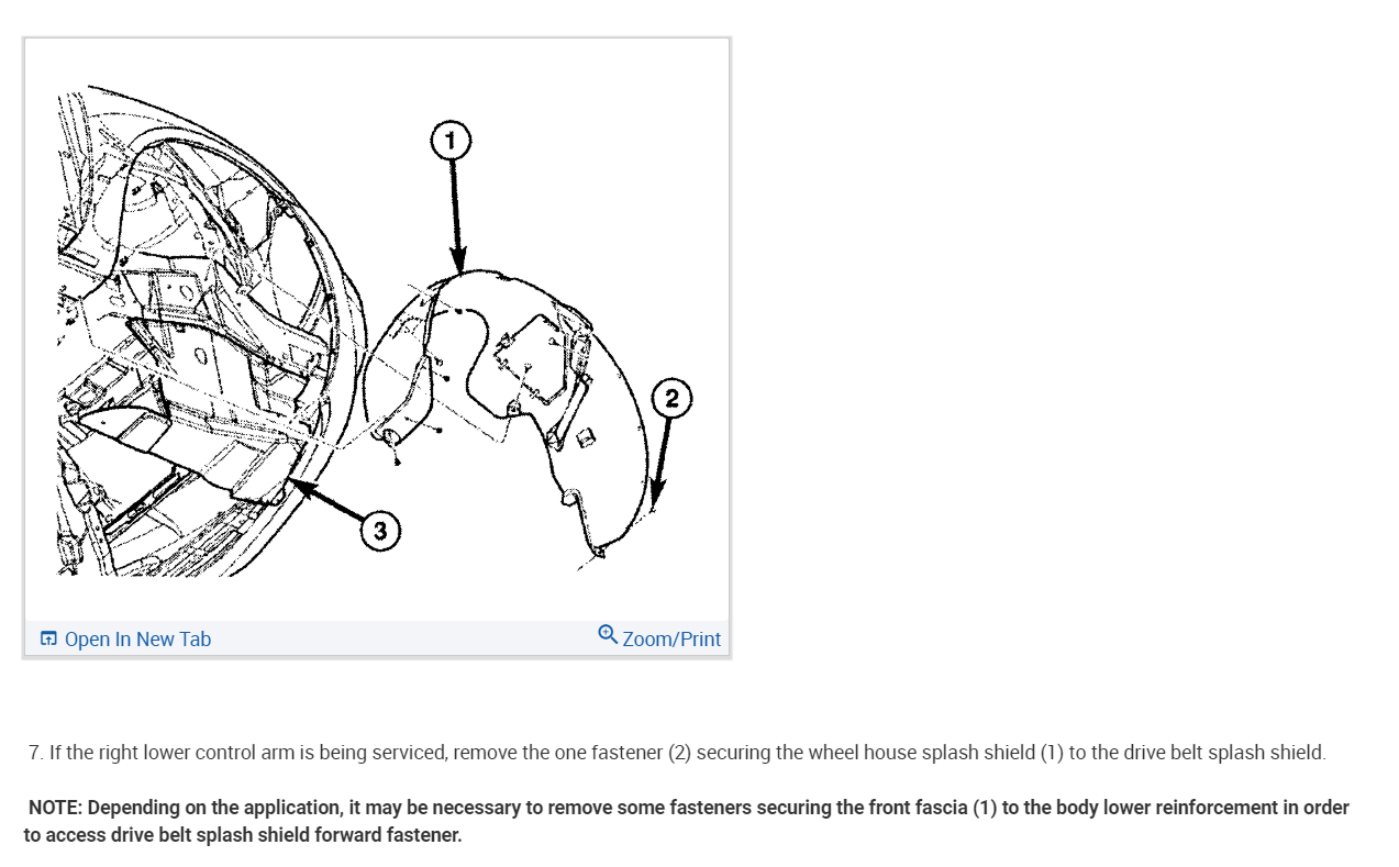

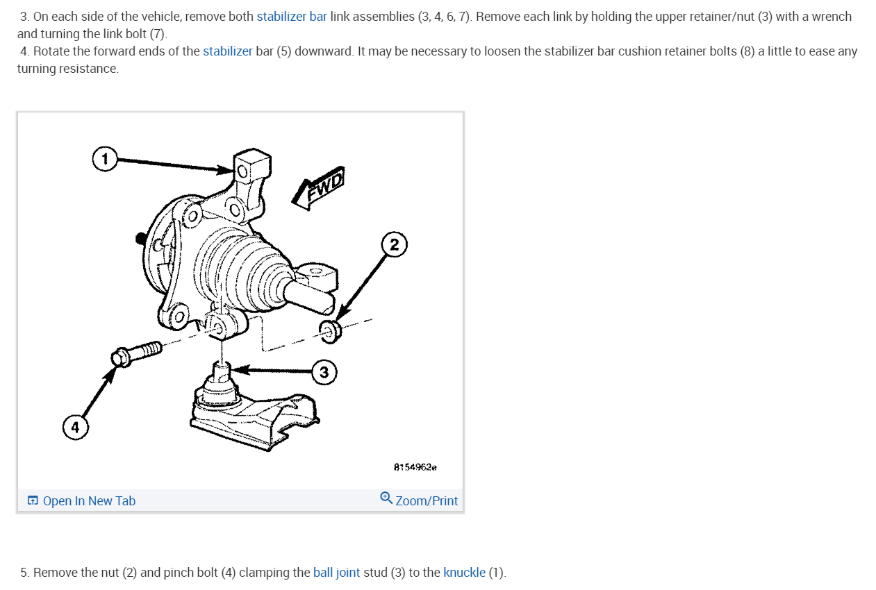

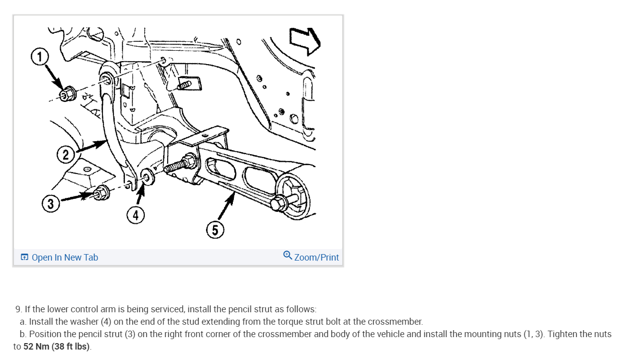

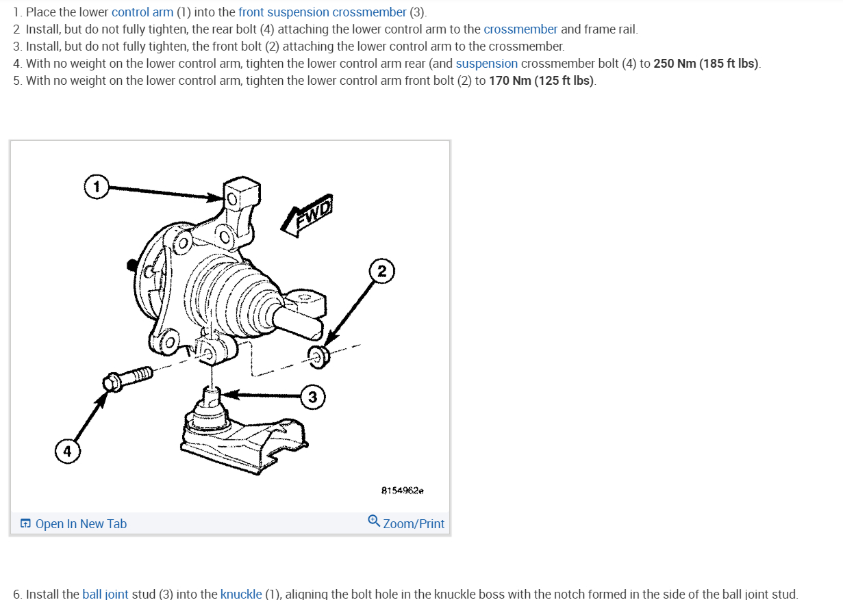

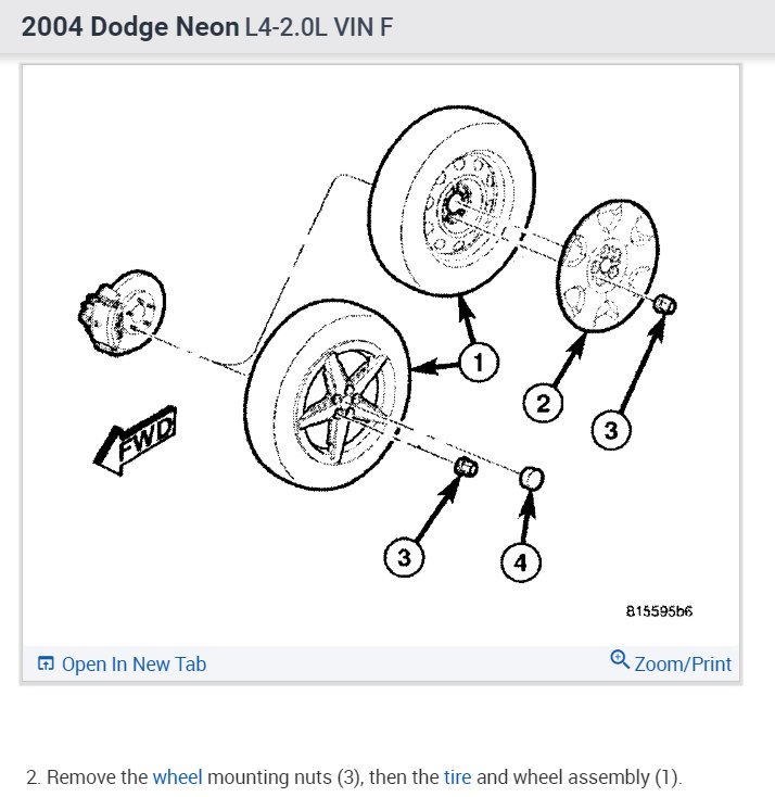

I show 75.00 including arm and bushings...I would say 38,000 on a lightweight car like yous is pretty lousy! If you have air tools and good jack it won't be too bad. Here are the instruction in the diagrams below. Check out the diagrams (Below). Please let us know if you need anything else to get the problem fixed.
