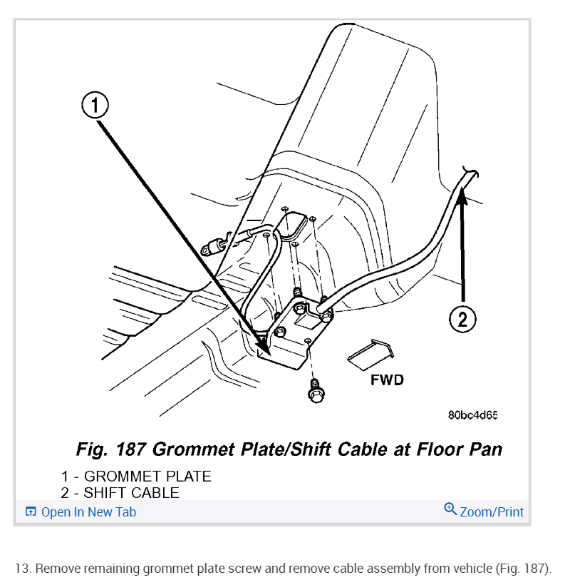

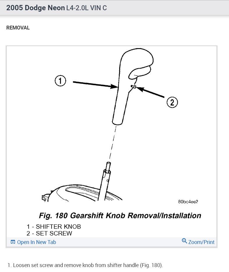

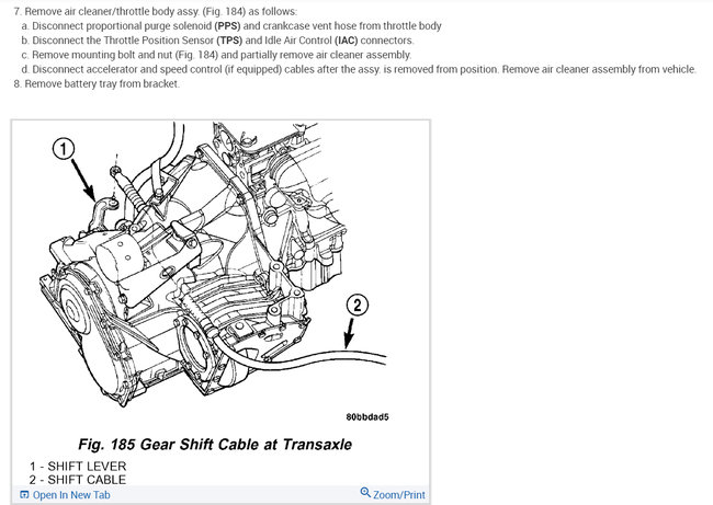

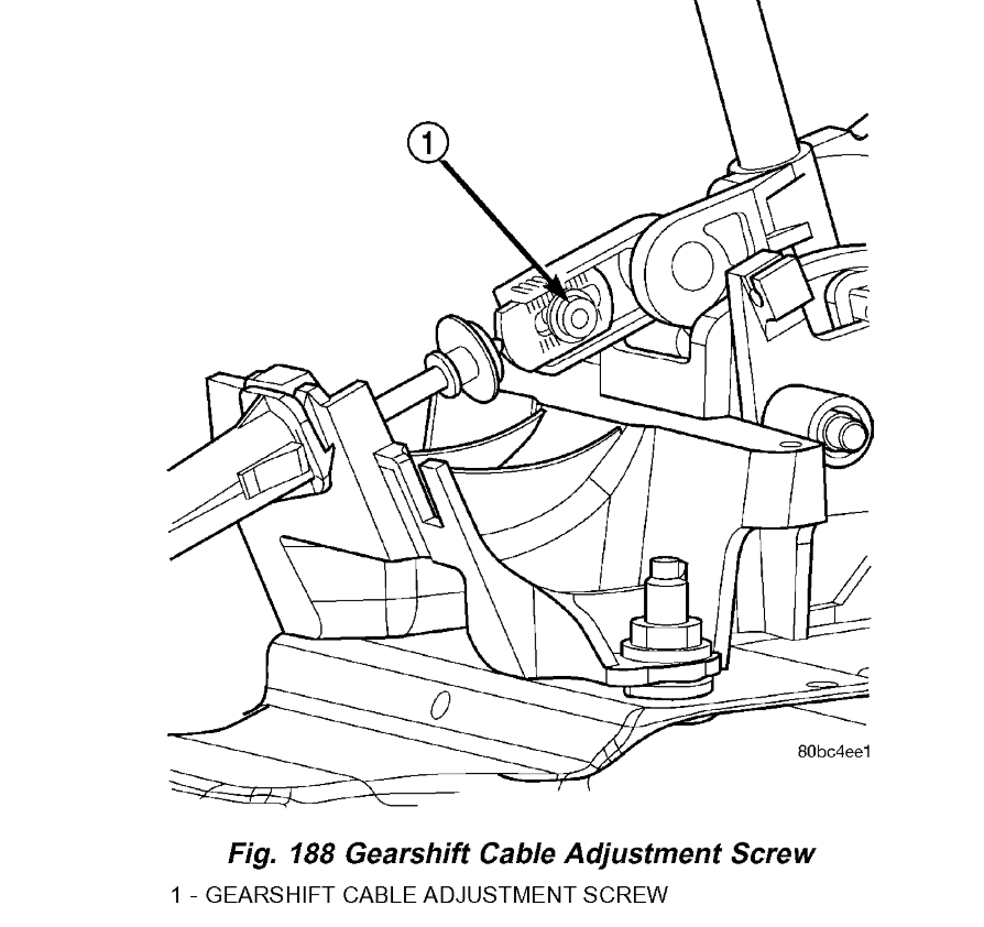

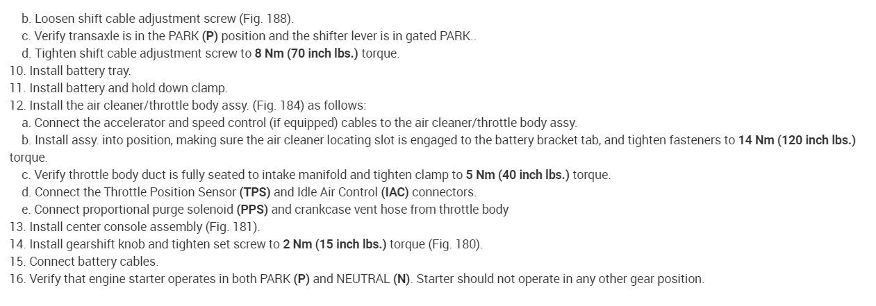

trying to change the gear shift. wont seem to go into park. the shifter is in park but key still wont come out when turned off, and when I shift gears on the shifter no gears engage. any advice?
