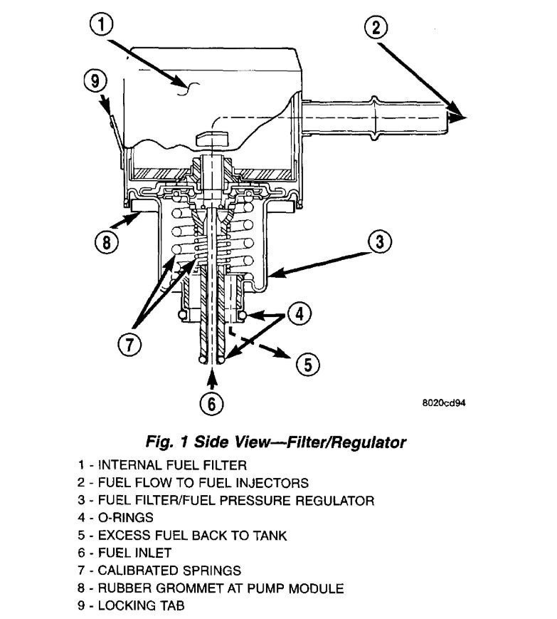

Where is the fuel filter located in my vehicle?
[img:c5d9199c9e]http://www.2carpros.com/forum/automotive_pictures/161427_c445083a_1.jpg[/img:c5d9199c9e]
I need to replace it

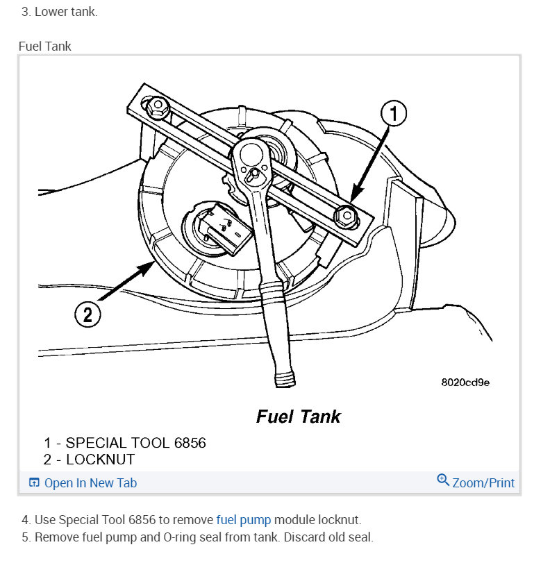

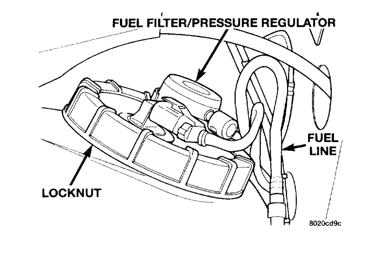

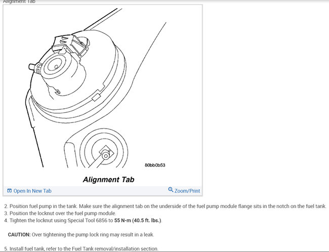

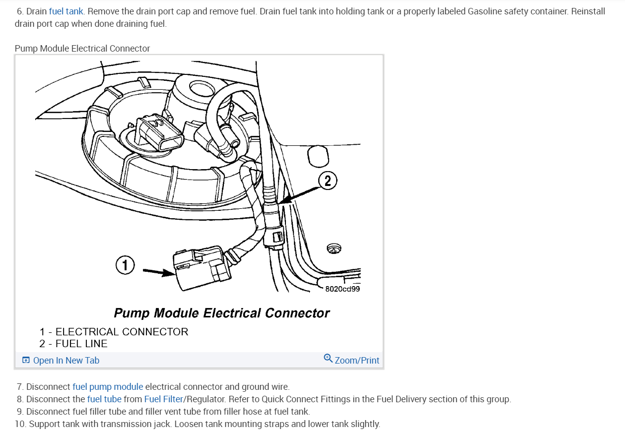

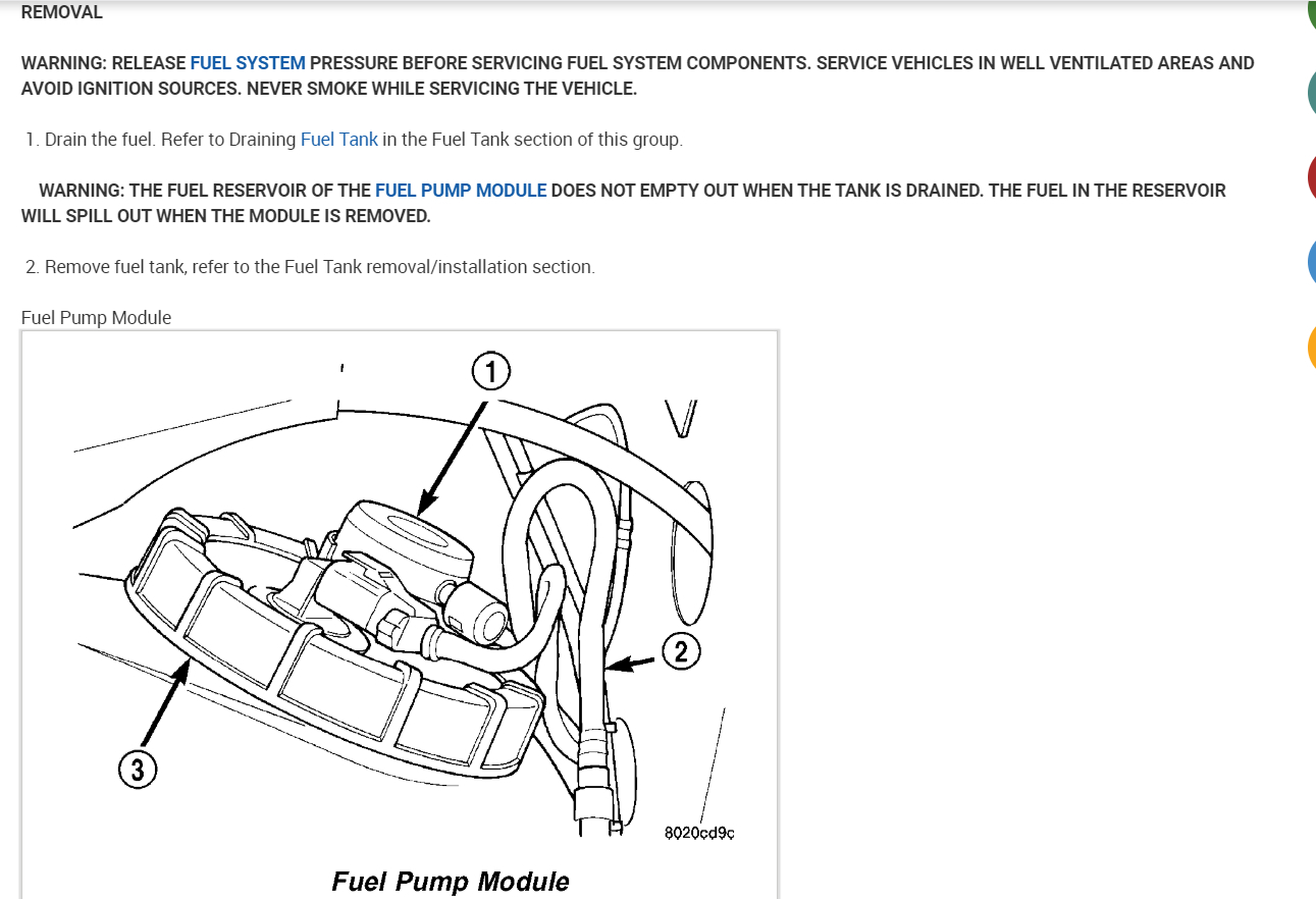

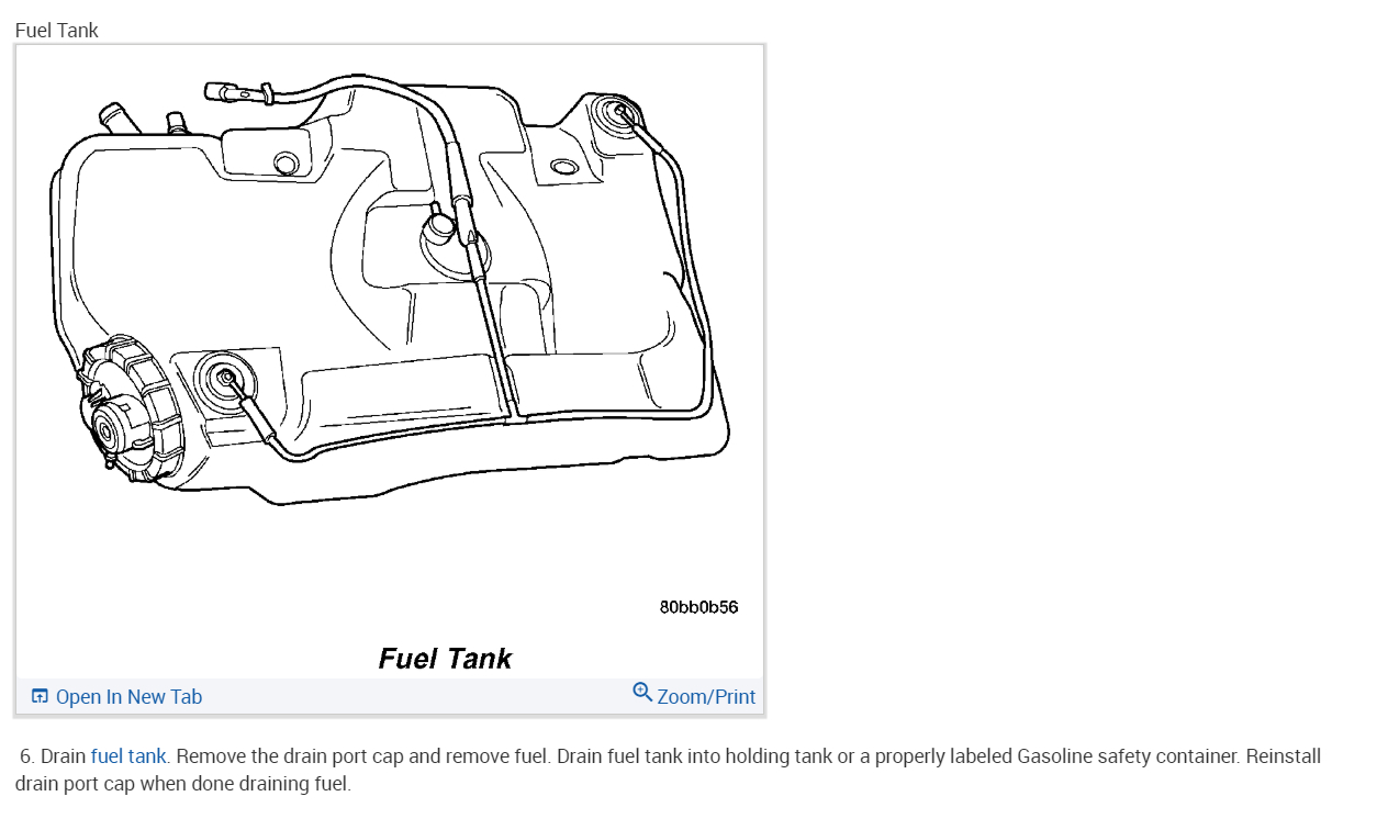

The only filter in your car is in the fuel tank, and is only replaceable as part of the pump module. Here is a guide to help you see what's going on and how to replace the filter and pump module with instructions in the diagrams below to help you you your car.
https://www.2carpros.com/articles/how-to-change-a-fuel-filter

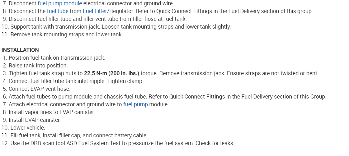

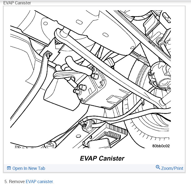

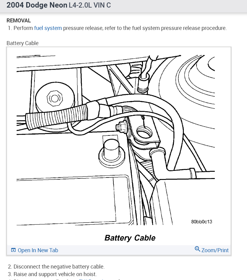

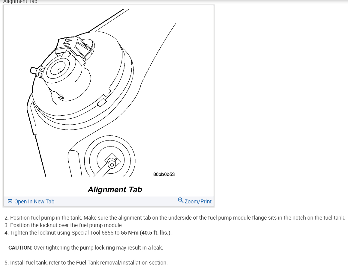

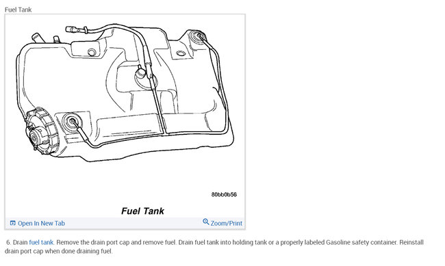

Your gonna love this, It is on top of the fuel tank and is part of the pressure regulator. The fuel tank has to come out of the vehicle to replace it. Sorry
See the images below

the filter is mounted on the pump inside the fuel
https://www.2carpros.com/forum/automotive_pictures/266999_neon_1.jpg
tank

The filter is in the tank with the fuel pump.
