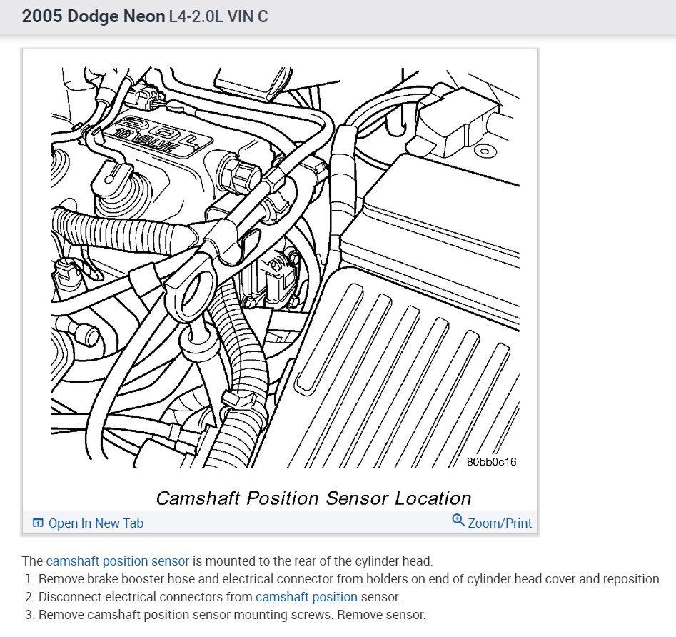

Where is the CAM sensor located on the 04 Neon? I've been having problems with the check engine light coming on and the car not wanting to go above 2200 RPM. After taking it to a local auto parts store they said that the CAM sensor needed replaced. My husband said no problem and bought the part. Now we have no idea where it goes. Any ideas?

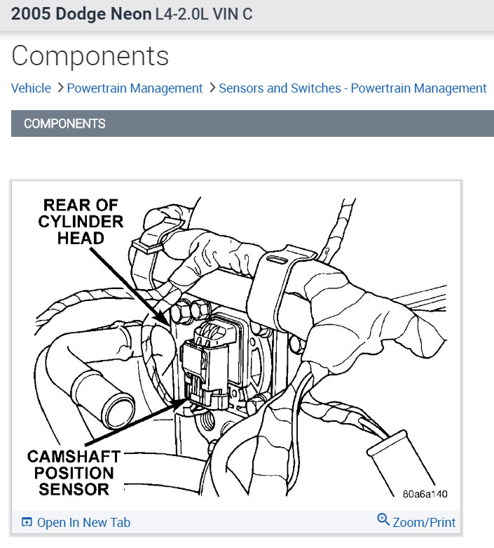

where is the cam position sensor on my car

Hi there, Cam position sensor is located on the rear of the cylinder head, as per pic. Mark (mhpautos)

and the location
https://www.2carpros.com/forum/automotive_pictures/99387_neon_24_1.jpg
https://www.2carpros.com/forum/automotive_pictures/99387_cam_neon_20_1.jpg

This can be because the timing belt is wearing out and let the engine jump tooth or the connector is bad. Here is the location of the sensor and connector. Check out the diagrams (Below). Please let us know if you need anything else to get the problem fixed.

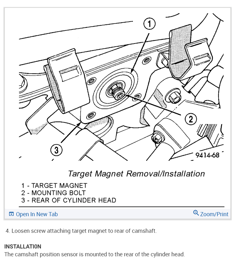

Not too hard! Just line up the pins in the magnet with the holes in the back of the cam. First pictures are 2.0 After 2.4 instructions are the 2.4 diagrams. CAMSHAFT POSITION SENSOR Removal & Installation (2.0L) 1. Camshaft Position (CMP) sensor is located on rear of cylinder head. See Fig. 30 . Remove brake booster hose and harness connectors from valve cover and reposition. 2. Disconnect CMP sensor harness connector. Remove CMP sensor mounting screws. Remove CMP sensor. Loosen retaining bolt and remove target magnet mounted to rear of camshaft. See Fig. 31 . 3. To install, line up target magnet with locating dowels in end of camshaft and install retaining bolt. Tighten target magnet retaining bolt to specification. See TORQUE SPECIFICATIONS . 4. Install CMP sensor and tighten mounting screws to specification. See TORQUE SPECIFICATIONS . To complete installation, reverse removal procedure. Fig. 30: Locating Camshaft Position Sensor (2.0L) Courtesy of DAIMLERCHRYSLER CORPORATION Fig. 31: Identifying Camshaft Position Sensor Target Magnet (2.0L) Courtesy of DAIMLERCHRYSLER CORPORATION

Removal (2.4L) The camshaft position sensor is mounted to the rear of the cylinder head. See Fig. 32 . 1. Remove the air cleaner box. See AIR CLEANER HOUSING under AIR INDUCTION SYSTEMS. 2. Disconnect the plastic clip for the wiring harness from the stud on the valve cover. See Fig. 33 . 3. Remove the nut holding the clip for the oil supply line to the turbo and disconnect the fresh air makeup hose from the valve cover. See Fig. 34 . 4. Disconnect electrical connectors from camshaft position sensor. See Fig. 35 . 5. Remove camshaft position sensor mounting screws. Remove sensor. 6. Loosen screw attaching target magnet to rear of camshaft. See Fig. 36 . 7. Remove the camshaft position magnet. See Fig. 37 . Installation 1. Install the camshaft position magnet, make sure that the alignment pins are in the holes. See Fig. 37 . 2. Install target magnet in end of camshaft. See Fig. 36 . Tighten mounting screw to specification. See TORQUE SPECIFICATIONS . Over torquing could cause cracks in magnet. If magnet cracks replace it. 3. Install camshaft position sensor and mounting screws. Tighten sensor mounting screws to specification. See TORQUE SPECIFICATIONS . 4. Connect electrical connectors to camshaft position sensor. See Fig. 35 . 5. Install the nut holding the clip for the oil supply line to the turbo and disconnect the fresh air makeup hose to the valve cover. See Fig. 34 . 6. Connect the plastic clip for the wiring harness to the stud on the valve cover. See Fig. 33 . 7. Install the air cleaner box. See AIR CLEANER HOUSING under AIR INDUCTION SYSTEMS. 8. Connect the negative battery cable.

Removal & Installation (Neon) 1. Camshaft Position (CMP) Sensor is located on rear of cylinder head. See Fig. 50 . Remove brake booster hose and harness connectors from valve cover and reposition. 2. Disconnect CMP sensor harness connector. Remove CMP sensor mounting screws. Remove CMP sensor. Loosen retaining bolt and remove target magnet mounted to rear of camshaft. 3. To install, line up target magnet with locating dowels in end of camshaft and install retaining bolt. Tighten target magnet retaining bolt to specification. See TORQUE SPECIFICATIONS . 4. Install CMP sensor and tighten mounting screws to specification. See TORQUE SPECIFICATIONS . To complete installation, reverse removal procedure. Fig. 50: Locating Camshaft Position Sensor (Neon) Courtesy of DAIMLERCHRYSLER CORPORATION Page 1 of 1 REMOVAL, OVERHAUL & INSTALLATION - CARS -2001 Dodge Neon ES 7/31/2008 Fuses are shown here:
