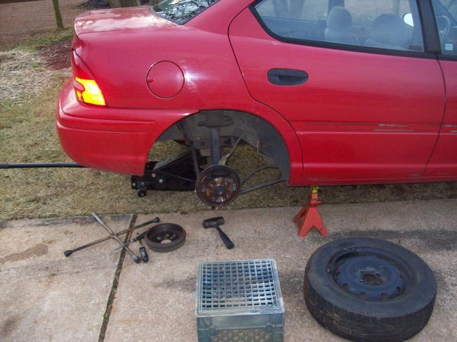

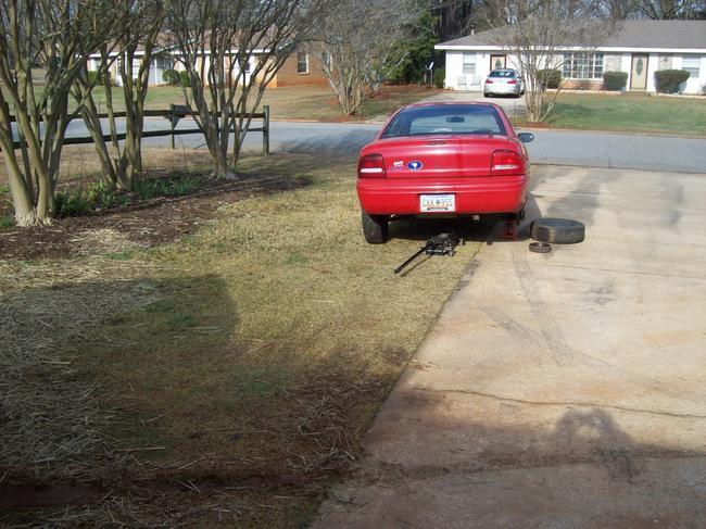

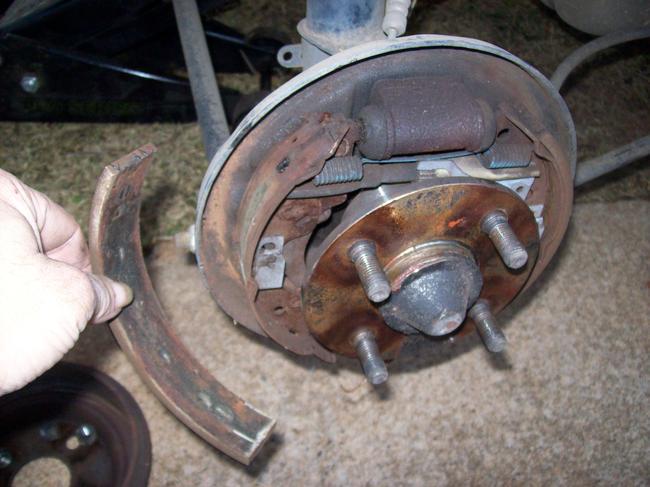

WOW!
LOOKY HERE!
SAME WHEEL!
OUR SPARE CAR IS A '95
IF THESE ARE GLUED ON LININGS
MAYBE ONE OF THE LININGS COME UNGLUED
NOW IT'S WEDGED IN THE ASSEMBLY SOMEHOW
SEE THE PICS OF OUR SPARE CAR (DODGE NEON)
I JUMPED IN TO GO, AND IT WAS DRAGGING A TIRE
SEE MY LINING?

SHOLLORAN
I figured out what mine was! It was the break pads! They were the original set and the pad part just completely fell off as soon as we got the drum off (which took forever since the breaks were locked)
Jan 3, 2017 at 12:15 PM (Merged)
SHOLLORAN
Exactly what happened to your brake pads is exactly what happened to mine!
