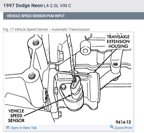

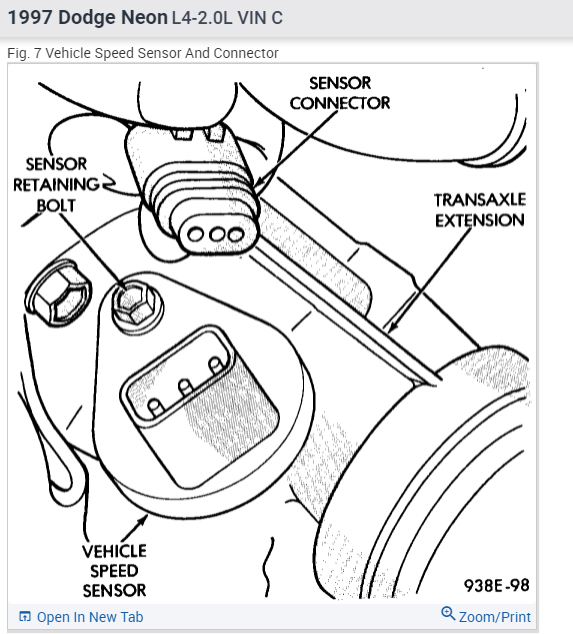

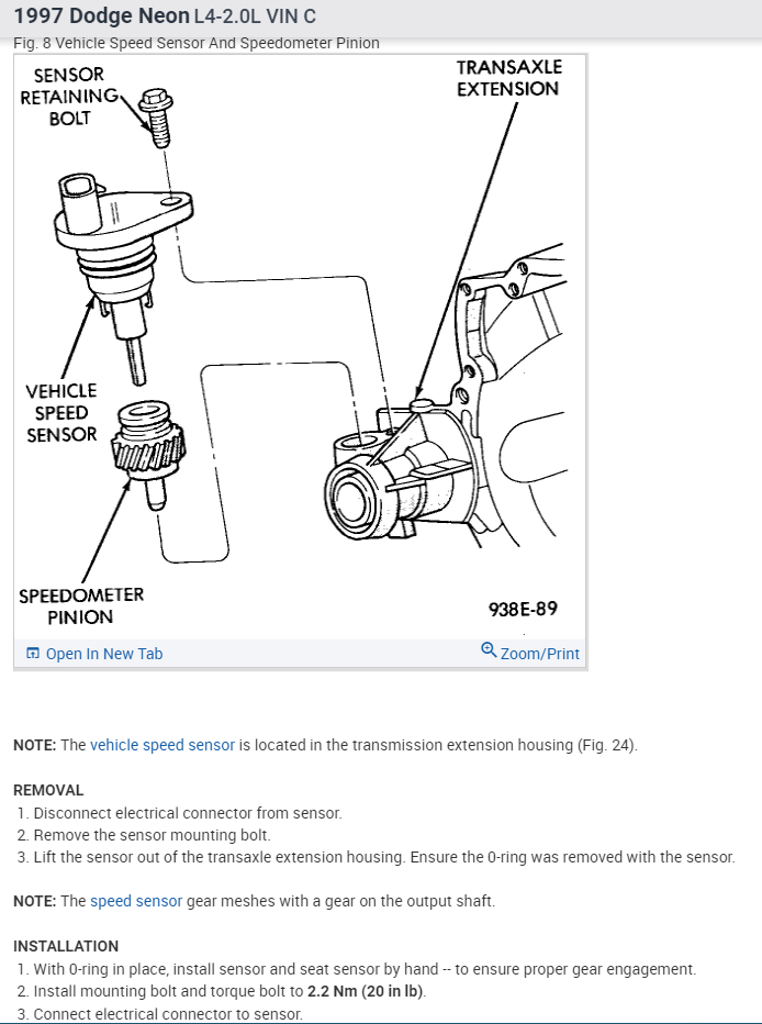

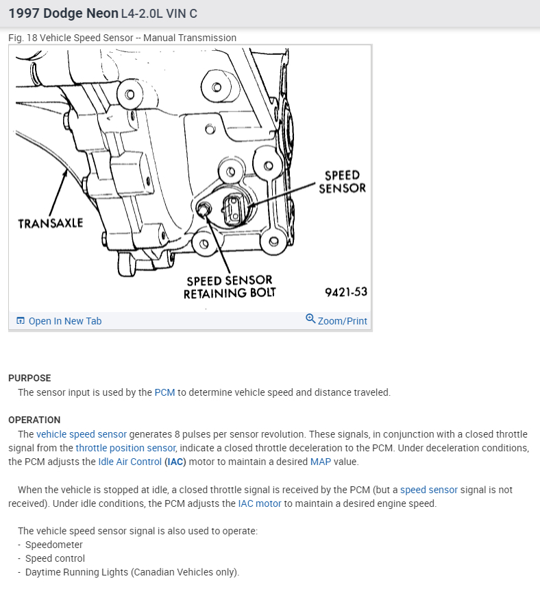

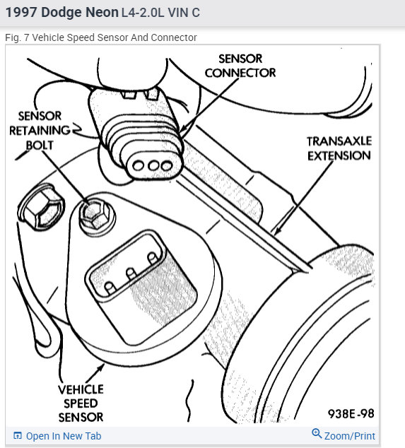

Inoperative speedometer can be due to a faulty vehicle speed sensor (VSS).
The VSS is located on the transaxle.
I have attached the diagrams below for your reference.
Thank you.
