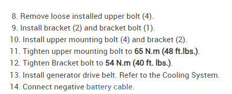

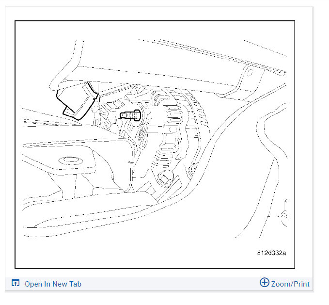

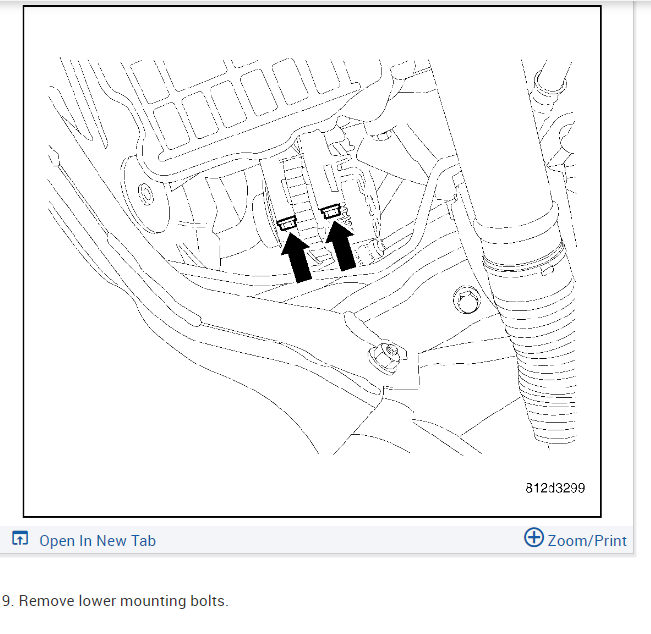

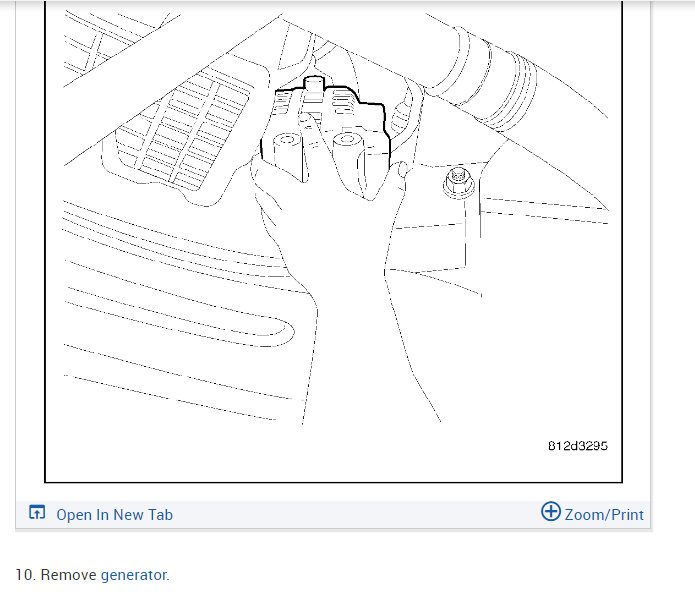

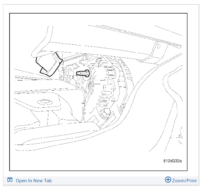

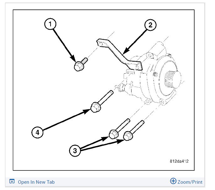

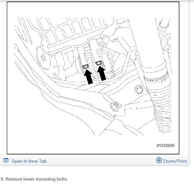

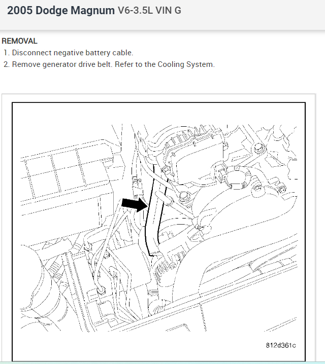

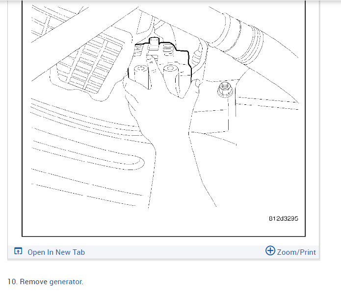

This happens when the ground from the chassis to the battery is gone or damaged so I would check that first. Also, clean the battery cables this guide can help. If everything seems okay I would get a alternator, here is how.
