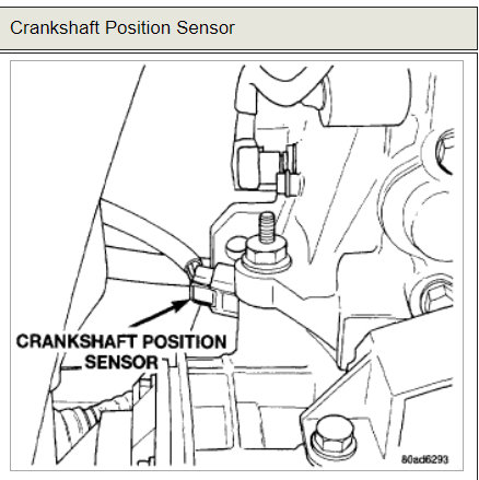

This sounds like you have a crankshaft angle sensor going out but to start we should scan the car for codes.
Even if the crankshaft sensor is going out it may not set the code. Here is a guide to help you see what you are in for when changing the sensor out.
This is what it will be like for your car

So then I did what you said and just replaced the sensor I have not had a problem since. Time will tell. Thanks for your help I will get back to you if I have any more troubles.
