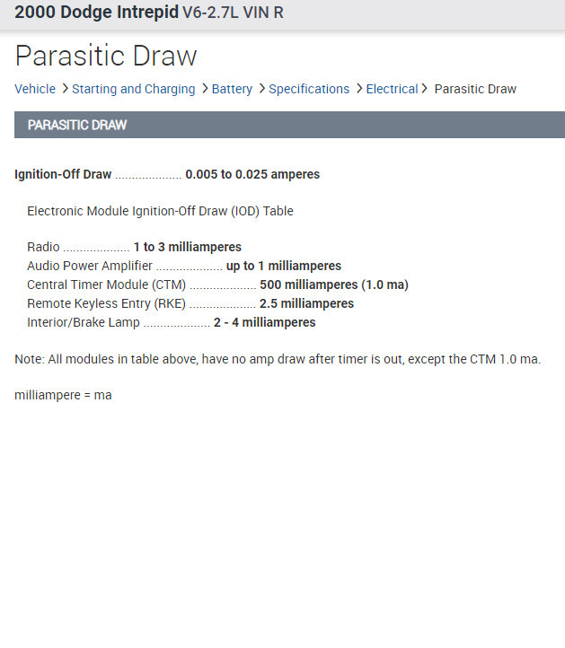

If you only need the jump after the car sits overnight, then you might have a parasitic draw in the electrical system. A parasitic draw refer to a drain in your electrical system caused by a faulty electrical component. Like a dome light staying on overnight or a faulty window switch that draws power all the time.
There is a simple way to test for parasitic draw.
You might find this article helpful:
https://www.2carpros.com/articles/car-battery-dead-overnight
