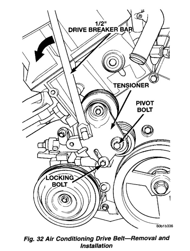

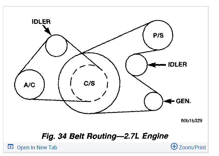

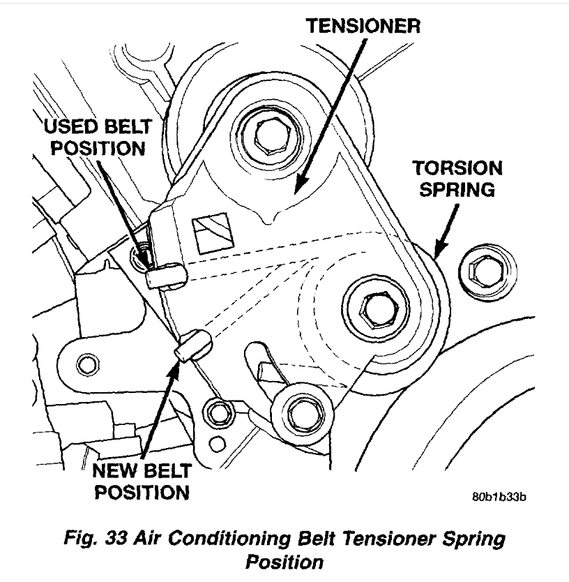

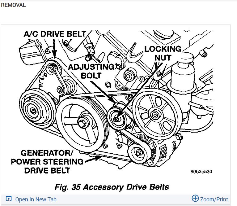

It sounds like you have a belt tensioner bearing going out, I would remove eh belts and spin the pulleys to see which one makes noise, here is how to change the belt tensioner out in case I am correct. Check out the images (below). Let us know how it goes
