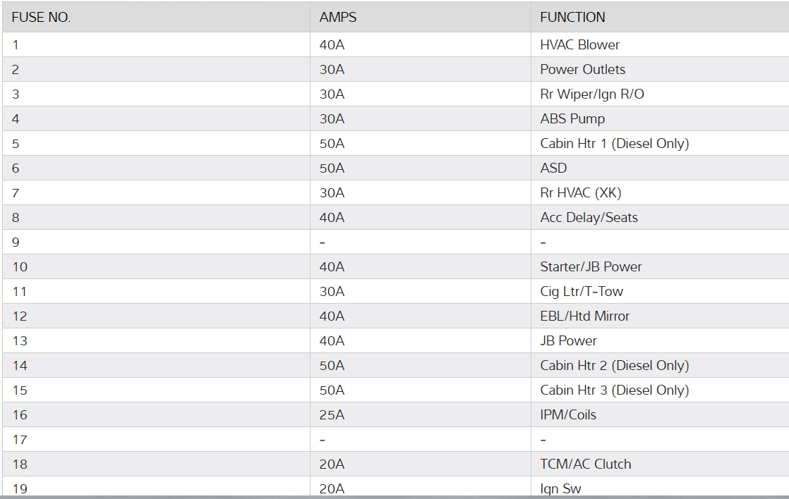

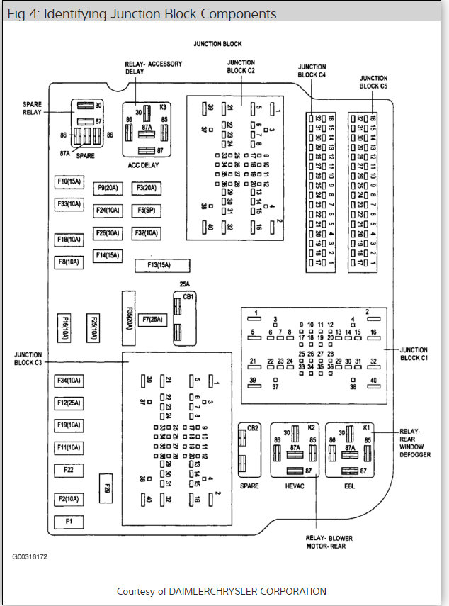

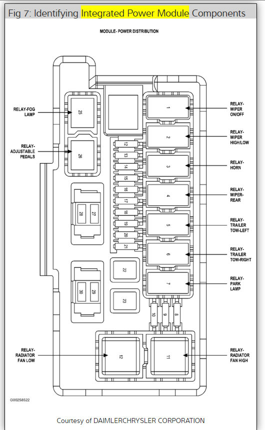

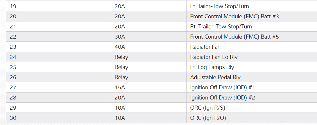

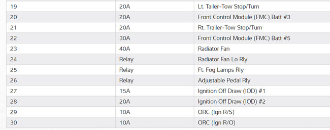

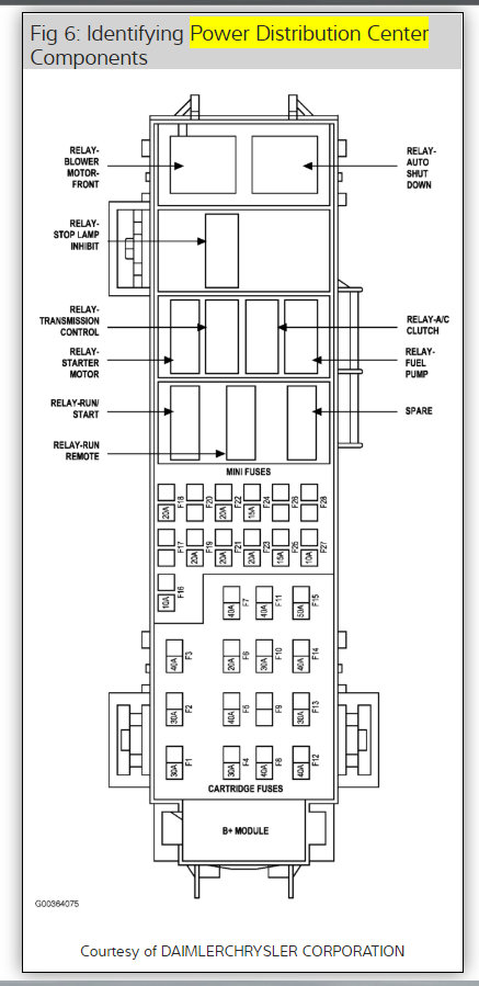

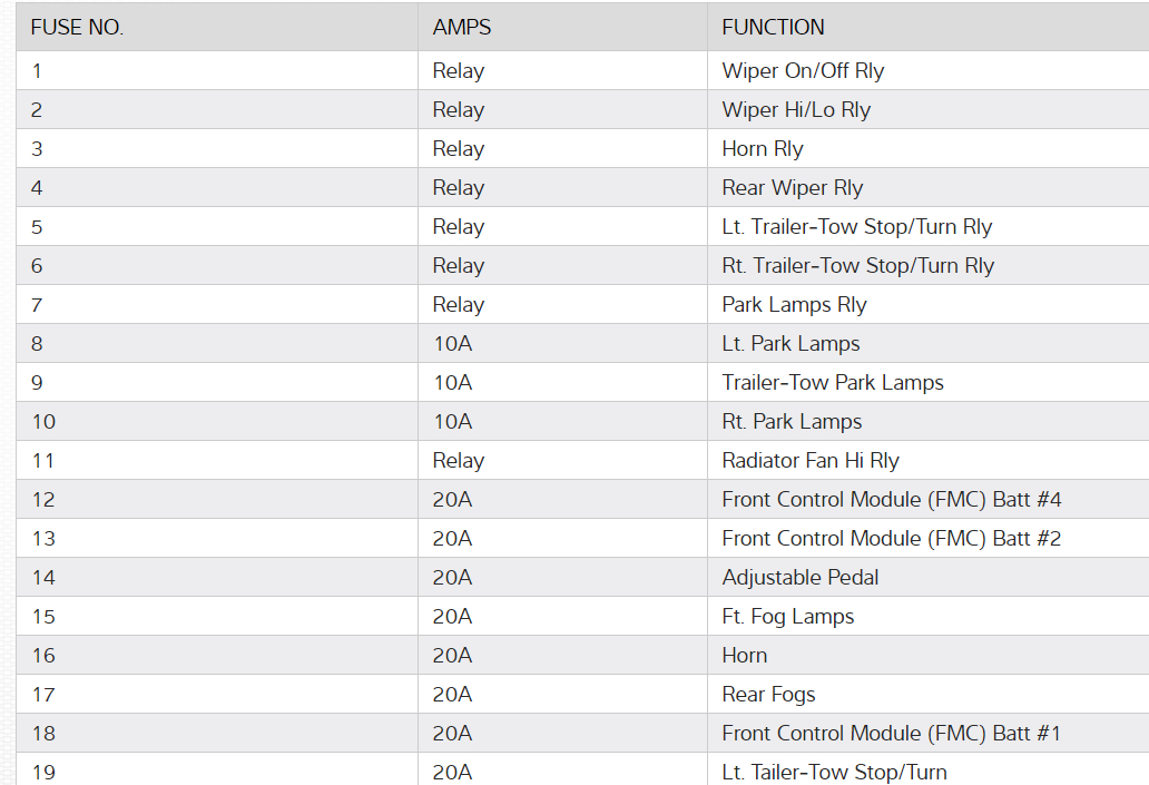

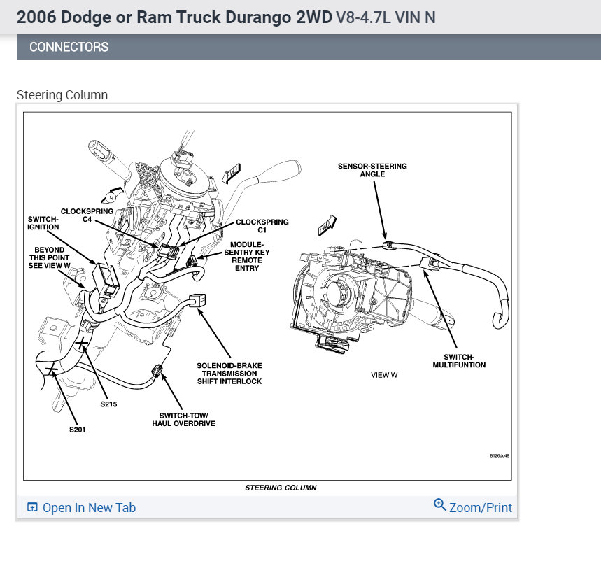

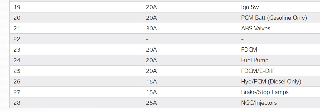

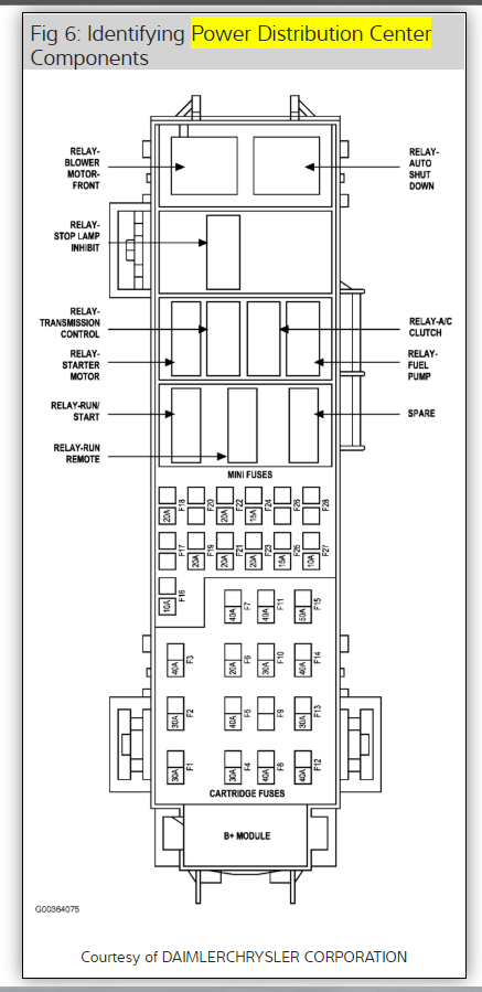

check if you have brake light when stepped on brake pedal? check fuses , check brake light switch and its connector. If all okay the interlock solenoid is out here are the fuse locations and the interlock solenoid replacement instructions in the diagrams below.
Check out the diagrams (Below). Please let us know what you find. We are interested to see what it is.
