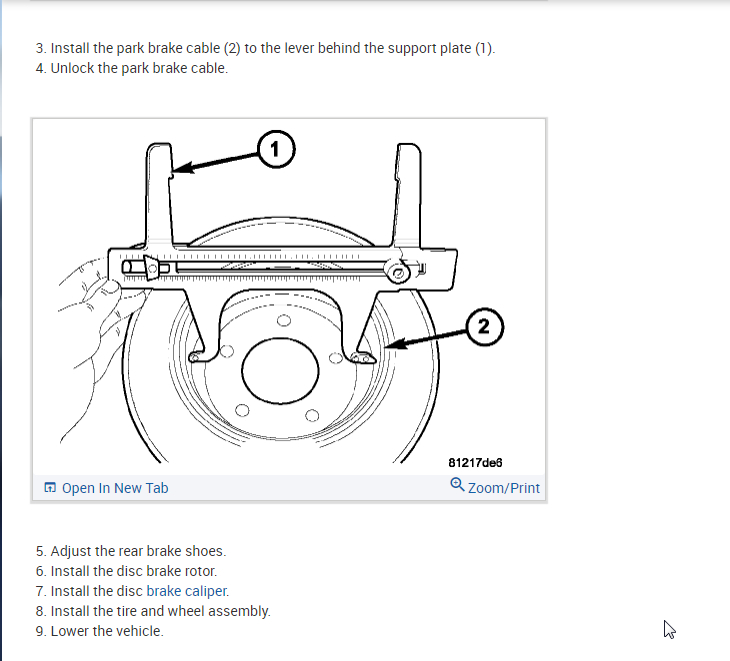

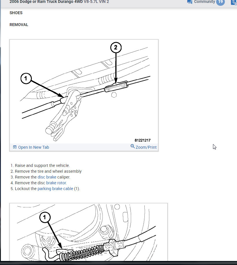

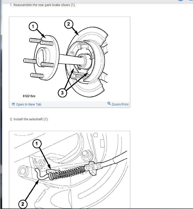

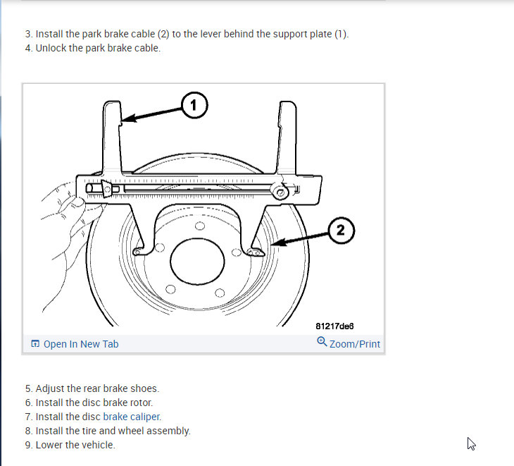

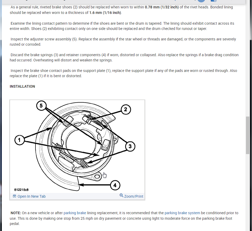

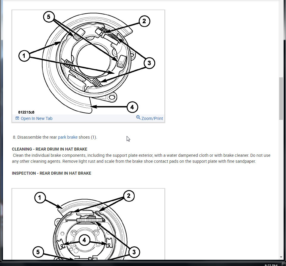

I am attaching the process out of the manual for your review.
Also, here is a guide that will give more detail on how to change these out:
https://www.2carpros.com/articles/how-to-replace-rear-brake-shoes-and-drums
Also, here is a video on how to replace brake shoes:
https://www.youtube.com/watch?v=3W0fs6shT3o
Let us know if you need more info. Thanks
