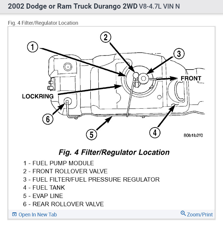

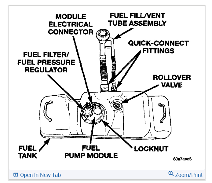

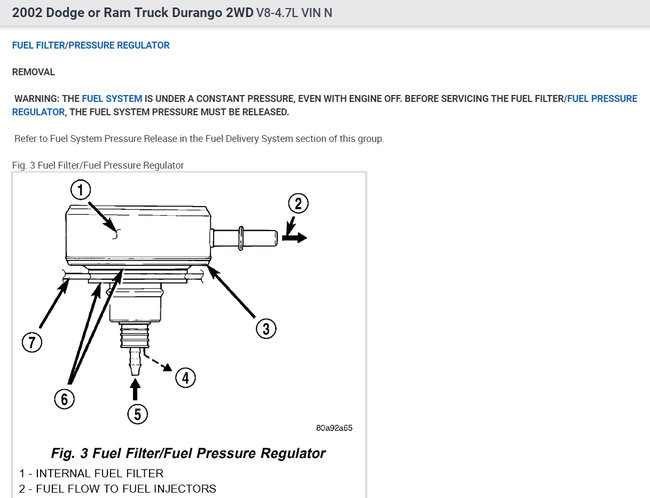

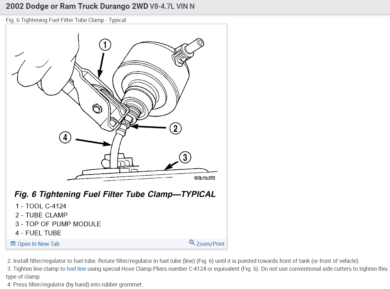

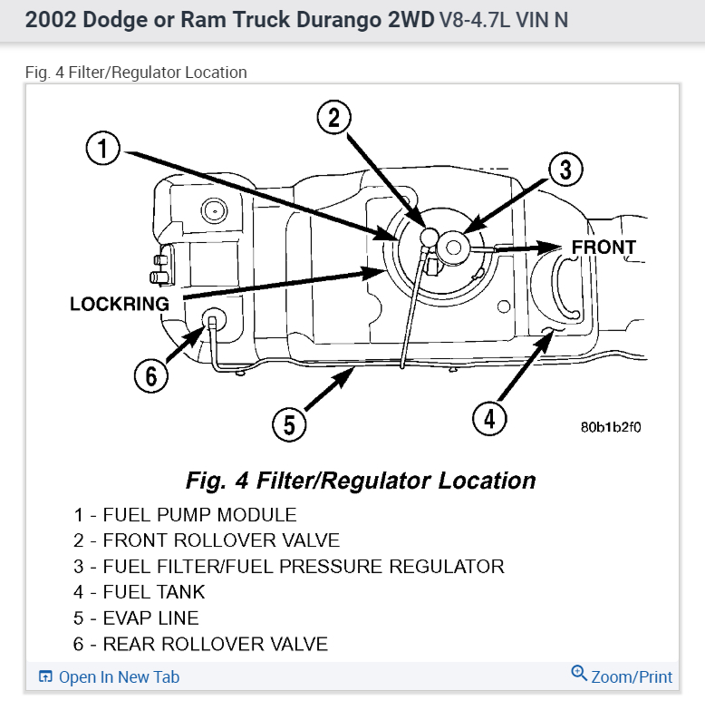

The fuel filter is part of the fuel pressure regulator on top of the tank here are diagrams below to show you how to change it and its location. Check out the diagrams (Below). Please let us know if you need anything else to get the problem fixed.

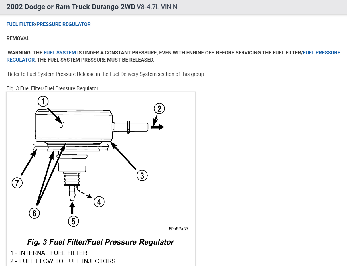

The fuel filter/fuel pressure regulator (Fig. 3) is located at top of fuel pump module on top of fuel tank (Fig. 4).
Fuel pump module removal is not necessary for filter/regulator removal.
Drain fuel tank and remove tank. Refer to Fuel Tank Removal/Installation.
Clean area around filter/regulator to prevent contaminants from entering pump module.

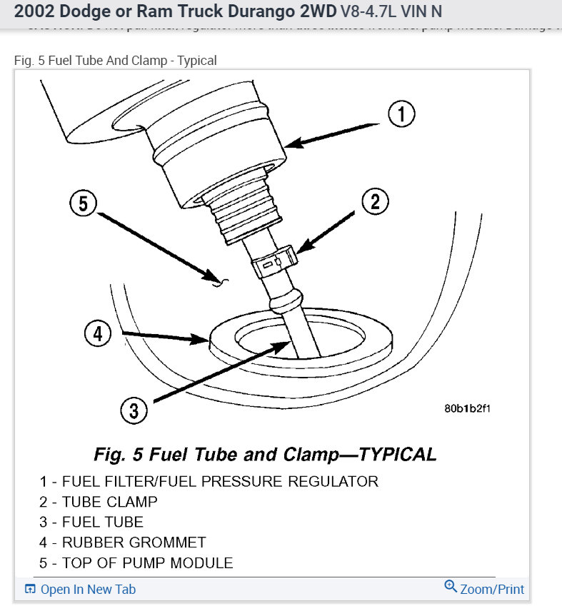

The fuel filter/regulator is pressed into a rubber grommet. Remove by twisting and pulling straight up. CAUTION: Do not pull filter/regulator more than three inches from fuel pump module. Damage to coiled fuel tube (line) may result.
Fig. 5 Fuel Tube And Clamp - Typical
Gently cut old fuel tube (line) clamp (Fig. 5) taking care not to damage plastic fuel tube. Remove and discard old fuel tube clamp.
Remove plastic fuel tube from filter/regulator by gently pulling downward. Remove filter/regulator from fuel pump module.

Fuel filter/fuel pressure regulator is mounted on top of the fuel pump module, located on the top of the fuel tank. No periodic service is required. The fuel filter/fuel regulator should only be replaced if it is clogged or if a diagnostic procedure indicates it is time to do so. No separate frame mounted filter is used.
If you still need to replace the filter/regulator assembly, below are the procedures to do so..

The fuel pressure filter/regulator assembly is located on the top of the fuel pump assembly. It is not necessary to remove the fuel pump to remove the pressure filter/regulator assembly. Matchmark the direction the hose fitting points. Unit must be reinstalled pointing in the same direction.
Twist the filter/regulator assembly out of its grommet on the fuel pump.

Install a new clamp over the plastic fuel tube.
Install the filter/regulator assembly to the fuel tube. Rotate the filter/regulator until it is pointed to line up with the matchmark previously made.

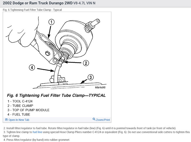

Tighten the clamp to fuel line using Hose Clamp Pliers C-4124 or equivalent.

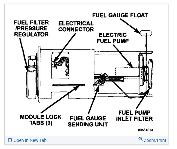

A combination fuel filter and fuel pressure regulator is used on all engines. It is located on the top of the fuel pump module and requires that the fuel tank be removed to access.
