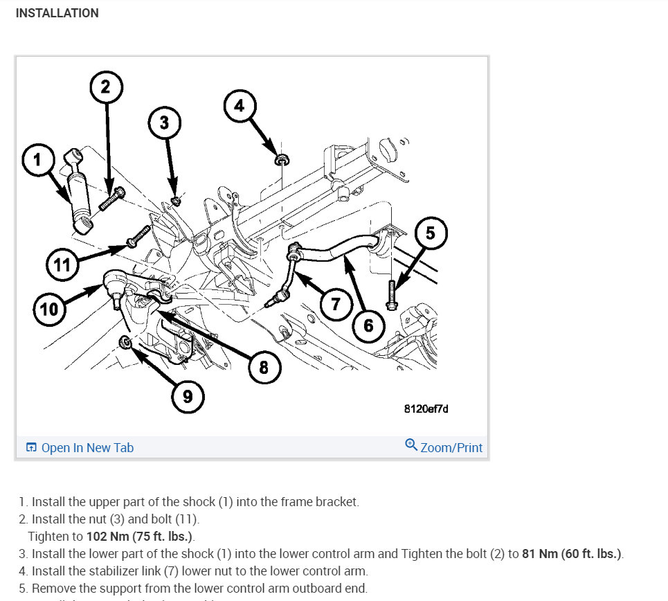

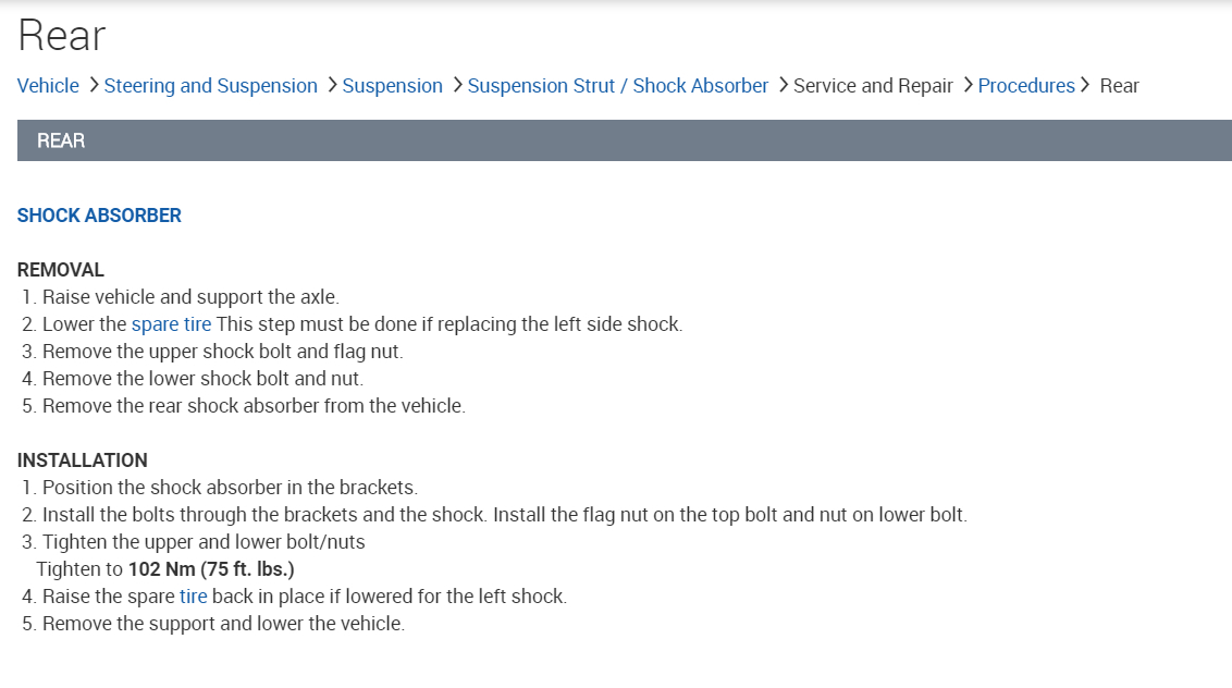

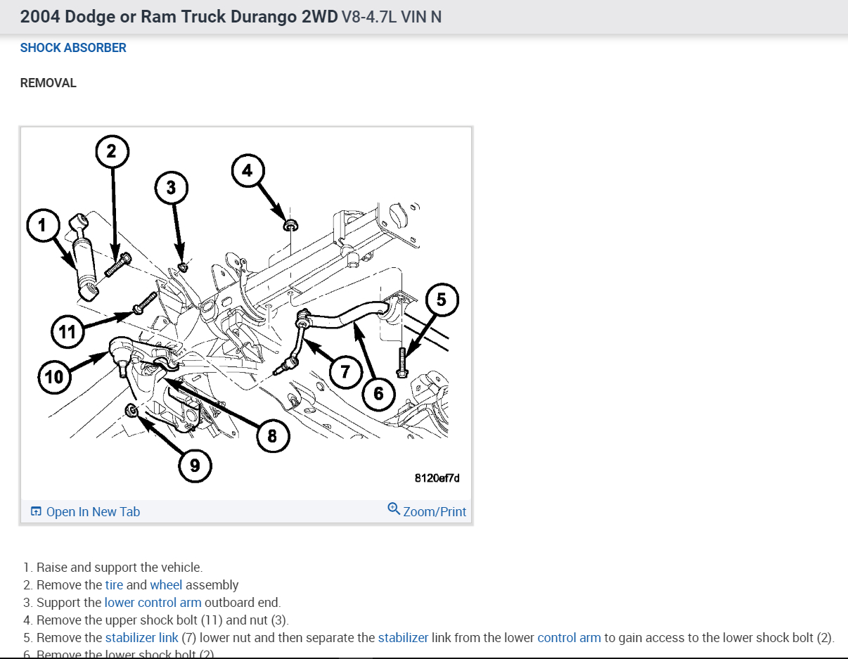

to replace the front and rear shock absorbers , are any special tools needed? what parts should be removed to access the front shocks for replacement? which shocks are recommended? Are any other accessories recommended to stabilize the suspension? thanks for the help........Alan
Apr 30, 2009 at 9:02 AM
No special tools are needed. I believe you have regular shocks all the way around and no struts. As far as brand of shock, I'm not allowed to recommend brands on here. Just stay with a brand name and I do recommend a gas shock and not oil filled. Here is a guide to help you step by step with diagrams below to show you how on your car.
