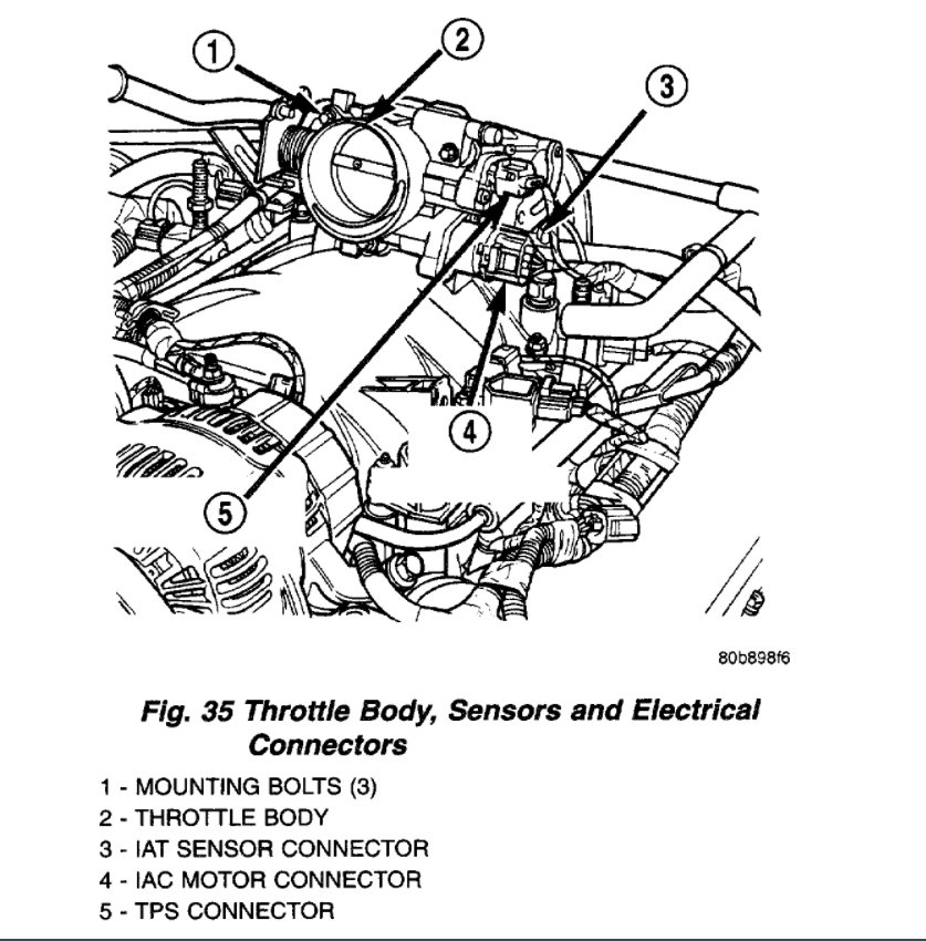

DANNY L
  • 5,648 POSTS
Hello, I'm Danny.
It sounds like you might be having an issue with the idle air control motor.Here is a tutorial showing what is involved:
https://www.2carpros.com/articles/how-to-replace-an-idle-speed-control-motor-iac
https://www.2carpros.com/articles/idle-air-control-valve-service
I've attached a picture below of its location on your Durango. Hope this helps and thanks for using 2CarPros.
Oct 16, 2020 at 11:42 AM (Merged)
This car does not have an IAC so the throttle body must be dirty and need service or you have a vacuum leak. these guides will help us fix it:
