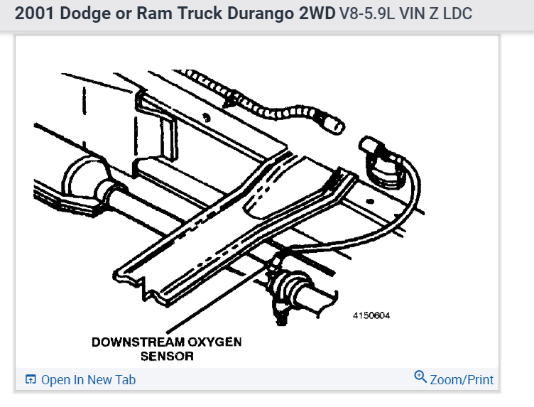

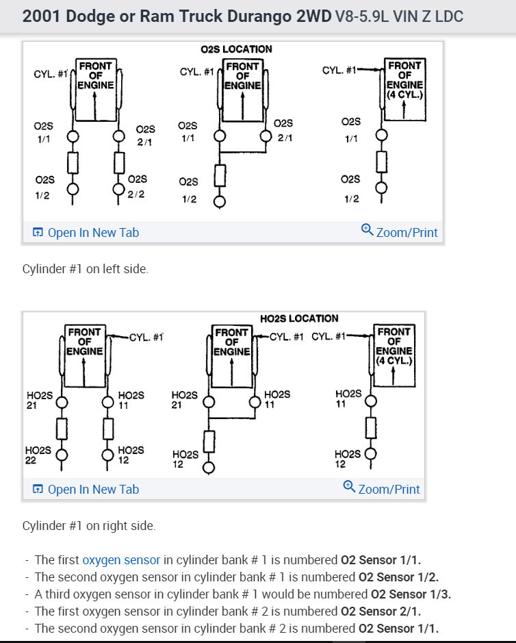

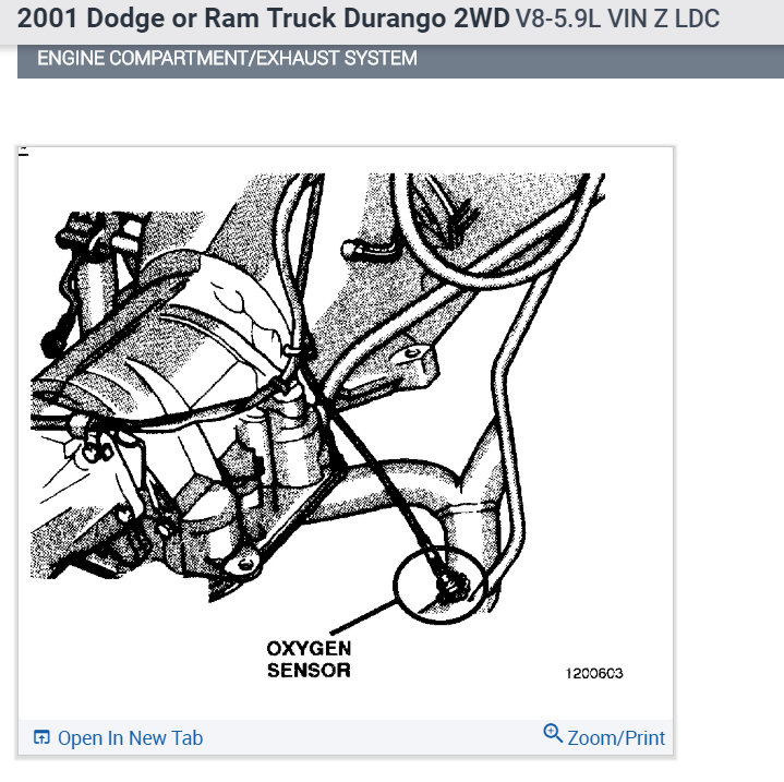

Where is bank 2 sensor 1 o2 sensor on a 01 durango 5.9L?
Jul 25, 2009 at 1:16 PM
Here is a guide to help walk you through the steps with the locations in the instructions and diagrams below.
https://www.2carpros.com/articles/how-to-replace-an-oxygen-sensor
diagrams below:
The upstream sensor (1/1) is located just before the main catalytic convertor.
The downstream sensor (1/2) is located just after the main catalytic convertor.
The right upstream sensor (2/1) is located in the right exhaust downpipe just before the mini-catalytic convertor.
The left upstream sensor (1/1) is located in the left exhaust downpipe just before the mini-catalytic convertor.
The right downstream sensor (2/2) is located in the right exhaust downpipe just after the mini-catalytic convertor, and before the main catalytic convertor.
The left downstream sensor (1/2) is located in the left exhaust downpipe just after the mini-catalytic convertor, and before the main catalytic convertor.

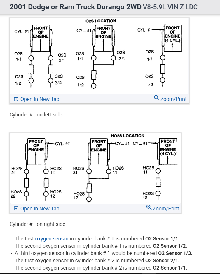

Depends on the exhaust system sometimes...but you should have 4.
Bank 1 sensor 1
means the first sensor on the side with cylinder number 1.....
For Dodges number 1 is on the driver's side.
So it is the one closest to the engine....the 1st one
on the driver side.
Should be a 7/8 maybe 13/16 size hex. It will be in there TIGHT.
