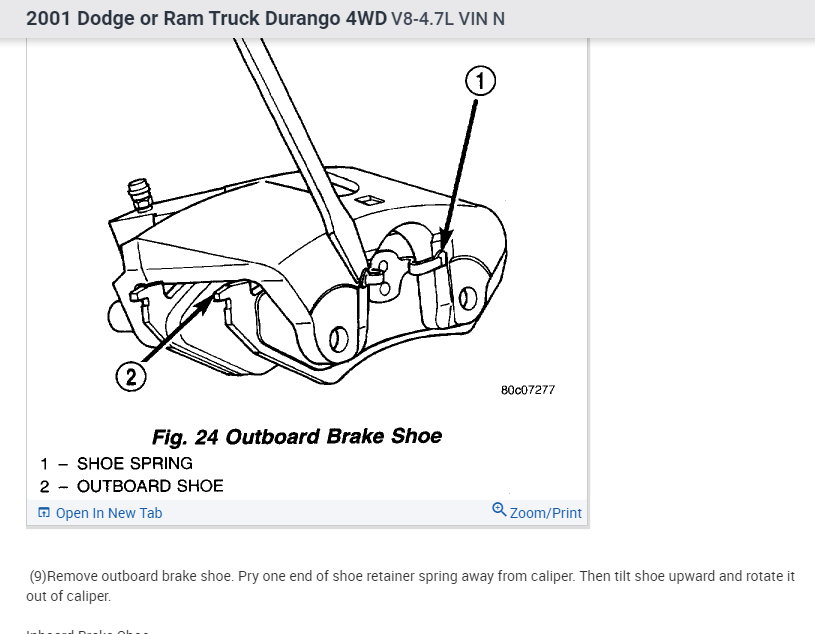

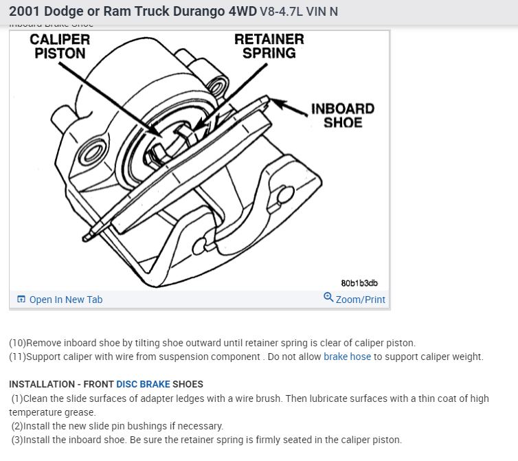

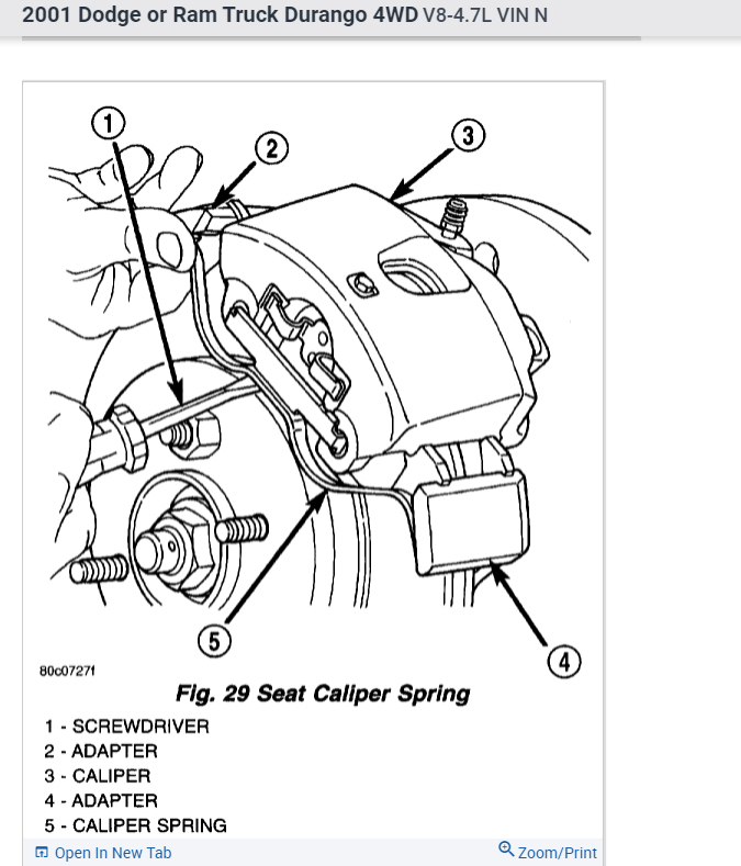

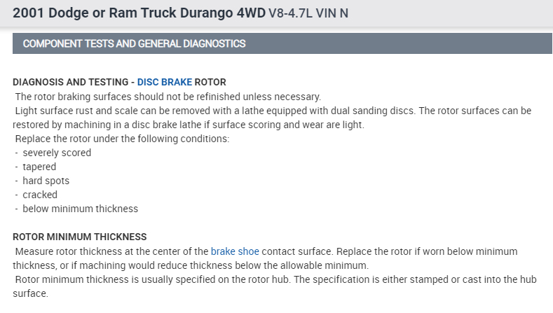

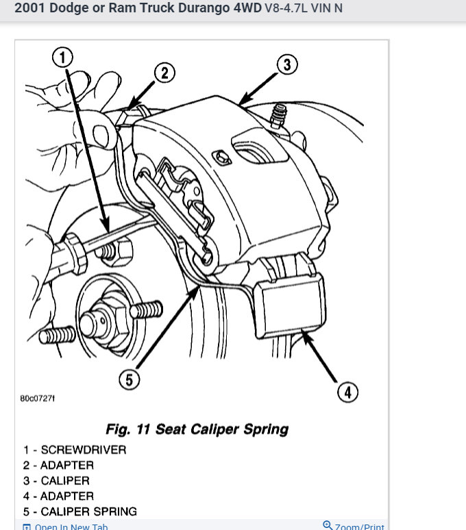

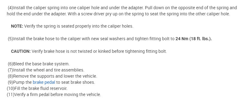

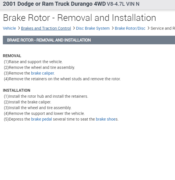

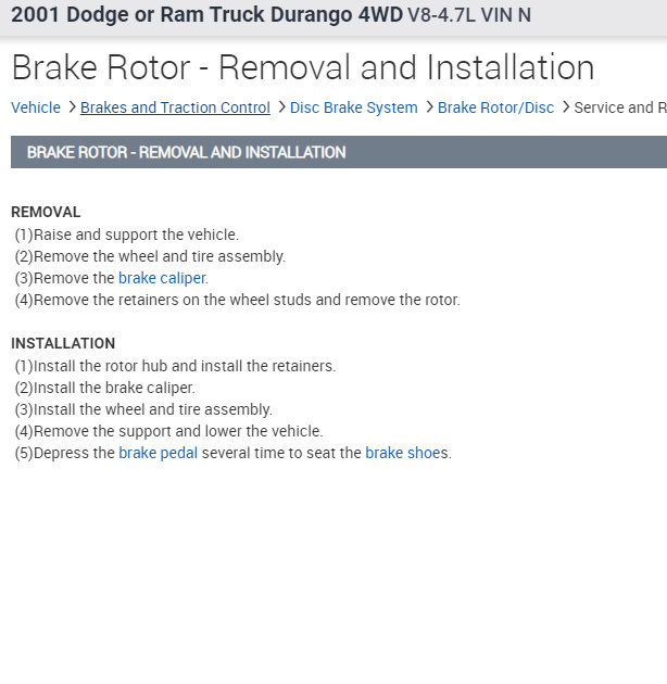

do I need any special tools to remove the front rotors on on my 2001 durango (all wheel drive) or is it just the lug nuts that hold it on. should I use a puller? What is the process?
Thanks!
