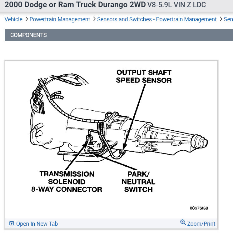

Where is the neutral safety switch located on the transmission. I understand that due to the bad neutral safety switch the Durango does not start when in Park and the gears slip. Thanks in advance

right where the shifter linkage is on the transmission. the thing that has a bunch of wires going to it. Check out the diagrams (Below). Please let us know if you need anything else to get the problem fixed.
