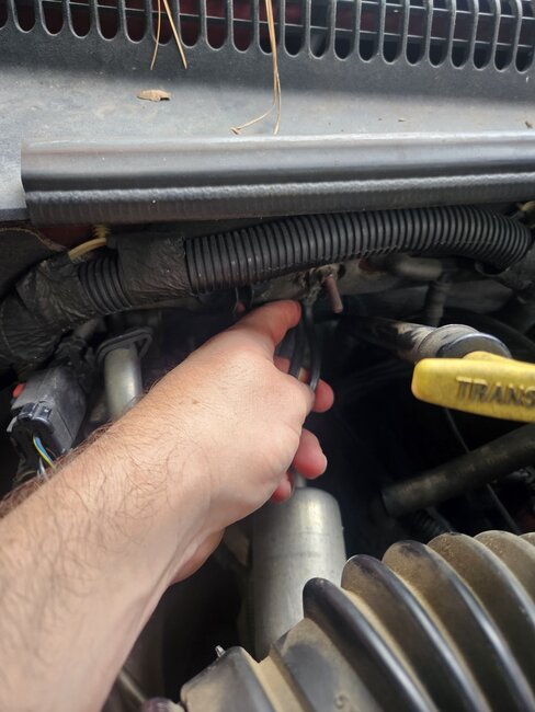

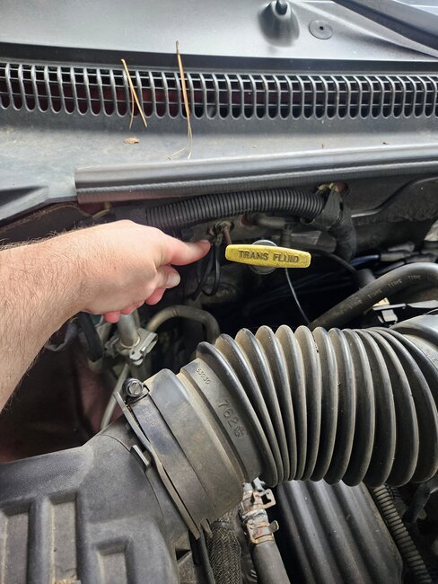

I have a 2000 dodge durango 5.9 l I just replaced battery and I got a new oil sensor changed it and now my security lights blinks, no power to the gauges or instrument panel. It turns over but does start. I have a clicking noise to the right of the dash which I assume is the anti theft computer. It doesn't make sense I cleaned all wires and everything was fine before I changed the sensor. I retraced my step and behind the transmission dip stick was a loose wire and thought to my self surely that couldn't be doing anything it was barley loose. Well after 4 days of looking and checking fuses. Today when I saw the loose wire I tightened it and my car started right up. I guess i move it will changing my oil sensor on the back side of the motor. I hope these pictures help someone.
Jul 5, 2023 at 9:07 AM
Yep, that looks like a main system ground, nice working finding out the problem, I sure it will help people with the same issue.
