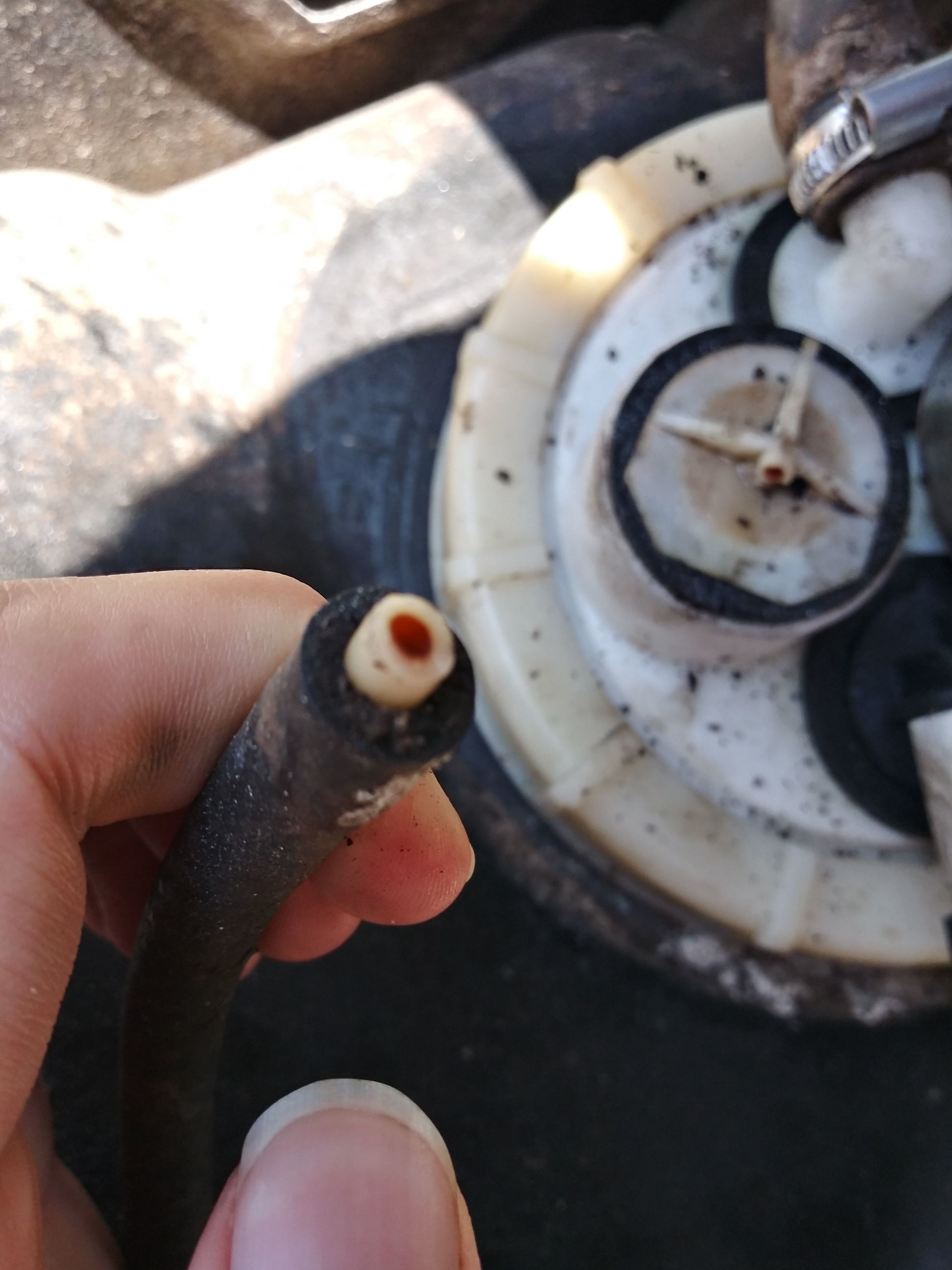

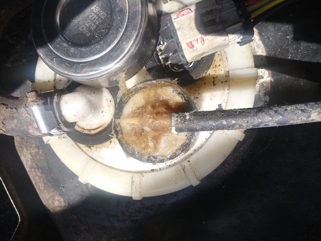

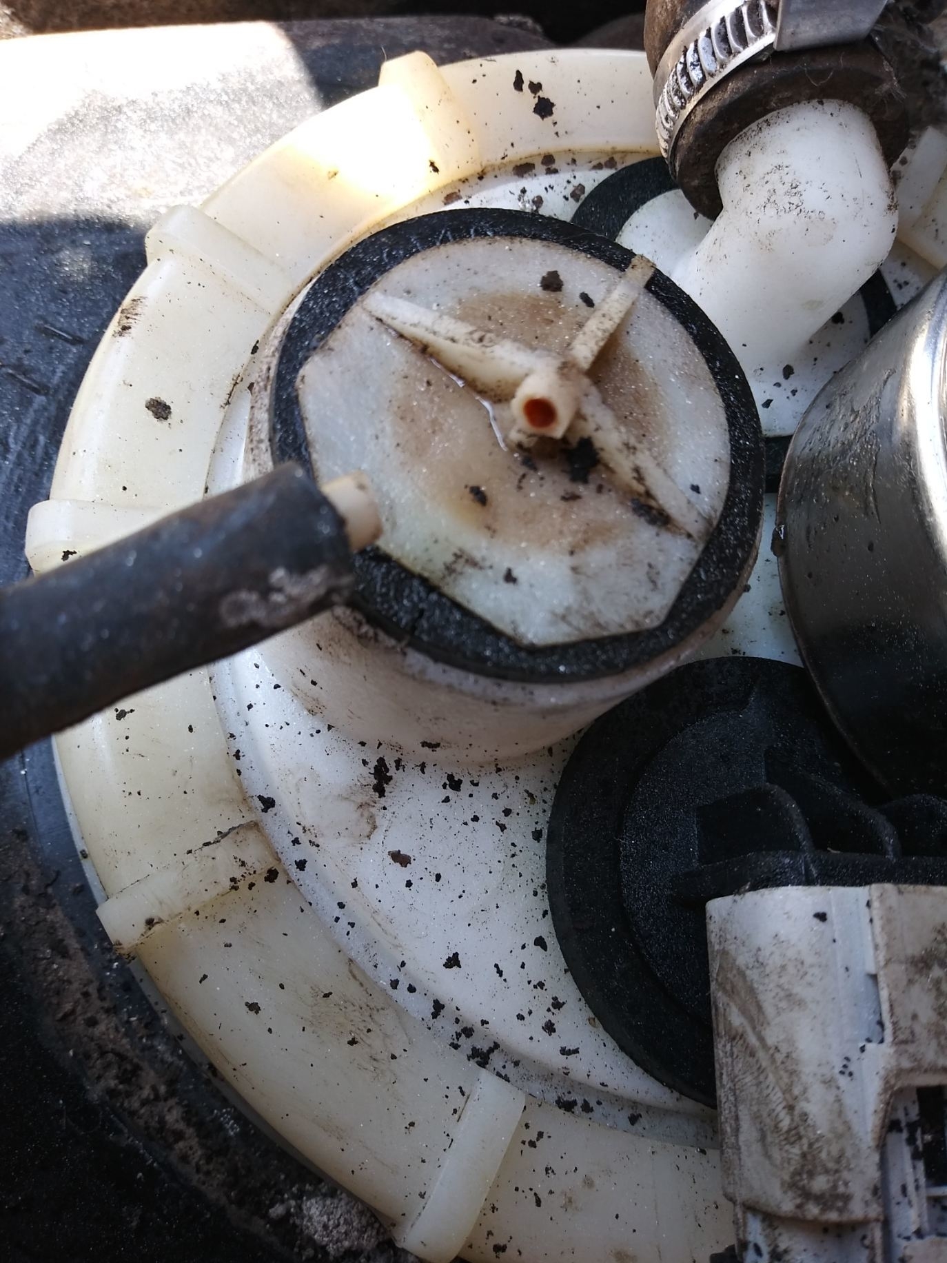

I recently replaced the fuel pump assembly and things were fine until horrible road conditions. Truck refused to start, no fuel pressure.
Anyway, the spout on the rollover valve had broken off in the pressure tube, too close to the valve to rig it. I'm trying to find a compatible substitute because nobody makes it and the local car cannibal lot has nothing.

Yes, you're in a tough spot.Dodge can't provide a part number due to being discontinued. Dorman doesn't make one either. Junk yards are you best bet be it looks like you didn't have luck.You might want to try some type of heavy duty epoxy or PCV type glue. You might want to use skinny needle nose pliers to remove the broken piece gently out of the hose and glue it back together until you find a replacement. Hope this helps and thanks for using 2CarPros.

Got the piece out but the stump on the valve housing is so short i've been defeated.

I have seen people drill out the plastic and install a small pipe thread fitting to attach the rubber hose to. Does that part come with a new fuel pump module? Check out the diagrams (below). Please let us know what happens.

I'm not sure which part is the module. I ended up reaming the plastic and inserting a 1/8" roll pin, fiber glassed the top together and put the hose back on. I was lucky to save the nipple part that broke off in the first place. It is not pretty but it worked.

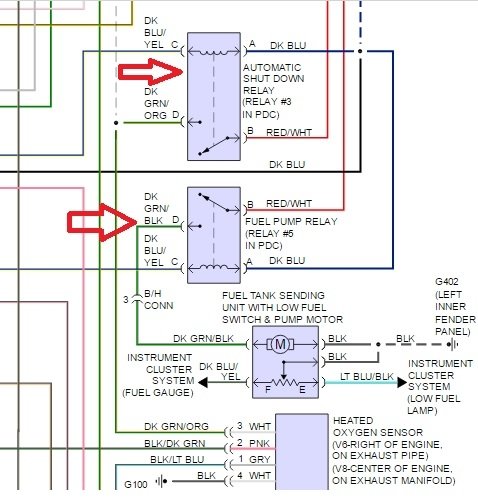

Check fuse C 40amp and fuse D 30 amp in the power distribution center-if okay test the fuel pump relay its relay no.5 in the PDC. and also relay no.3 for the ASD relay.

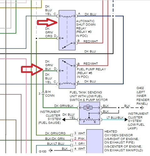

Here's what I came up with:
Check Fuse D (30A) and Fuse C (40 A) in the power distribution center (PDC)
Also check these two relays in the "Prodemand" diagram I'm posting below.
Return with a grin!
The Medic
