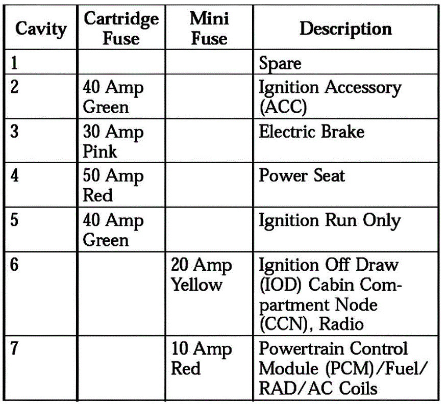

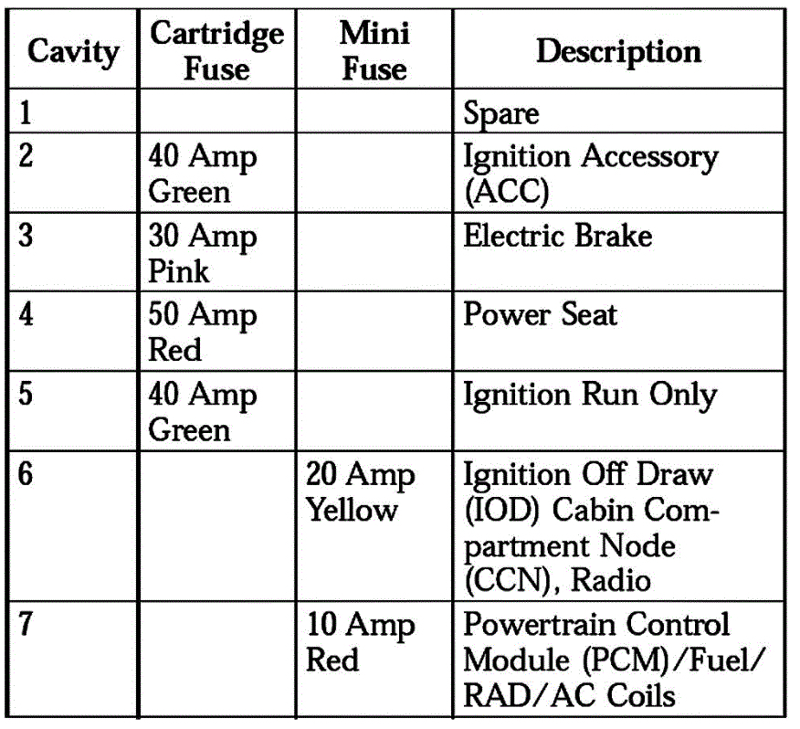

My tire pressure warning light is on. They say it is a fuse where are they and how do you test them?
Jan 23, 2010 at 12:53 PM

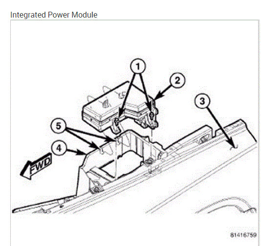

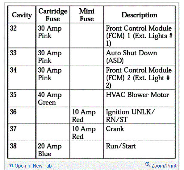

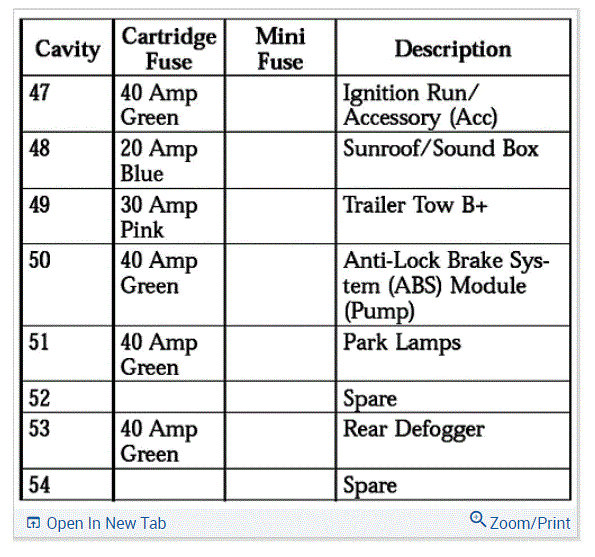

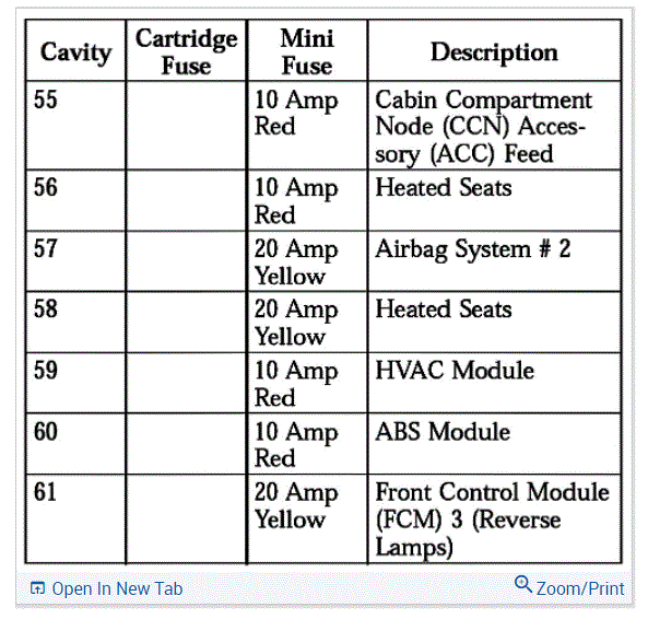

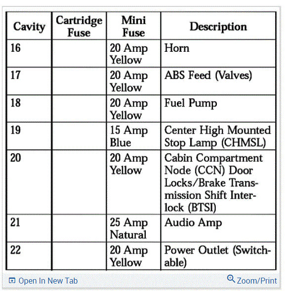

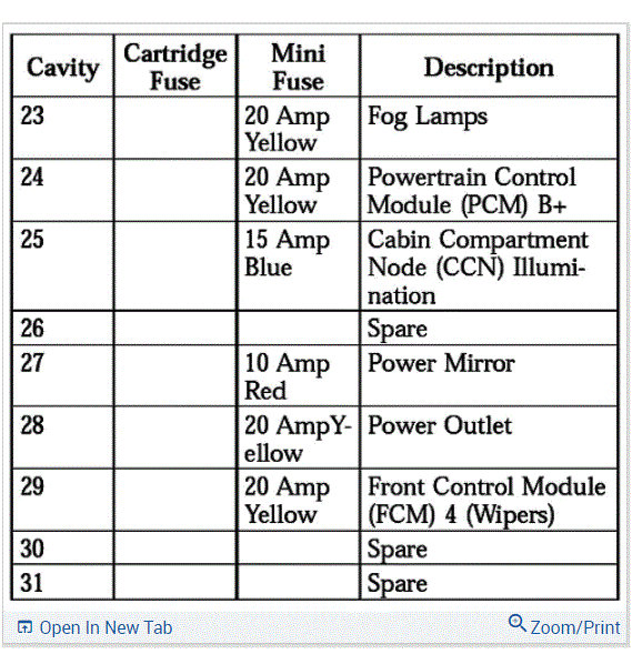

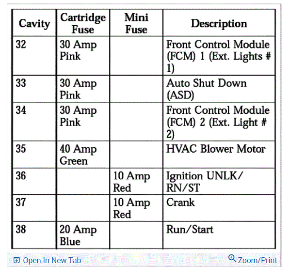

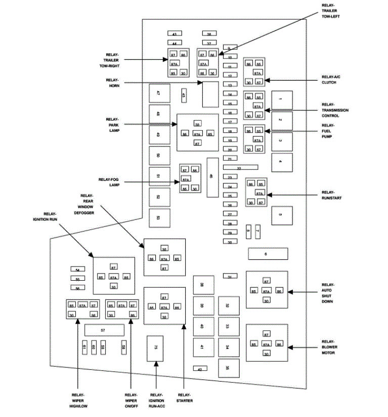

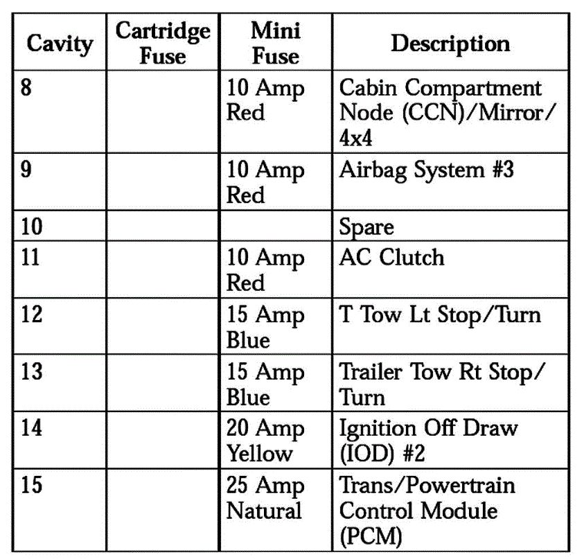

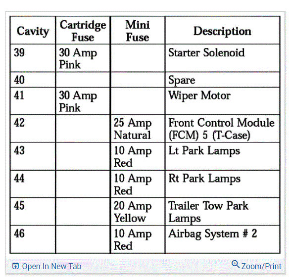

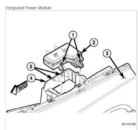

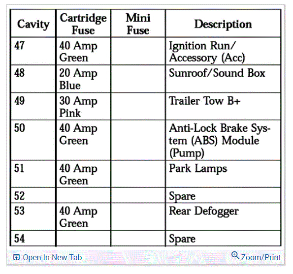

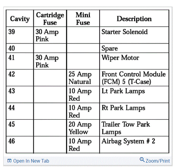

If you look at the attachments below, they provide the fuse box orientations and what each fuse is for.
In addition to just checking a fuse, make sure there is power to it. A fuse may be good and not be receiving power.
Here is a link that you may find helpful when testing:
I hope this helps. Let me know if you have additional questions.
See pics below.
