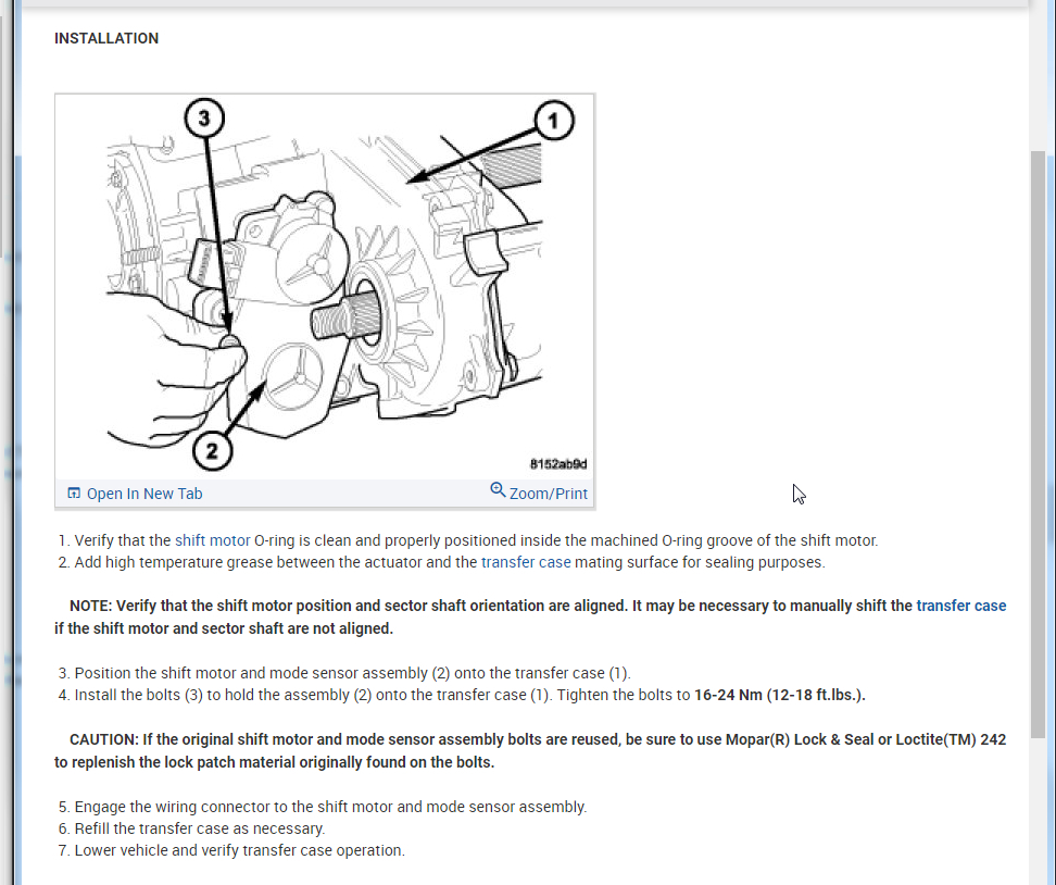

My transfer case is not working to change it to 4wd?
2007 DODGE DAKOTA
LARRY K
I noticed my truck will not go into four wheel drive can yo help me?
Apr 4, 2010 at 8:19 AM

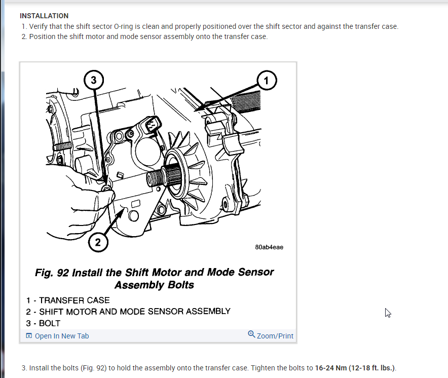

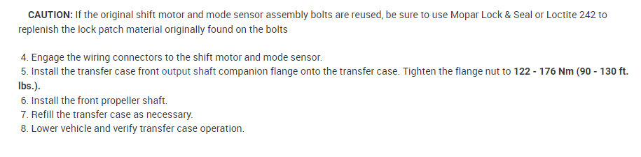

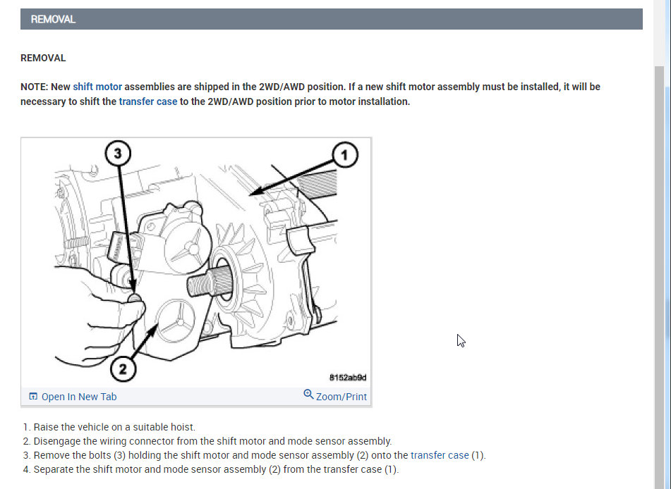

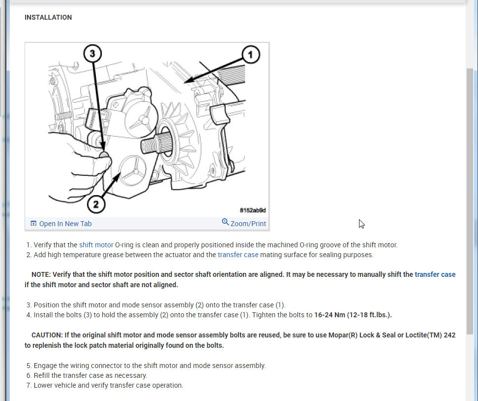

This is hard to know for sure but we need to start with listening to see if the actuator is trying to engage. If it is not then we need to check for power at the actuator and if there is power then the actuator needs to be replaced.
The most common cause of this is the actuator so I attached the process below on how to replace this. Please let us know if you have questions on this. Thanks
Apr 10, 2021 at 4:19 PM

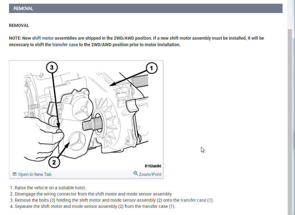

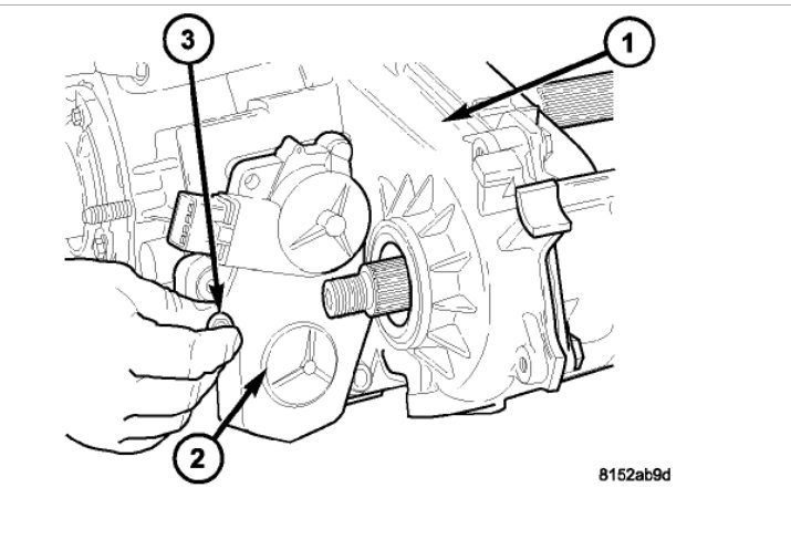

JOHNHICKMANSR
Four wheel drive service light on.
Apr 14, 2021 at 6:12 PM (Merged)

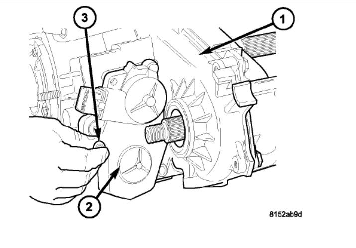

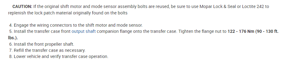

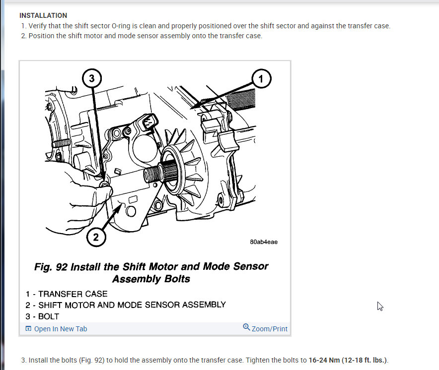

This happens when the transfer case shift actuator/sensor needs to be replaced. Here is how you fix the problem:
Note: New shift motor assemblies are shipped in the 2WD/AWD position. If a new shift motor assembly must be installed, it will be necessary to shift the transfer case to the 2WD/AWD position prior to motor installation.
Raise the vehicle on a suitable hoist.
Disengage the wiring connector from the shift motor and mode sensor assembly.
Remove the bolts (3) holding the shift motor and mode sensor assembly (2) onto the transfer case (1).
Separate the shift motor and mode sensor assembly (2) from the transfer case (1).

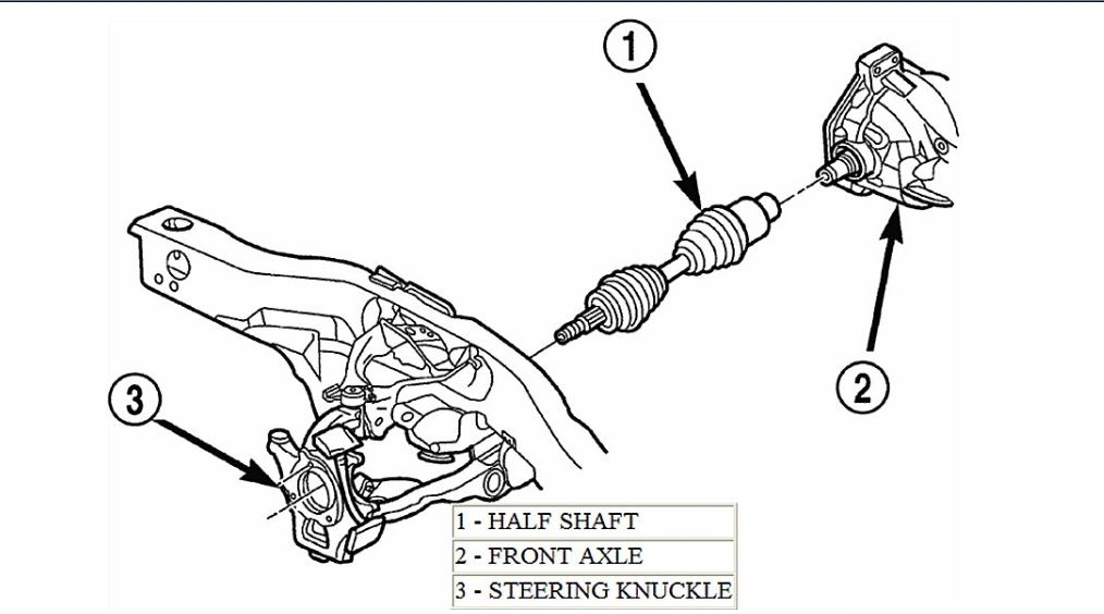

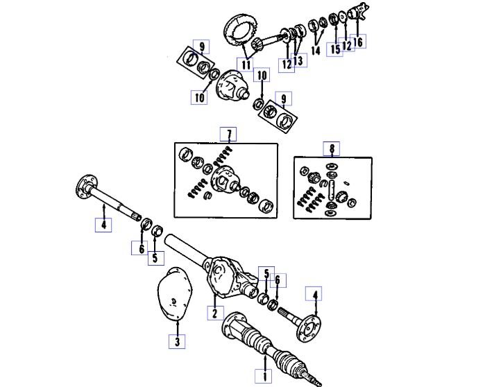

EDWARD HAND
Four wheel drive engages on driver side but not passenger side.
Apr 14, 2021 at 6:14 PM (Merged)
Good evening,
It sounds like one of the axles are not locking in.
Is there any damage to the axle? Is it turning?
C205F - Front Axle
DESCRIPTION
The C205F axle consists of an aluminum center section with an axle tube extending from one side. The tube is pressed into the differential housing. The power is transferred from the axle through two constant velocity (C/V) drive shafts to the wheel hubs. The drive shafts are identical and interchangeable.
The differential case is a one-piece design. The differential pinion mate shaft is retained with a rollpin. Differential bearing preload and ring gear backlash is adjusted by the use of select shims. The shims are located between the differential bearing cups and the axle housing. Pinion bearing preload is set and maintained by the use of a collapsible spacer. The differential cover provides a means for inspection and service.
The axle has the assembly date and gear ratio listed on a tag. The tag is attached to the housing cover by a cover bolt.
OPERATION
The axle receives power from the transfer case through the front propeller shaft. The front propeller shaft is connected to the pinion gear, which rotates the differential through the gear mesh with the ring gear bolted to the differential case. The engine power is transmitted to the axle shafts through the pinion mate and side gears. The side gears are splined to the axle shafts.
EDWARD HAND
No damage that I see it doesn't turn when engaged.
Okay, if it does not turn, then you have a defect inside the front differential.
It will have to be opened up to inspect for the failure.

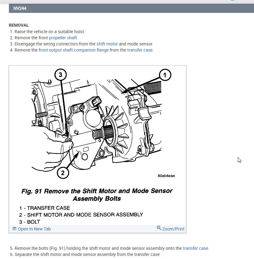

CORY T
four wheel drive will not engage, makes a grinding noise when driving.
Apr 14, 2021 at 6:16 PM (Merged)
More then likely this is due to the shift motor has failed. I attached the process below that will help replace this.
The fact that is it grinding shows that the motor is trying to shift which proves out all wiring and the switch which leaves the motor or the transfer case itself. Which is more likely to be the motor and not the case.
Below you will find the process on how to replace this shift motor.
Let me know if you have questions on this and we can go from there.

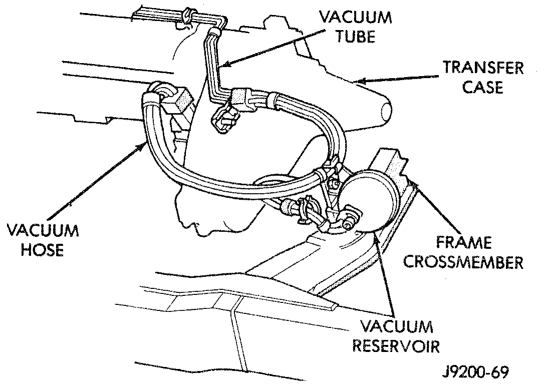

When I engage it into 4 wheel drive it feels like it goes in but it is not.
Apr 14, 2021 at 6:21 PM (Merged)
The system is actuated via engine vacuum. Do me a favor. Crawl under the vehicle and look up at the transfer case. Check for broken, disconnected, or dry rotted vacuum hoses.
Next, it has been some time, but I believe there is a vacuum reservoir under it as well. It will be black plastic and round. Check that as well.
Finally, the vacuum hoses run to the front axle. Check there as well.
I attached the only pic I could find related to the vacuum/4wd. It will help you locate the vacuum switch on the top of the transfer case. Keep in mind you have to make sure there is vacuum getting to the switch from the engine.
Take care and God Bless,
DAVE CAIN
It was a vacuum hose that had cracks in it and I want to thank you for your information.
